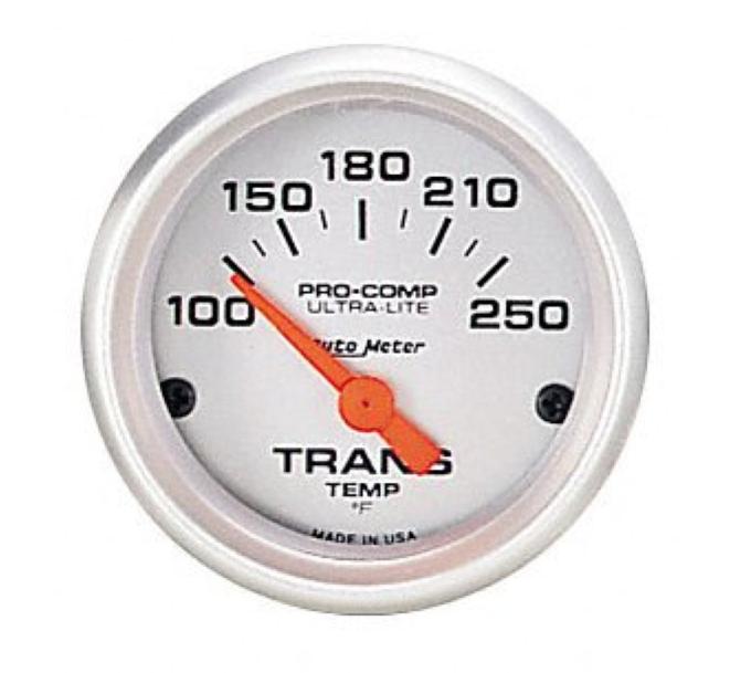

Auto Meter 4357 Ultra-Lite Electric Transmission Temperature Gauge
Amazon.com: Auto Meter 4357 Ultra-Lite Electric Transmission Temperature Gauge: Automotive

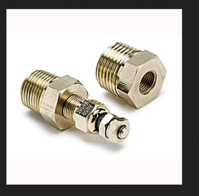

Here is what I got off the Auto Meter site.
"Short Sweep Electric Temp. Gauge Sender (250, 300, and 340 deg.)
1/8" NPT. Includes 3/8" NPT and 1/2" NPT adapter fittings. DIRECT REPLACEMENT FOR ALL CURRENT AUTO METER SHORT SWEEP ELECTRIC GAUGES. Not Compatible with Auto Gage products."
OH, and they have a shallow depth version if needed
http://www.autometer.com/cat_accessoriesdetail.aspx?vid=33
Ok, so you need a bung to screw that into. You can find a fitting or make one. The hardware store should have a T fitting with female NPT threads - stick the temp sensor in the side, and screw barbed fittings into the ends. Use some kind of oil and gas resistant thread sealer on the threads. Ziptie or screw-clamp that setup somewhere near the trans. Run the hose carrying fluid from the trans to the sensor assembly, and then out the other side to the cooler.

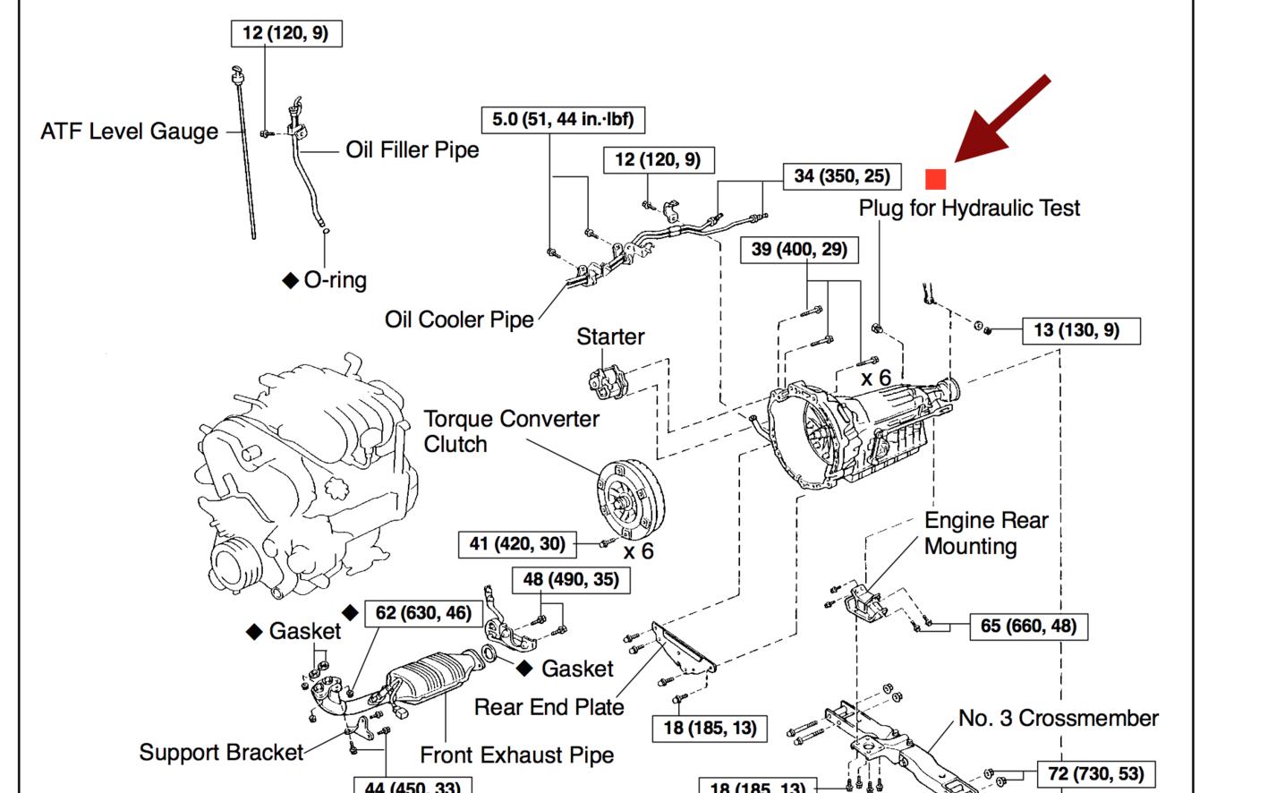

Yes, that would certainly work and I might go that way... I did see something about a Test Port on the T4R tranny... maybe I should rephrase.
Is there a test port?
Where is it?
How deep is it? Do I need the SHALLOW sensor?
Has anyone else used it with a sensor?
Thanks
Hmmm... there is a "Plug for Hydraulic Test"....
Looks like it's kinda at the top...
Trannies are full of fluid right? no matter where you put it... it should have fluid...
I could use the T adapter in the hose to the B&M Cooler. The only thing that gives me pause is... In my opinion the fewer hose clamps the better and that would introduce at least 2. It would be best to screw it right into the transmission.
Orrrrrrr.... am I bonkers?
