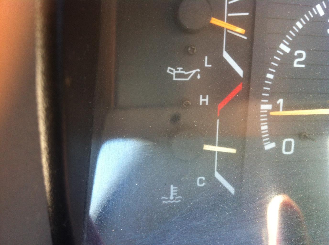

I have a 89 First Gen. V6 SR5 171K miles. It was overheating and mechanic replaced radiator with all related parts. I think the radiator is a larger one. This took care of the problem and it has never had an overheating problem since. 6 Months ago. (pic enclosed is a hot as the guage will ever get)

you could try swapping out the thermostat for a different temp one. the OD engages at 176 degrees so you need a 180 degree thermostat. if you have a 180 degree youll need to step up to a 195
Badvsion - does the temp gauge not getting to half way (per the pic) indicate that the truck is not getting up to the temperature it needs to? I'm going to check into the 195 degree thermostat. Any other ideas would be great. Thx

inferred temperature sensing guns work, hell even a grill thermometer works just stick it next to the coolant sensor on the thermostat housing when the truck is good and worm it will give a idea of what temp the coolant is and if its lower 165 at idle you may need 195.
but now that you say the highway i would recommend this trick, take a piece of thin aluminum about 2inches tall and fix it to the bottom outside(facing bumper) of the radiator this will keep the temp higher as it blocks a small portion of the wind while your cruising down the highway but wont effect your slow speed temp.
BV - So If I put the wind block on radiator and the OD stays on... Like it should. that would confirm that the cold air is dropping the temp to disable OD.
