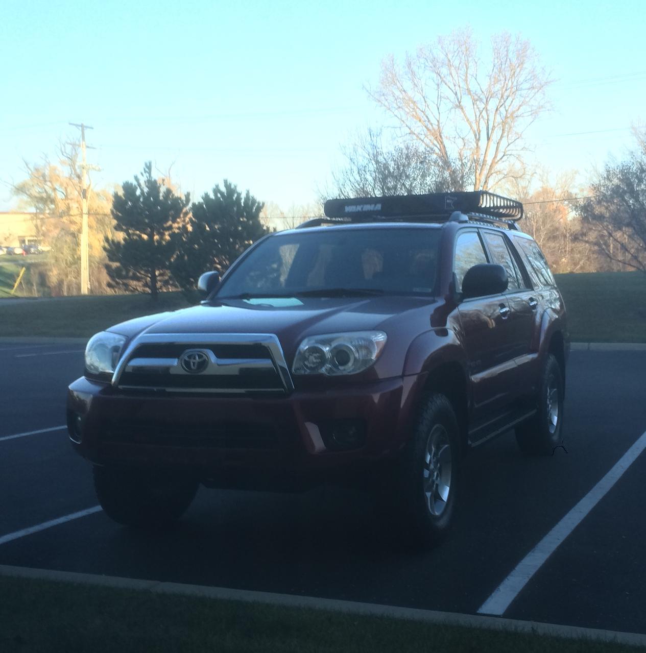

Pattern continued throughout the weekend as I came and went from my house, so I am certain it's the old sensors. Contrary to what was [MENTION=28616]SSt4r[/MENTION] said earlier, I think our CPUs can store more than 5 codes.
To ensure I properly tested what I thought to be the culprit, I brought the sensors into work today and parked right next to where I'll store them in my desk.
I'll monitor how this affects the behavior over the next couple days and call it a wrap if the light only illuminates when I get to work. With that said, it went on and off the entire ride in -- which is a symptom that hadn't yet occurred until now. I think I can safely say it's the sensors.
NET: If you replace your TPMS, throw out the old sensors or you'll risk having some really frustrating issues. Tire shops ought know to remove the codes from the CPU, but I don't think I would rely on that based on my experience.
