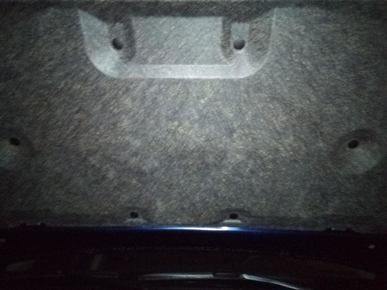

I’ve heard that before too but doesn’t seem to make a difference on mine. I also bought the insulation/liner that only came standard on the Limited back in the day.
Here's the hood insulation/ liner on my TRD ORP for comparison.
