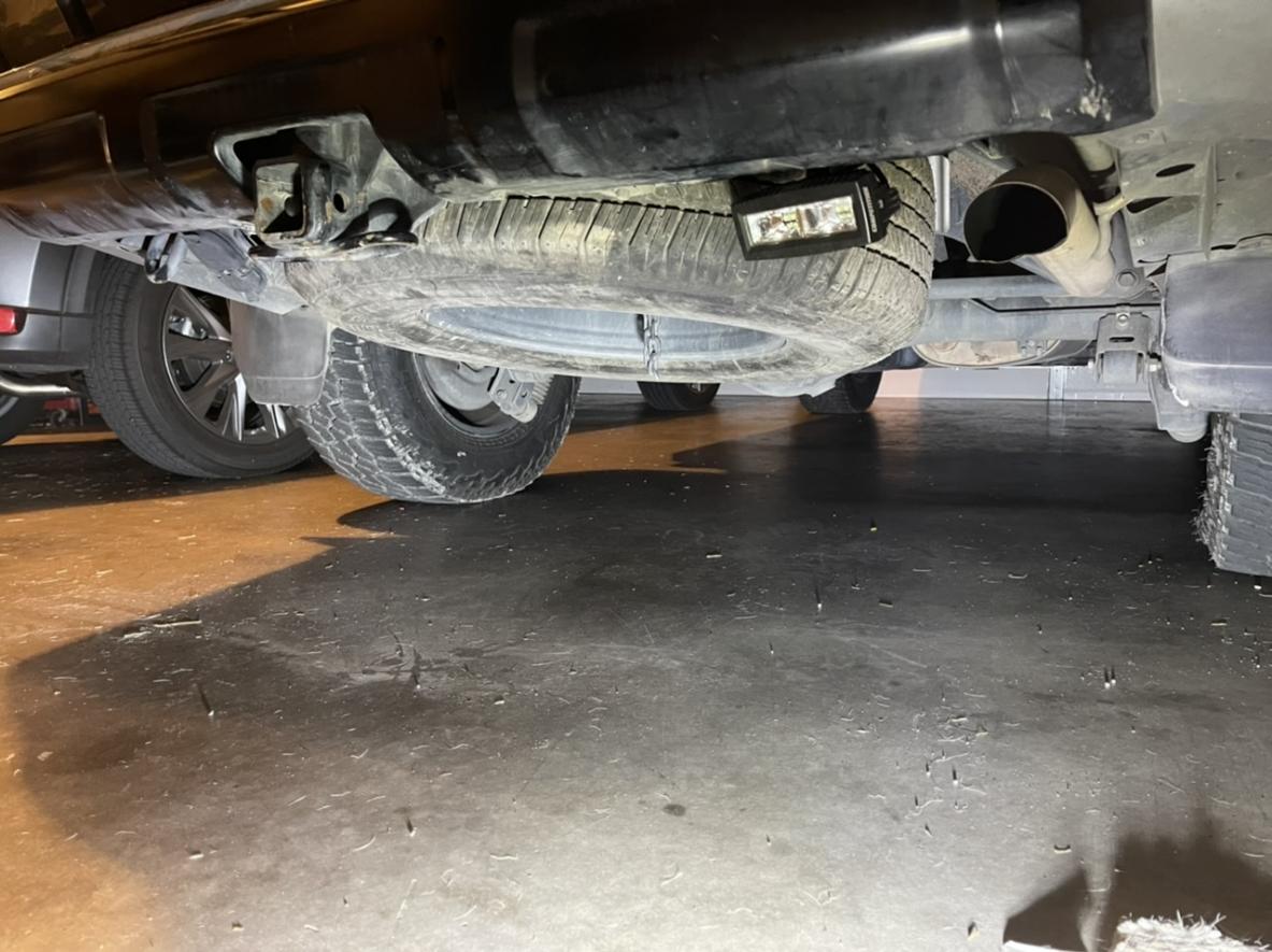

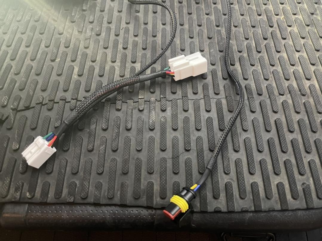

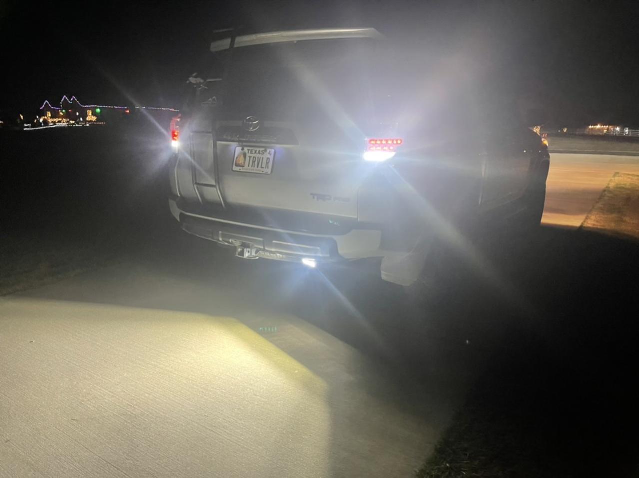

I added JDM ASTAR reverse LED bulbs, but felt like they weren't much of an improvement. I found an old LED scene light I had lying around and wired it up to the 4R for an additional reverse light. I used the stage series wiring harness from Diode Dynamics so it was plug and play to the factory wiring, and didn't have to cut any vehicle wiring.

How does that harness work? Does it plug into the tail lights somehow? Does that require any drilling or anything?
Wow, I just discovered your build thread. Looking forward to reading through it.
I haven’t really “built” this one like my last two Jeeps, been trying to keep with upgrade as necessary more or less. But I have had some good trips in it, and drove it up to Canada a couple years ago.
Unplug the tail light from the housing, plug the tail light connector into the new harness, then the new harness into the tail light. Route the wiring down through the bumper and connect your LED light to the harness. I’m a big fan of reversible mods.

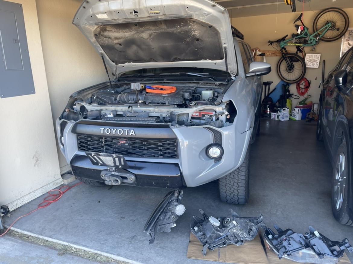

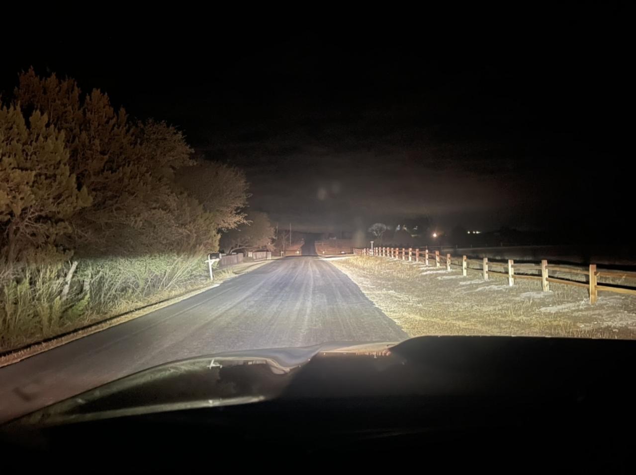

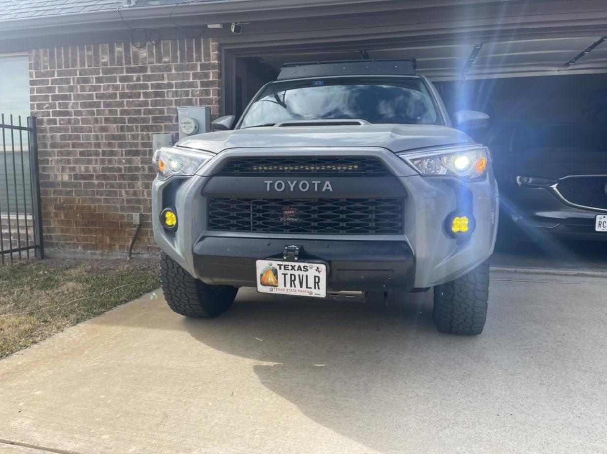

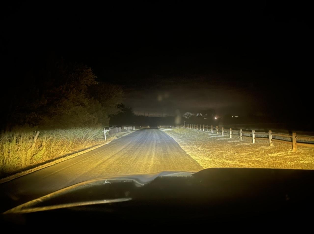

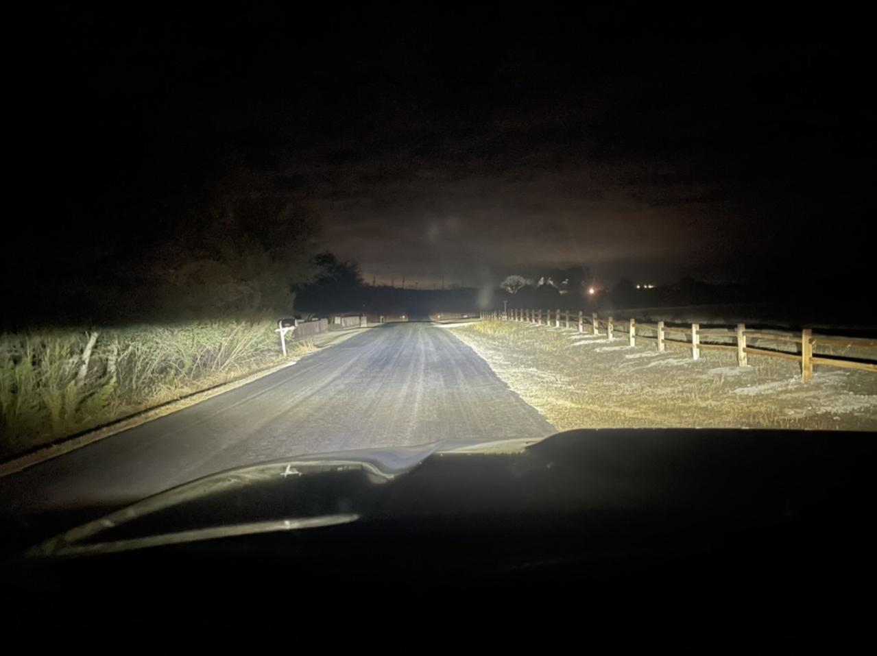

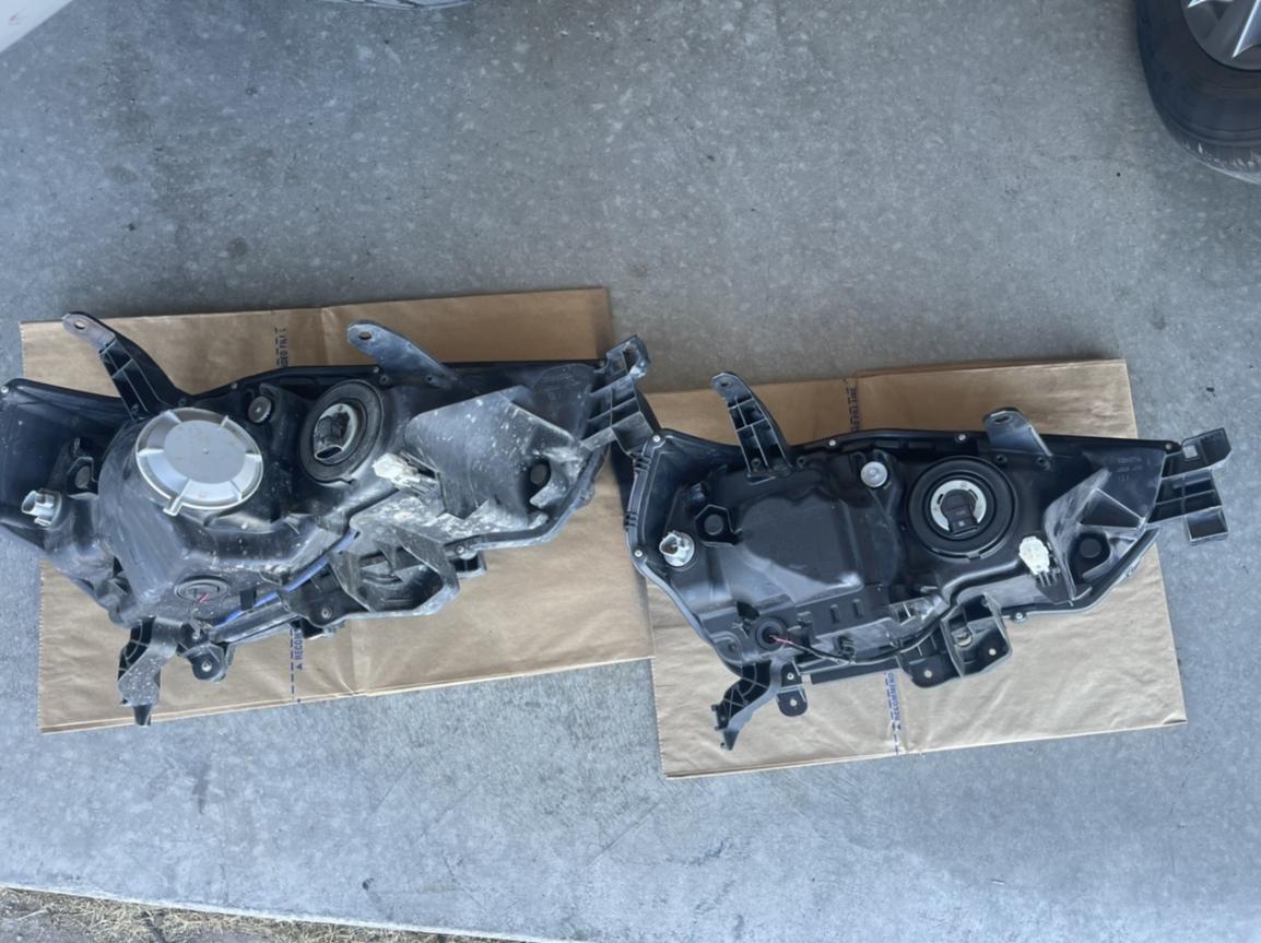

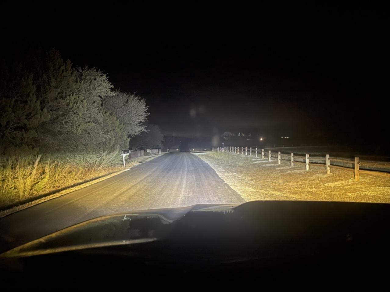

Picked up a set of 2021 ORP LED low/halogen high beam headlights, and I and more than happy with the output. It was a simple electrical connector swap, and plugged right up. I didn't want to remove the entire bumper because of the hidden winch, so I managed to remove and install the housings by just unclipping the sides of the bumper. I also installed some Diode Dynamics SS3 sport SAE fog lights. The sports have a good amount of usable light as fog lights, if you're looking for something to really project the light, I'd recommend Pro/Max and a different beam pattern.
Light photos are in order of:
low beam only
high beam only
low beam + SS3 sport
low beam + SS3 sport + RC 20" LED bar behind grill

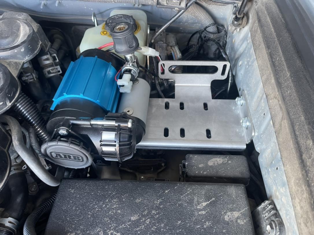

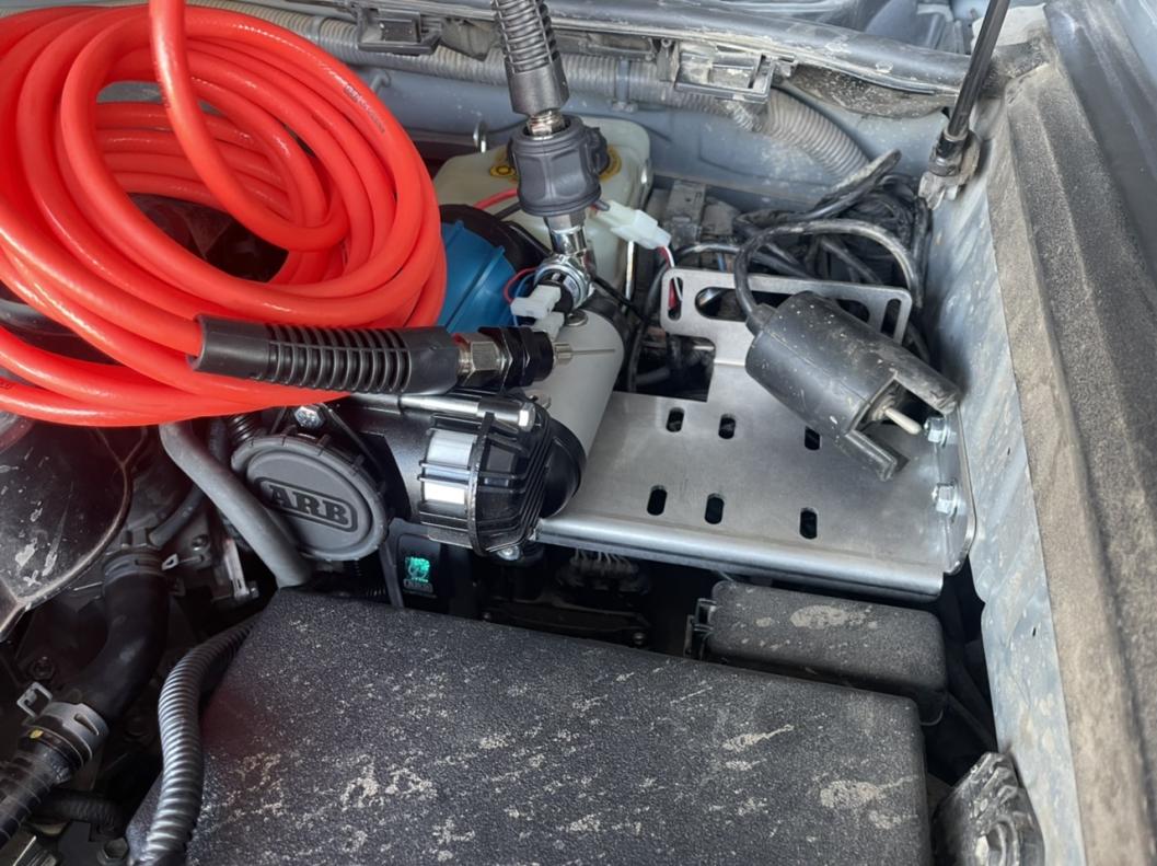

Installed the ARB single compressor CKMA12 on a Slee single/dual mount. I ordered an AOB switch to match the switches on the inside, but while installing I figured it’d make more sense to put the switch by the compressor. So I ditched the AOB and used the ARB switch in the cutout on the Slee mount. I doubt this 4R will ever see 34” tires, so the single should be more than enough to air 4 (or 6 tires if we get a tear drop) from 12-35 psi.
Now that the single ARB is installed, I'm happy to report with my results. Airing four 265/70r17 (31.5x10.5r17") tires from 15-35psi.
First: 1:52.95
Second: 2:05.15
Third: 2:08.50
Fourth: 2:17.61
Total: 8:24.21
Average: 2:06.50

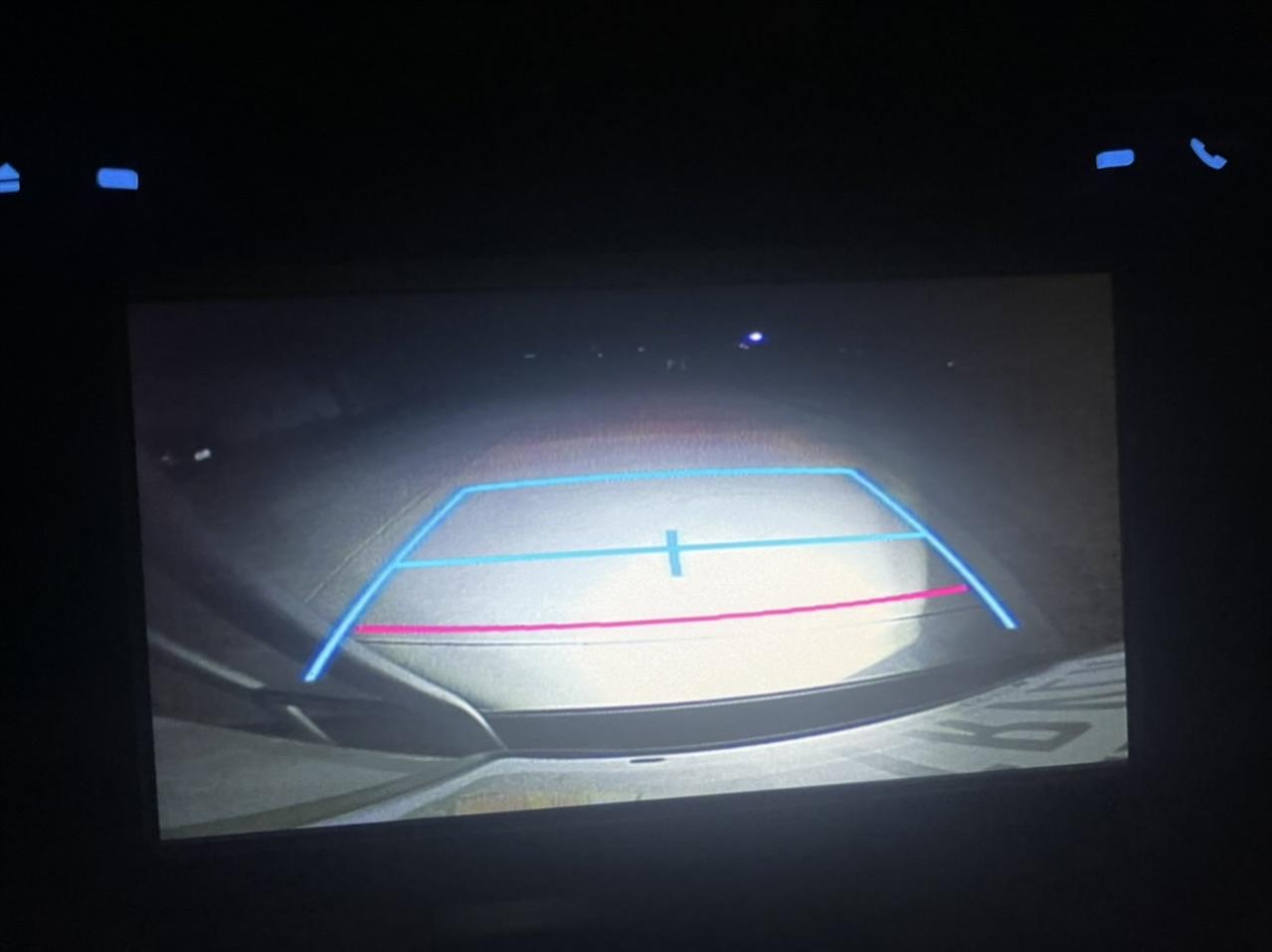

Also added the Anytime Backup camera wiring with an AOB switch so I can keep an eye on the trailer while driving. Switch is left of the AC fan speed.
