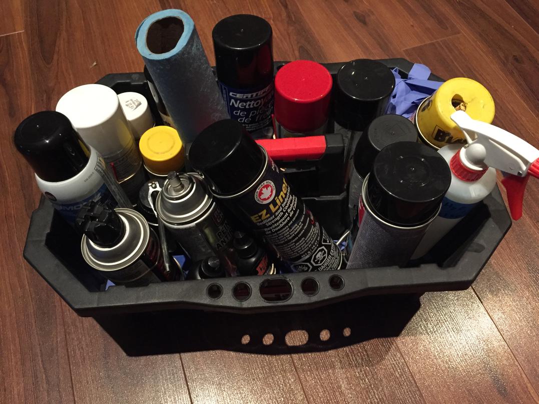

Last weekend I took several photos of my typical winter prep (after the ceremonial last wheeling trip of season "2" in Canada). I even put the icon coilover wraps on to my freshly T-9'd fronts. Everything else underneath is jet-black from my thrice-annual inspections and spot touch-ups.
My suspension wasn't designed for my environment. I chose it anyway, and take the onus of corrosion protection as my own. The shock wraps are a bit of an experiment for me.
As for chassis (and not suspension-centric rustproofing)... that's easy. Fluid film, rust check rust paint and a wire brush. The rest is ambition. All of my vehicles have always been prepared in the fall, and touched up in the spring. My 10-year-old nissan had less rust underneath than anything new you could find on a GMC lot in my neck of the woods.
It's worth your time and preparation.
The eastern Canada salt apocalypse kit
