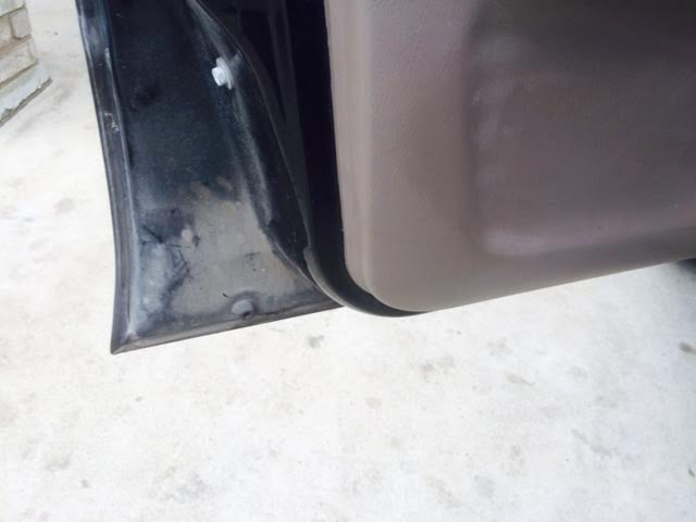

Last weekend I took several photos of my typical winter prep (after the ceremonial last wheeling trip of season "2" in Canada). I even put the icon coilover wraps on to my freshly T-9'd fronts. Everything else underneath is jet-black from my thrice-annual inspections and spot touch-ups.
My suspension wasn't designed for my environment. I chose it anyway, and take the onus of corrosion protection as my own. The shock wraps are a bit of an experiment for me.

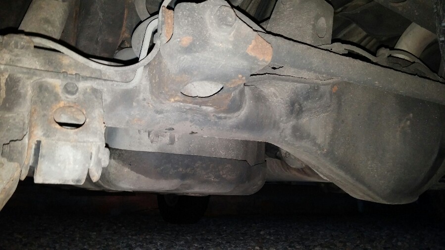

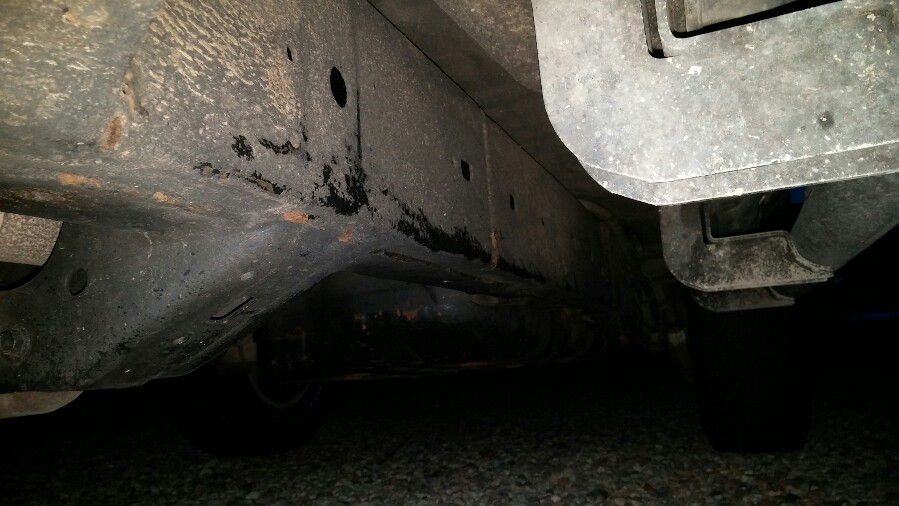

At least in Buffalo, not sure about elsewhere.. The shops there sprayed everything with undercoating. It has worked well. My last winter there I used fluid film and it did great. Here's a few pictures of my frame. It spent all it's life in WNY until last September. Pretty much all the brown you see is sand.

That frame looks awesome for buffalo. Im surprised its still even alive.

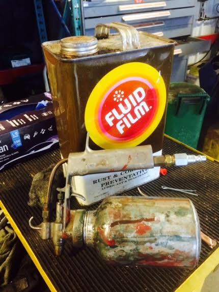

Fluid Film, is wax-oil based / I give it the Win.

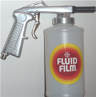

Now - I am a firm believer in wax-oil blended sprays, to wet and bond to metal (much longer), with built in rust inhibitors.
- Fluid Film is a far more reliable undercoating / done annually, for lasting protection
- if under-carriage is clean of dirt, your ready to spray / if underneath is muddy, power wash first & allow 24 hours dry time

Sorry about that. Here's a couple more. Not the best but you can see it's in good shape. A couple spots with surface rust.
