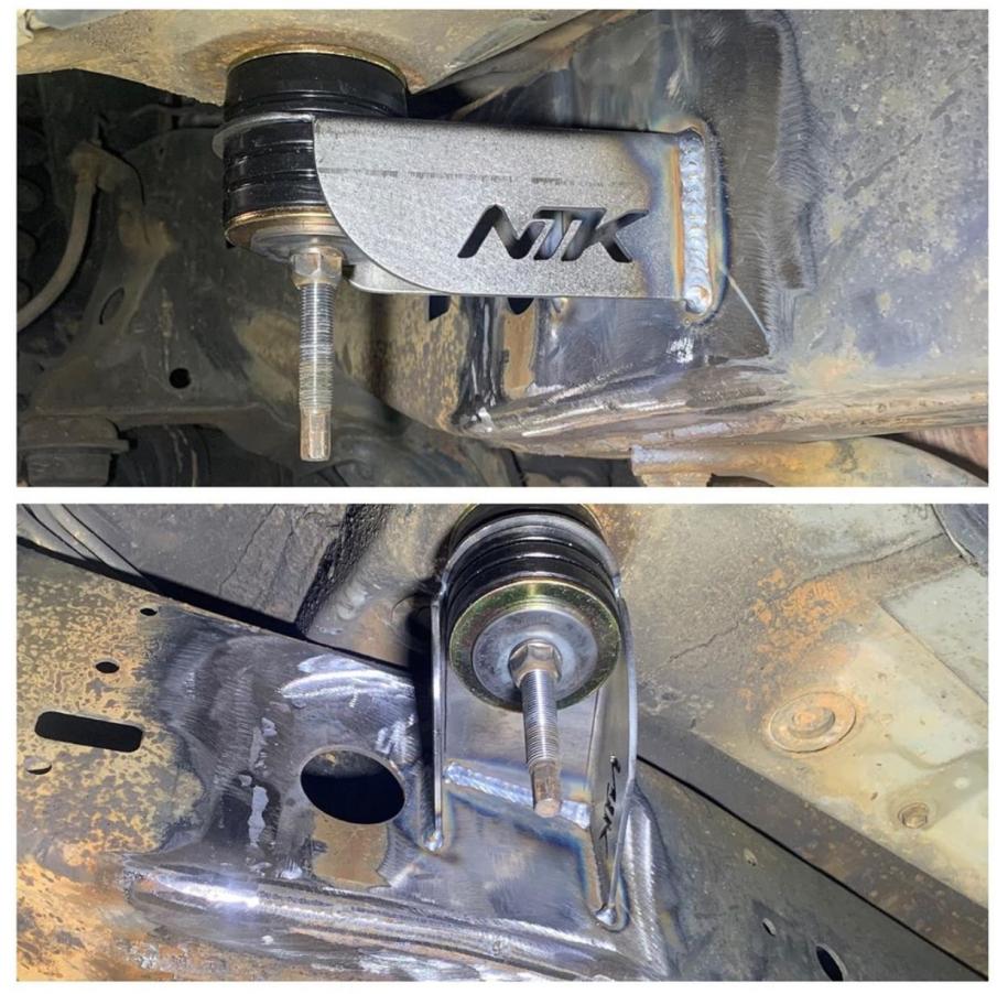

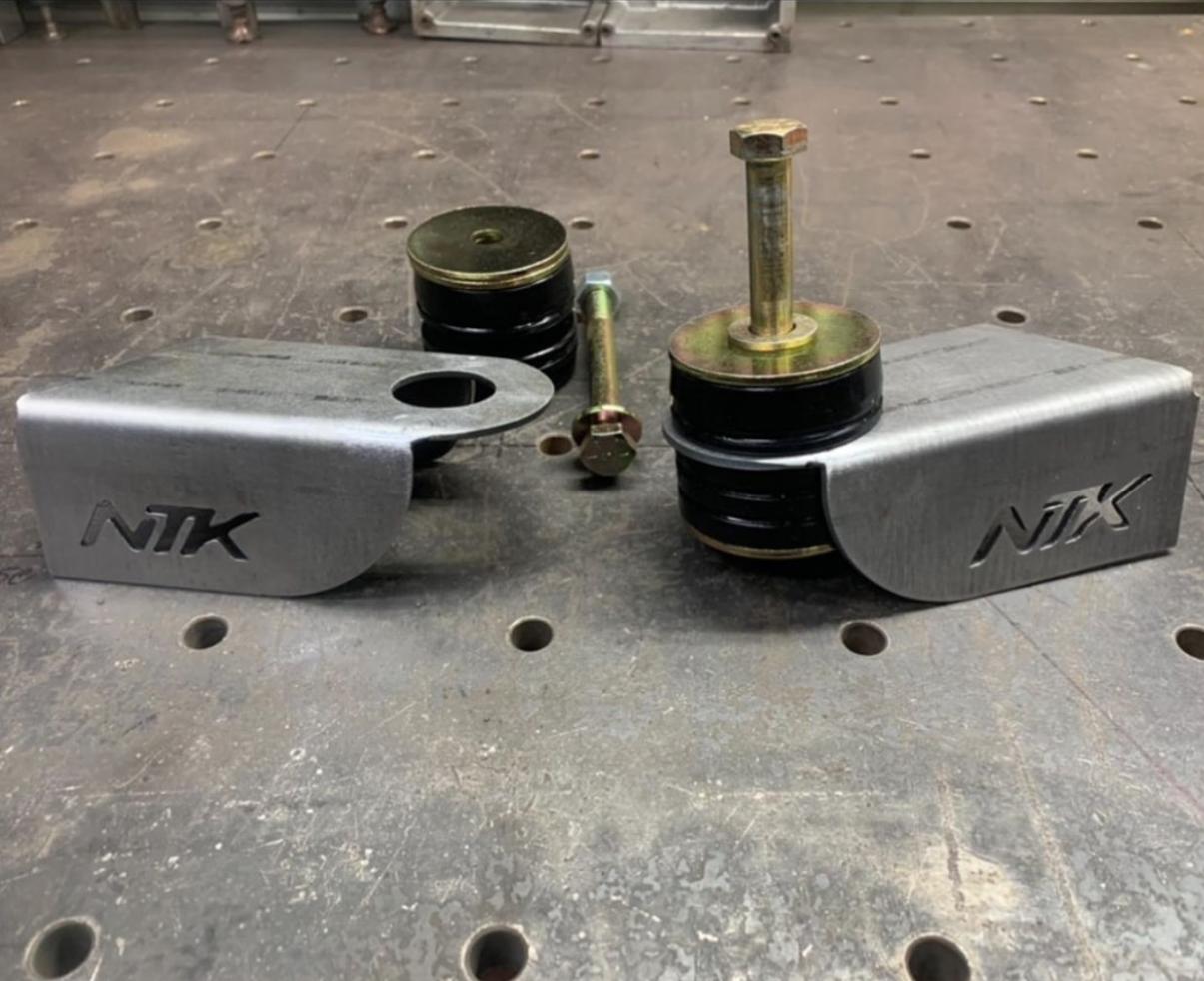

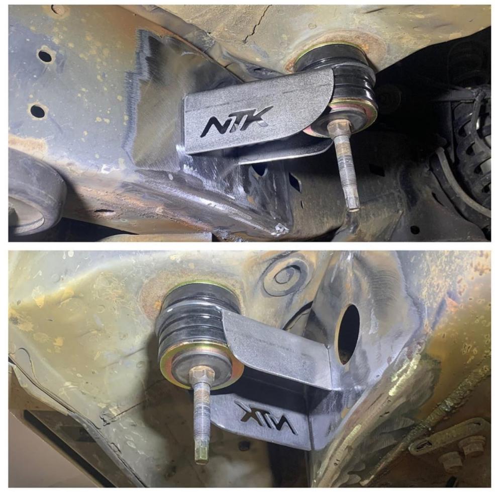

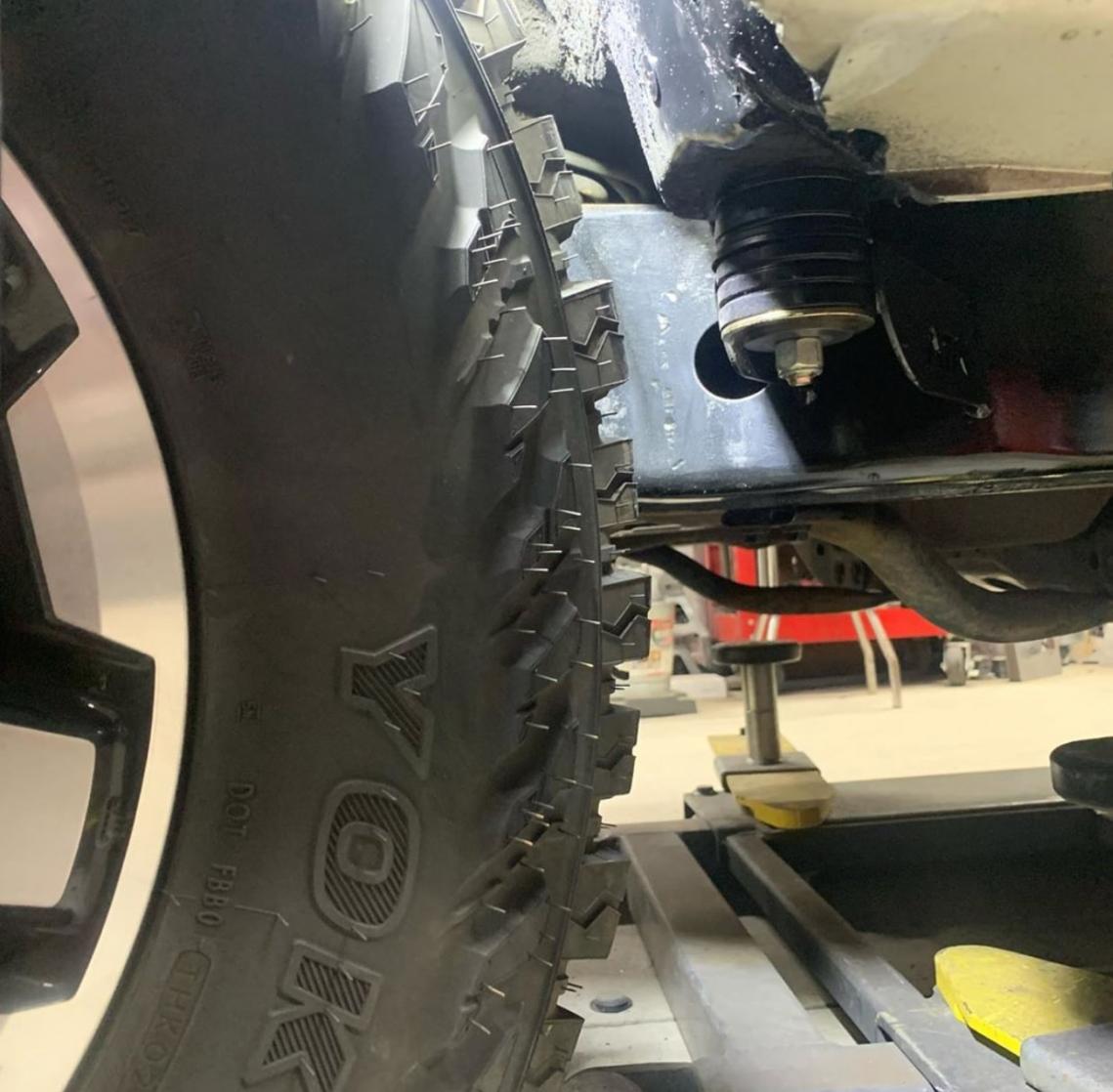

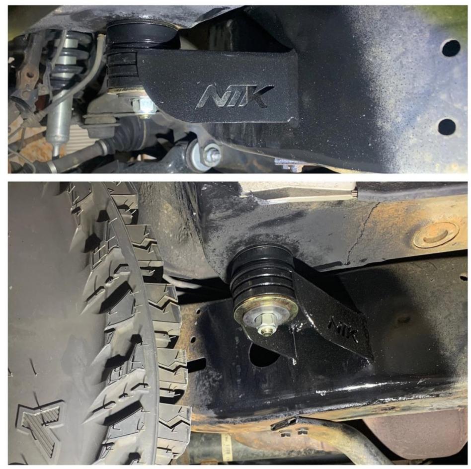

Dropped the truck off @NTK FabWorks for...drumroll please...a body mount....RELOCATION!
I wasn't happy with the clearance I was getting from a standard BMC so I looked around for awhile and found some options online for people building these kits. I was look specifically at one from QuarterTiltFab out of Cali. Theirs looks great but I can't weld so I asked Nick (the owner of NTK) if he could install them for me. He said yes, but also offered me the option to use my truck as a guinea pig and create his own kit!
So as you can expect, I said yes and dropped off the truck with him last night. He will also be taking care of some of the other stuff as well including pinch weld flattening, etc.
I'm very excited to see what he comes up with, you guys should check him out on insta, his work is super clean. @ nickkoupiaris

Check this link out, this is the guy who built and installed mine. He has since thickened the material but mine is still super beefy even if it's not as thick as the current version.
@nickkoupiaris on Instagram: “Been asked countless times for these cab mount relocation brackets, taken 2 months to schedule a vehicle in to ensure fit before releasing…”

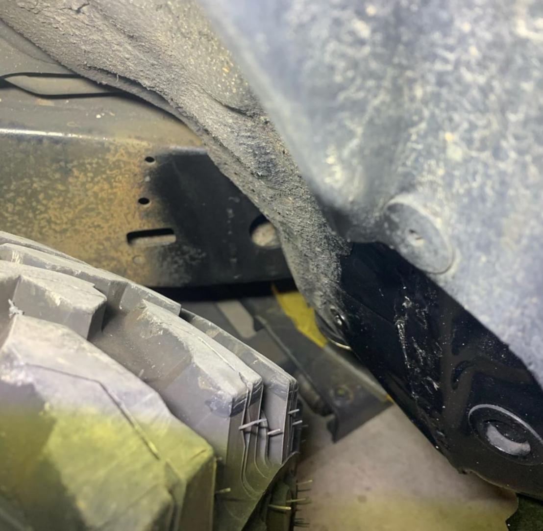

What does that do? I've never heard of this.
Have you heard of a BMC before? AKA Body Mount Chop. It is pretty much just the process of cutting back slightly (or not so slightly) the metal for the body mount directly behind the wheels.
When putting on bigger tires they will generally rub this area and the ways to fix it include, chop it, chop it and cap off with new metal, relocate it altogether (what I opted for), or in addition to any of those, aftermarket UCAs such as SPC that allow you to shift the tire forward in the wheel arch away from the mudflap/body mount area. See this video to show how you can also use the LCA in conjunction to push the wheel away.

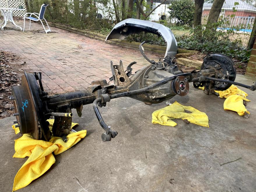

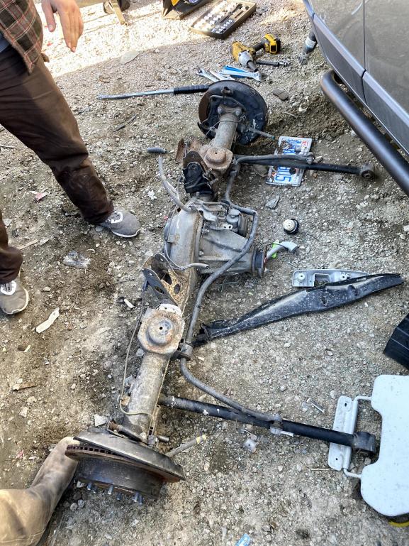

We'll get you one don't worry. LKQ always has some shit pop up when you don't expect it lol. Here are pics of the axle we ripped out:
Not pictured are the hypodermic heroin needles scattered all over the ground near the truck we were working on!!! :eyebrows::eyebrows: and thats 100% serious for those reading haha
