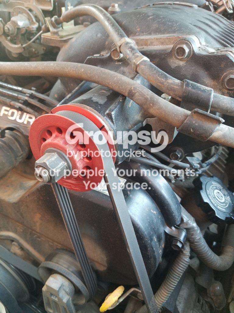

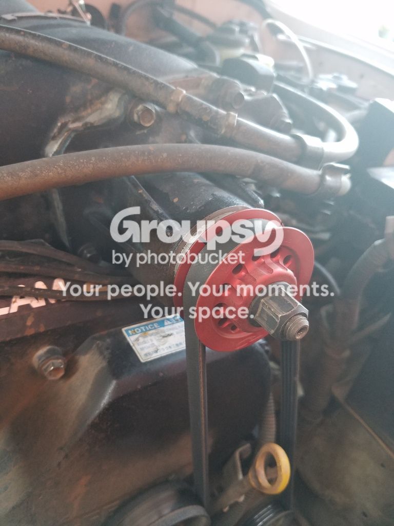

How tight should the alternator belt be with 2.2. pulley? My belt sounds like it's slipping in high rpm. Not sure if this is related, but after a rapid start above 30k rpm, it stumbles w/ power loss with some type of shattering noise. Tension on the belt is on pretty tight with about 1/2 inch resistance when pushed inwards.
If the belt is slipping, the engine RPM's will increase but the charger whine will not. Almost as if you let off the gas or something. A shudder or "miss" on the engine is a very different issue. Do you have the dynamic tensioner or the static?
I have a dynamic tensioner that came with the trd supercharger.
If you want a simple troubleshoot, take off the oil dipstick (one 10mm bolt) and release the tensioner so you can take the belt off. Clean off all the pulleys with rubbing alchohol and also wipe down the belt on both sides. Put it back together and see if it clears up.
That's what I did when mine slipped because oil had got on the belt and pulley and was slipping.
