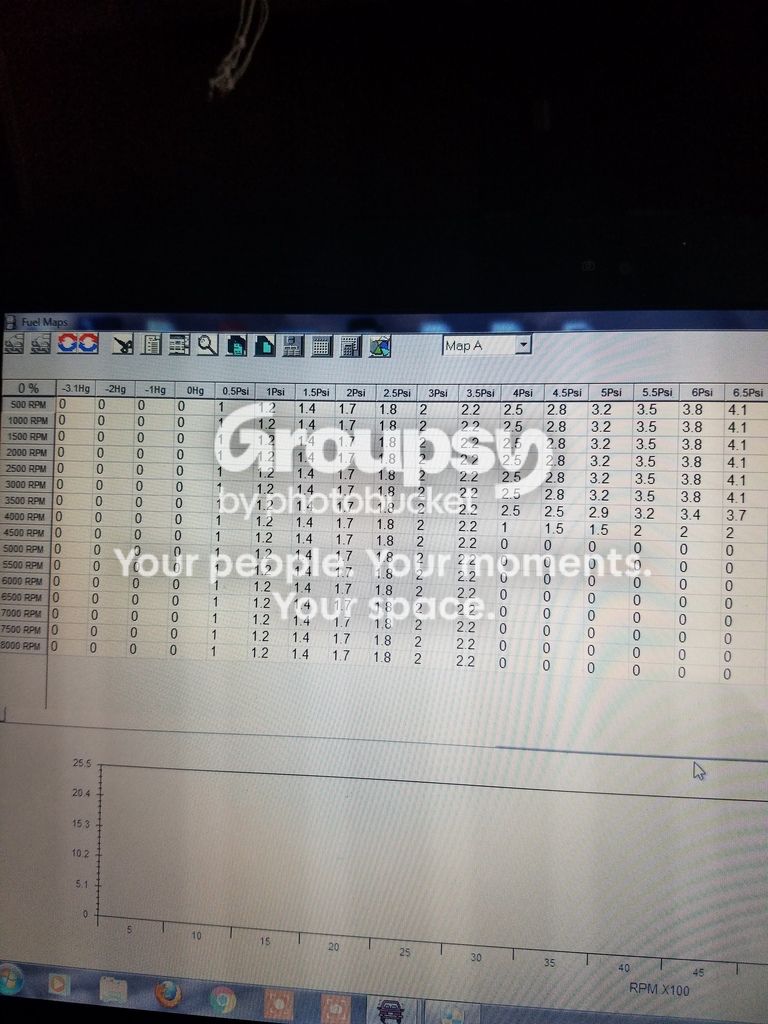

Alright guys, i need help on three potential issues. I installed my supercharger and 7th last August. We have since had a baby and this rig is our only DD for the baby right now. Thinking that a supercharger might have not been the best move on this rig for my current situation. Anyway, since it is the only way to get my baby around i really want to make sure the engine does not grenade on me and tbat the 4R runs in top condition. I know some guys say some pinging is fine and just drive out of its range but this is not good enough for me as my GF drives the rig also and im sure she will drive within those ranges.
My rig. 225k miles. 1998 5speed with locker. Trd superchager 2.2 pulley. 7th injector kit. Everything installed except for larger fuel pump.

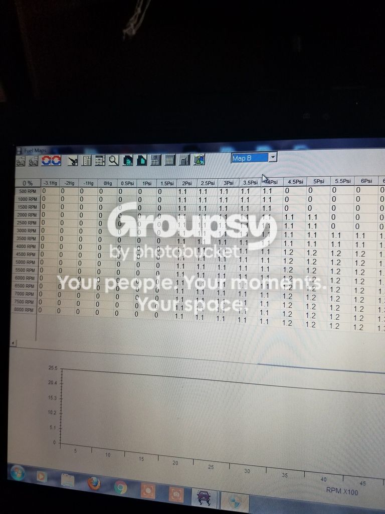

Onto the potential issues. First the pinging. I get low range rpm pinging while in boost. Say im going 30mpg in 4th and floor it..PING! 60mph on freeway in 5th and floor it PING!. Here are my maps. As you can see i have added a ton of retard and boost in the lower rpm ranges but nothing has really changed.I will admit im still pretty much a beginner at tuning.

So I have been emailing split second about their system. They have been super helpful in clearing things up. I have found that what they tell me compared to what Gadget has told me is pretty conflicting. Gadget told me I can't go below 1.5psi overpressure. Split second said you can. So what I did is set my overpressure to 5inches of vacuum by simply entering the number -5. Negative symbol for vacuum. It works awesome. The low rpm high load ping is gone. Gadget also said that the 7th does not have the capability to fool the ecm by manipulating the o2 sensor signal. This is also not true according to split second. When you adjust the overpressure, the split second ecm manipulates the o2 sensor signal in closed loop. When I got my 7th injector kit, Gadget had the overpressure set to 7psi boost. So basically if its set like that, your truck will run at 14.7 until 7psi which is why you get the pinging at heavy load low rpm around 4psi of boost because even if you have the 7th injector squirting fuel, the factory ecm is pulling fuel from the 6 injectors since its in closed loop and their is no o2 sensor manipulation. By setting overpressure to a much lower setting, you command o2 sensor manipulation earlier and thus get a richer air fuel ratio in that 3 to 4psi pinging range.
I had always THOUGHT this was the way it worked, and have been running mine similarly for awhile now with wonderful results. (Remember, I started this tangent of the "1.5 PSI threshold" awhile back. Mine is set to 0 I believe). It's good to finally have some sort of confirmation.
Only advice is to be careful of roasting a catalytic converter by beign overly rich too frequently. Every once in awhile likely won't hurt, but it's all designed for 14.7:1 (obviously) so you can imagine how a constant 11.8:1 would be detrimental over time.
So can this be done with just the URD 7th injector kit? Or do you have to also have to order a Split Second ECM or other part?? I have a 7th injector...just haven't installed it yet. So, I'm unsure how it works or if you're able to program anything on it. I'm tired of buying crap that doesn't work as it should...hence the reason I haven't installed the 7th injector kit yet!

The URD 7th injector kit utilizes a split second piggy back ecm. URD or Gadget as he is known installs a fuel map into the piggy back. But you can hook up a laptop to the split second and make your own fuel and timing maps.
Good research
Yes for sure, when I found this out, I set my overpressure to -5 which equals 5 inches of vacuum. It then ran pretty rich in vacuum-I was in the 9's afr, so I set it to -3 and then reduced the 7th injector flow in vacuum, its still too rich and I need to back it off.

Mine is a 99, so it uses a narrow band o2. Their is supposed to be a difference between the split second units that use wideband. What do you mean overage? You mean in your fuel map? Or do you mean your overpressure in the output b in the options menu? If you set the overpressure to 2, it basically sends a false signal into the o2 sensor signal wire so that more fuel can be injected with the 7th injector and the ecm won't know its actually richer than 14.7. By doing this though, I think the 6 injectors as a result dump more fuel too. At what point is your ecm bringing the fuel to 14.7? Is their a point you reach in boost where it seems to not bring it to 14.7? In the options menu, click on output settings. In output b mode select over rpm and pressure. Then below you will see the over pressure and over rpm boxes. Set the overpressure to -3. Set the rpm to 1700. If its really rich this way, try going into the fuel map menu b and reduce the 7th injector flow for those areas where its too rich. If its still too rich, try setting the overpressure to -2 or -1. You can also adjust the rpm where overpressure begins to fool the ecm.
