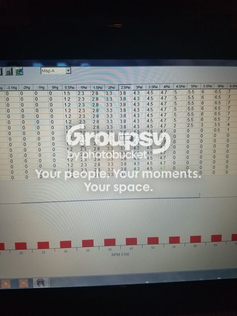

So i drove around to tune my timming. Im throwing a ton of timming at it and im still getting an audible ping in some areas. Its driving me nuts! Is there a no-no as to how much timming is too much? Is there somehing that could be wrong with my rig in gerneral if it needs this much?
My map right now. Areas with all the columns filled are values i have changed.
You are tying to pull timing right? Because I know AEM's software requires a negative sign in front of the number
I think I pull around 6 degrees in one part of my map.

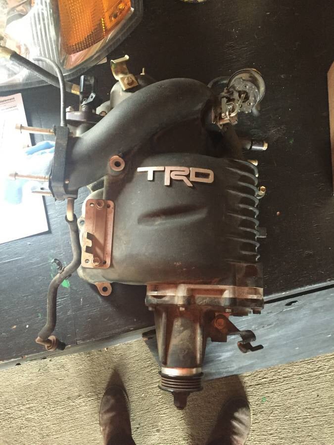

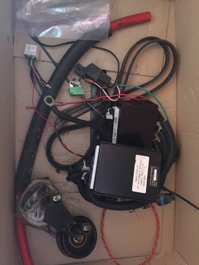

Been in the hunt for a 2nd gen SC and found one. SC has 18K, came off a wrecked Tacoma. Comes with tensioner, hardware, fuel management system and everything else needed to bolt it up and running. Asking 1800$. Seem like a fair deal? Anything I need to ask about?
Talk them down haha. If you pay that youre doing good. What fuel management does it come with? I had a buyer lined up for my. 1st gen before i decided to keep it for $1600, no power difference between them but 2nd gen is easier to rebuild if you need to.
I asked him if it was the urd 7th injector kit and he said no. Haven't heard back on what specific management it is.
Uhhh yeah that's a sweet deal. Don't let that pass up ok?
Yeah I figured it was a good deal. I'm thinking it was a factory installed SC because he says it came with TRD management.
Good for you man! With that low mileage claimed I wouldn't even do a rebuild. A guy from this years meet up in CA a few weeks back said his had 80K and bearings were fine. Mine had 30K when I got it and it's fine as well. I threw on the nose cone kit but back then it was only like $200...now it's over $500 from what I've seen!
I guess it all depends on your level of OCD and pocket book. Either way, good find man. Enjoy it, they're fun.
That's the TRD 7th injector I think! They made them for a while but were discontinued. I'm jealous, that was a great buy. If new, that's over $4000 in parts sitting right there.
I'm jealous as well. Mine was factory installed and mine don't have the management system. If it does it's not under the drive side dash.
