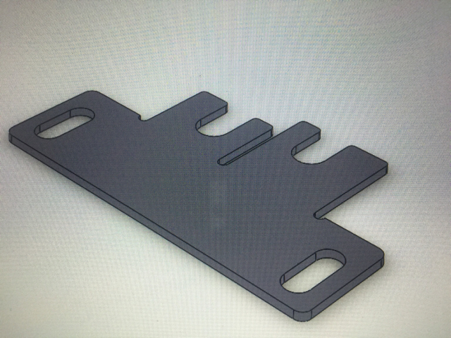

So guys. I created a drawing of the dual throttle cable/ transmission cables for the supercharger.
I am going to see what I can do to get these cut out soon and shipped out. I will probably post them on my fatpatsbodylifts.com web site for sale. But again what should I list this for? $15 free shipping? Is there much of need for the dual brackets?
I need one!!! Put me down on the list!
I'll definitely take one!
