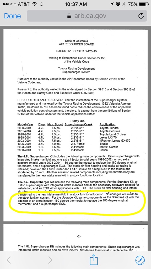

I'm pretty sure if you have this EO sticker (D-425-15) and take it to a not-so-on-top-of-things smogger, he wouldn't be able to tell the difference. It says upgrade kit comes with extra injector and "supercharger ECU". And just wrap all hoses in black conduit to not stand out. Worked for me 2 times so far. Maybe I'm lucky?
I need to go to Vacaville for my next smog check LOL. The guy I had was super picky and new CARB regulations like the back of his hand. Basically could quote stuff almost verbatum.
Have you ever had issues with the wideband? I just had mine welded on and installed and all that and the smog shop didn't think it would pass.
Well in fairness, I'm in the industry and the shop nearby doesn't ask any questions for me. If it runs clean, it passes.
As far as wideband, I don't see how that affects emissions. I'd try an arco gas station smog shop or something. Some of these smog guys used to get picked on in high school or something.
