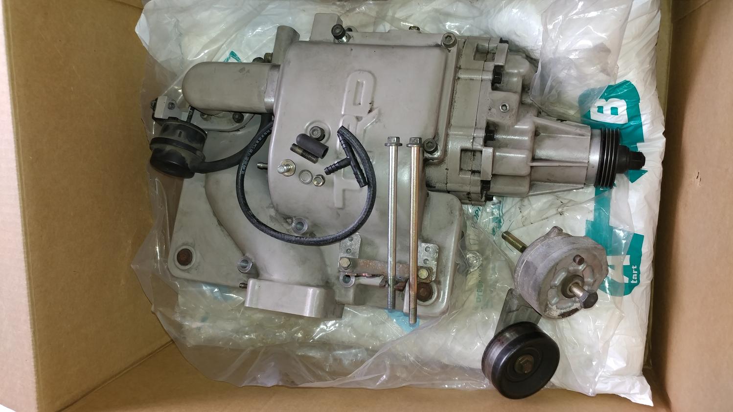

Also... Is there anything elseI should have with the dynamic tensioner other than what I have here?
One awesome thing... Looks like the nose cone has already been modified to be serviceable for future oil changes!

I cannot help with the bolts, as I was lucky enough to get mine complete.
However, your nose cone is modified, and you have a dynamic tensioner as well in your photo which is a couple hundred you wont have to spend for the TRD item as well. The bolts may have to be custom made

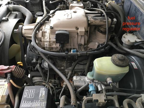

I recently bought a 96 4runner - manual with locker and other goodies. One of the being a 1st gen supercharger that has been installed since 40k miles (currently at 235k) - no fuel mods because it has always been in Denver. The previous owner put a lot of money into the 4runner over the years and the head gasket recently blew (had been showing signs for awhile and the radiator finally cracked) and he decided to move on and I bought it. Below is how is currently stands - I am excited to get it back on the road.

2. Fuel regulator - reading the install manual for the 1st gen there is a fuel regulator that was originally part of the kit, but sounds like it was later deleted. Looks like my 96 has it installed. Should I delete it when I install on the new engine?

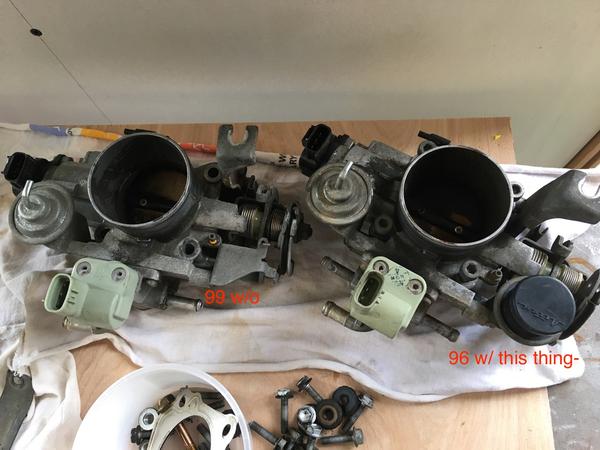

4. Throttle Body - The 99 throttle body is different than the 96 because they got rid of the dashpot. Since the 99 is newer and lower miles I would like to run that throttle body. Can I run the 99 throttle body without issues?

2) not sure about regulator either. Sorry. I know for the black SC the stock one ges lined into the boost port.

4) throttle body is manual vs automatic. Not necessarily for years. Manuals have the dashpot to help hold the throttle open slightly during shifting. My engine is from a 98 automatic and has a computer of a 99 manual Tacoma. And it works fine I haven't noticed a difference. I am, however a little anal retentive and did want to try and find the actual manual throttle body wth dashpot just so that everything is like matched... Soooo if you decide to go with the 99 TB and it all works how you want, I'd be happy and excited to take that older manual TB off your hands... Just an idea.

Thanks for the insight on the difference in throttle bodies being auto vs manual. I assumed it was because the 99 was newer. I will stick with my original then because Toyota probably put it there for a reason.
