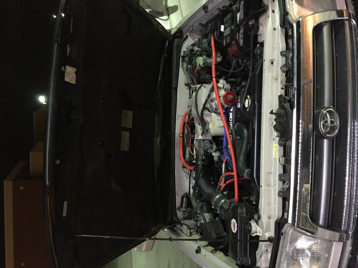

So I posted a little bit ago some info on my experience with my trd grey supercharger. My 96 limited was running great without fuel mods. Never a ping or knock, granted I live in Denver. I am happy to report I added a URD 7th injector kit, URD 2.2 pulley, and URD 02 calibrator. Truck is running so good. The morning after my 02 calibrator install, I went to dart my truck and threw a check engine light( 2nd time it's ever thrown one the whole time I have owned the truck). It was a misfire on cylinder 2 and 4. P0300,P0302,P0304. I cleared them and checked under the hood and found nothing out of the norm. My buddy said sometimes when adding a piggyback to the ecu it can resist a little at the beginning. So I chalked it up as that and have been running great since. That was over two weeks ago.

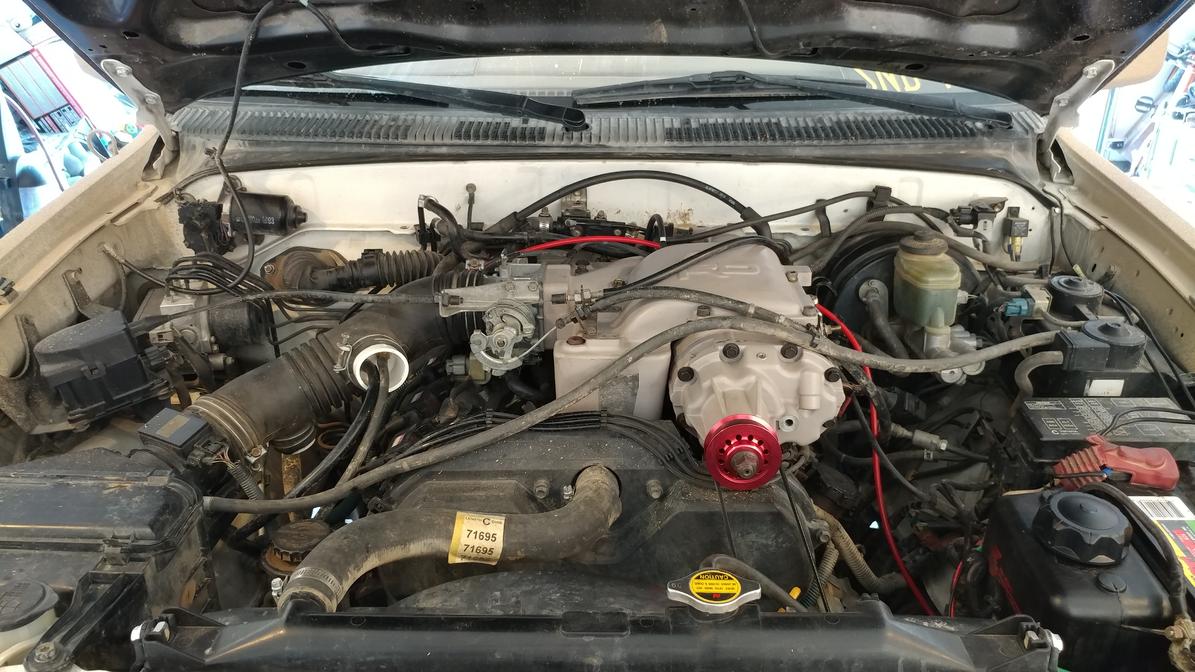

I have the 2.1" pulley but it's not from URD. It's a black pulley sourced by a local performance shop, at prices cheaper than URD. I got it on sale on their Ebay store for $89. They have 2.2" and 2.1" black or red pulleys. Fits perfectly and is strong, I've been running it a year without a single issue and the belt is in great shape.
1320 Performance supercharger pulley TRD 3.4L Toyota 5VZ-FE 5VZ
BTW, I don't think I ever shared this.
I have their 2.2 pulley in red
