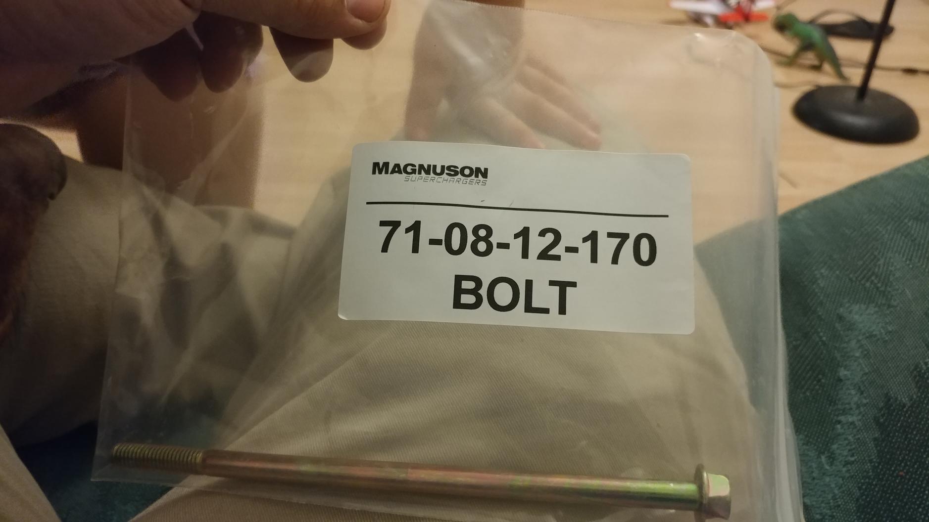

double check that bolt...
It's the right length and thread pitch, but it's a large 13mm hex head and it won't be able to seat in the milled landing on the first gen SC as there are contoured ridges all around the area it would seat.... Same story with the only other "close" option I could find, a 12mm hex head with an even larger flange sticking out...
Soooo....
I contacted Magnuson told em the bolt I was missing for my installation and they have me a part# (PTR29-60031) which got no hits through local posts stores and was only available in a qty. of 50 per bag...
Called em one more time,, explained that I could only find it in bulk and if there's any way to just get one from them directly... He said sure 13 bucks plus shipping!
Sold!
LoL. Not letting one high priced bolt keep me from completing my rebuild and install!
Got it in!

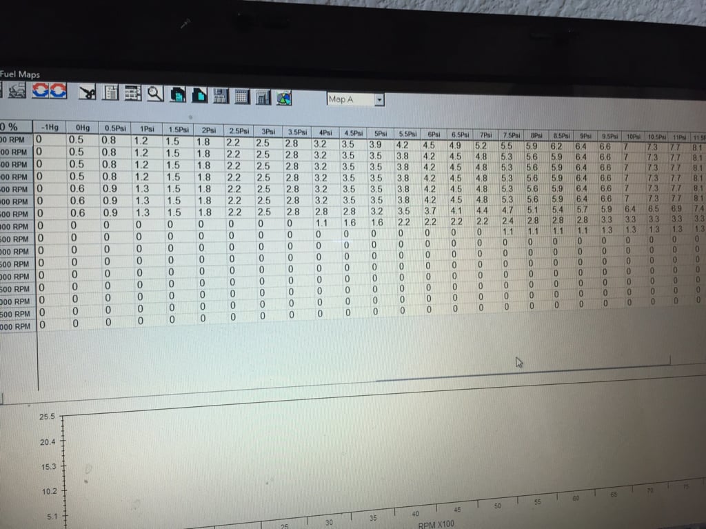

When I did mine last year I tried to balance it by adding fuel AND adding retard step by step to remove knock since added fuel will also help to cool the compression charge and therefore remove knock. So I didn't notice a dramatic decrease in power in the lower RPMs but also I'm not expecting this thing to be a rocket. I like how mine drives so I stopped messing with it.
Again, this doesn't really help with your initial question so all I can assume is that you're probably normal. The ECM is going to do what it can, and if your not getting ping, I wouldn't be too concerned. Squeezing every HP out of these is a delicate dance and I've just learned to accept that enough is enough at some point. If it helps, here are my maps for you to compare. I have a manual and with 4.88 gears so that might make a difference in feel too.
Map A (which should be timing if I remember)

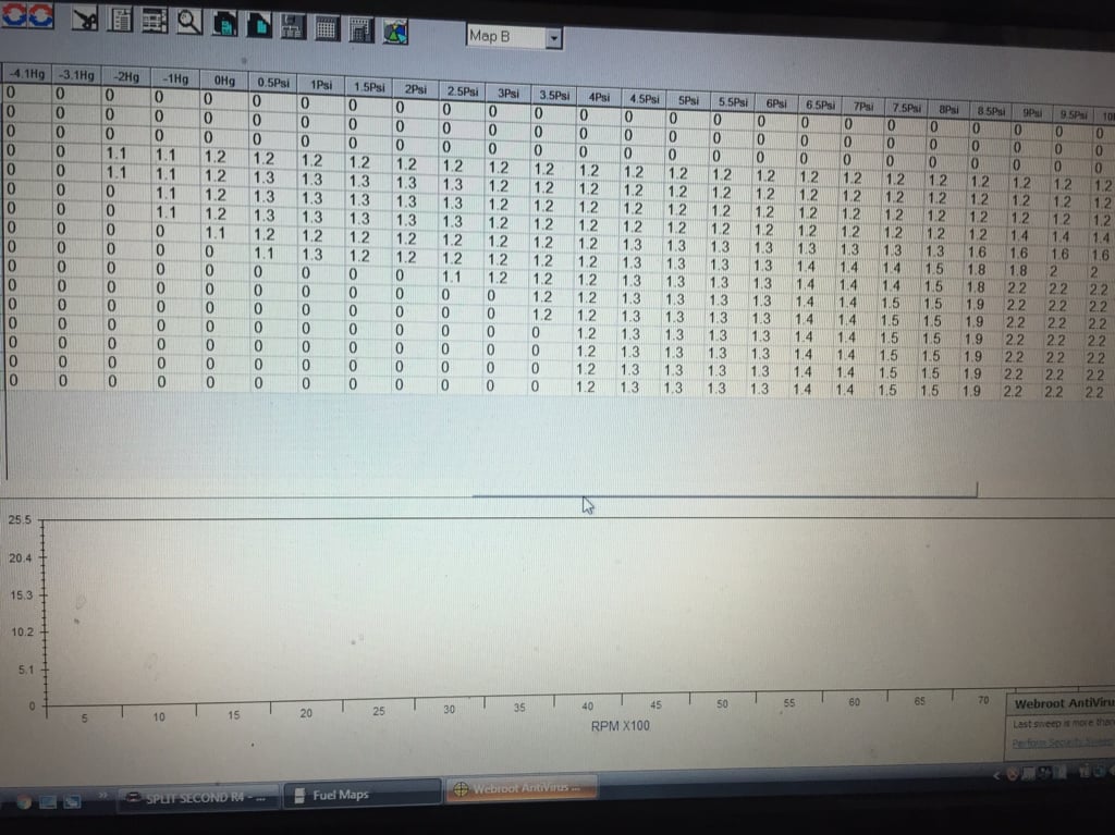

Map B, fuel. Notice how I added a bunch of fuel in the lower end as well. AFR's are about 10.8~11.8 throughout my boosted rpm range. Probably a little richer than it should be, but a cat is cheaper than a motor, and I'm also a pretty conservative driver
Bottom line is, if you had to pull the extra 5° out to stop a ping, then that's where it's going to be. Playing it safe is just a better move in my opinion.

Thanks for the pics for comparison. Only difference is I notice I have to pull a lot more timing than you at the 2500-3k rpm rows starting at like -2 inhg. This is where I ping the most even before boost which I why I have to start pulling 2-3 degrees at like -2 inhg.
I'm happy with it how it is but was just getting bored with it and was wondering if I can fine tune it in some in the areas I find I am pulling a lot of timing. Also wanted to check with others to see how advanced other ECMs run the timing.
I don't add fuel until like 3k rpms and 4 psi (I believe I kept the fuel map exactly how it came from URD). The closed loop enrichment (over pressure setting) starting at 1 psi boost seems to keep my afr low enough at low boost without having to add fuel with the 7th.
With your closed loop enrichment set at 1 psi and having the 7th injector starting to fire at 0 psi, how rich is your afr at low boost? I'd imagine it would be pretty rich. If you find this works well I may try this with my fuel map to see how it affects my timing map.

Yeah I'm probably richer than it should be at lower boost levels. Normally floating around 12~12.8 when I'm at like 2-3 psi or so. Sometimes lower. I've read the sweet spot for max power is 11.8 but I don't know if that's supposed to be across the board, all rpm and all boost levels, or only WOT. I shot for that number at ANY time I'm above 0 psi. It's tough tho since things like air temperature and humidity can drastically change it. again, it's generally safer for the ENGINE to be rich. Sure the catalytic converter isn't going to last as long, but those are a couple hundred to buy and have welded in for mine.
I can definately tell you that if I go on a heavily boosted drive the exhaust is rather pungent...Dollar bills out the tail pipe...

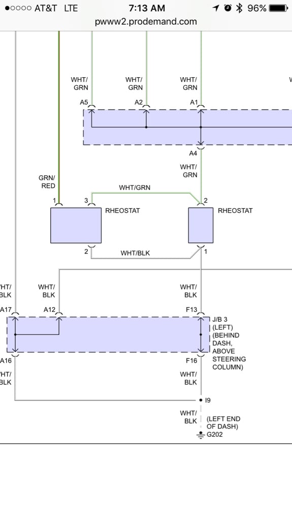

I got my wideband A/F gauge yesterday but I am not sure which wires to tap into for switched power and the wire for the dimmer. This is for my 2001 Tacoma. Any help would be appreciated.
Grn/red is illumination power, wht/grn is ground path that gets dimmed. My gauge had to be set up on a laptop to tell it which side (power or ground) gets resisted.
