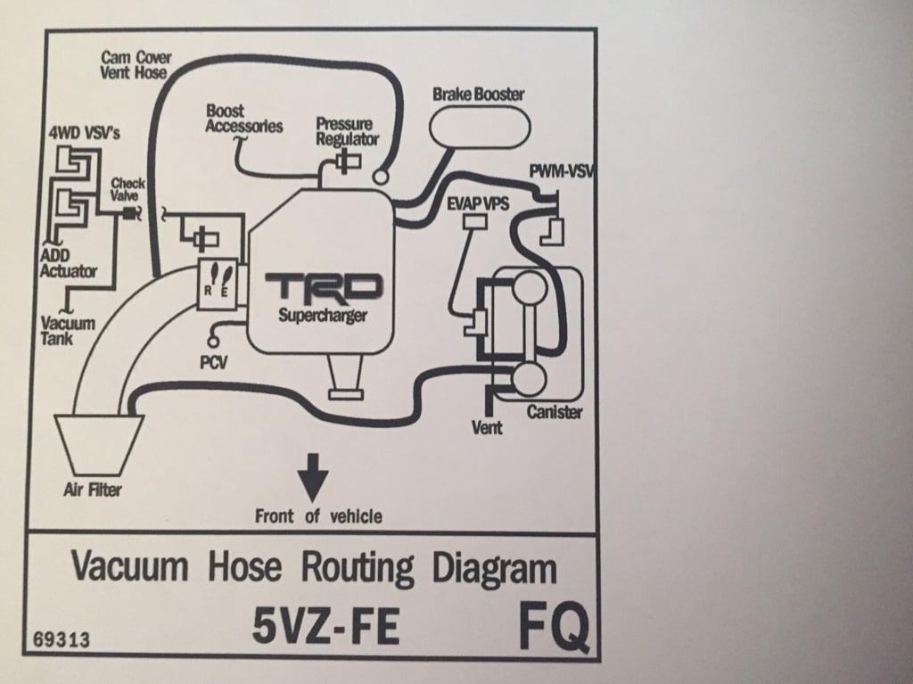

Did this today finally with my free time. Been meaning to tackle this for awhile to match the 3.4 swap and supercharger while keeping a factory vibe under the hood.
I guess if anyone wants one I can work on printing some out.
Couple things to note:
#1 I'm just using shipping label sticker paper that I print on and then use Kinkos to laminate. So I have no idea of the overall longevity. Seems good, but time and heat will tell
#2 since my truck is a 2nd gen and 99% of people with the 3.4 are 3rd gens, I need to move some stuff around, such as "4wd VSV's" since on a 3rd gen those are on the driver side.
#3 if anyone who has a similar level of anal retentivity as me does actually want one, to keep it correct to your vehicle I'd need the 5 digit code in the bottom left and 2 letter code in bottom right. For mine, I just made them up since it's all uncharted for me.
Devil is in the details.
And if you don't think it's that cool, go pop your hood and check out your current label... Doesn't do the system justice!

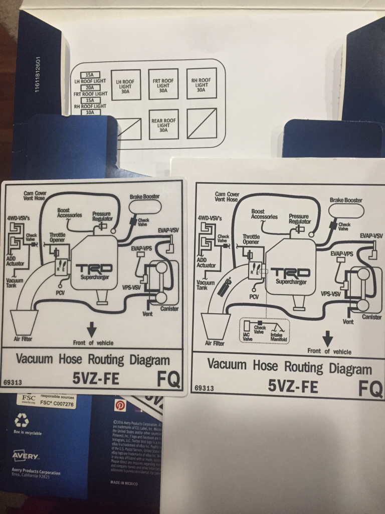

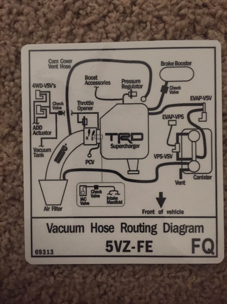

I guess there will be a few different versions. My final version for mine is just about done. Added a couple things, tweaked a little more. I'm debating on reworking it to include the "Air Assist System" which is the T hose in the back that the check valve gets installed into. Issue is it starts to look a little chaotic with all that jumbled in there. I guess I can make it an option if people are interested.
Sooo major sticker OCD warning ahead...
Laminated what I thought was final copy for my truck... Then I kept thinking. On the right one I added the K&N logo as well as a cutaway/zoom in type deal for that fancy check valve behind the SC.
Any opinions on which is better? Doesn't really matter, but I'm a stickler for details. And technically the right one is more complete and accurate.
Anyway, if anyone gets serious about it I can tweak any which way within reason. But I'm currently torn on which level of detail to follow.
1st world 4Runner problems.
Cool I'll play around with it soon and see what I can come up with. See if you agree or what you'd like different etc. can you confirm overall dimensions are about 4.5" X 5"?
