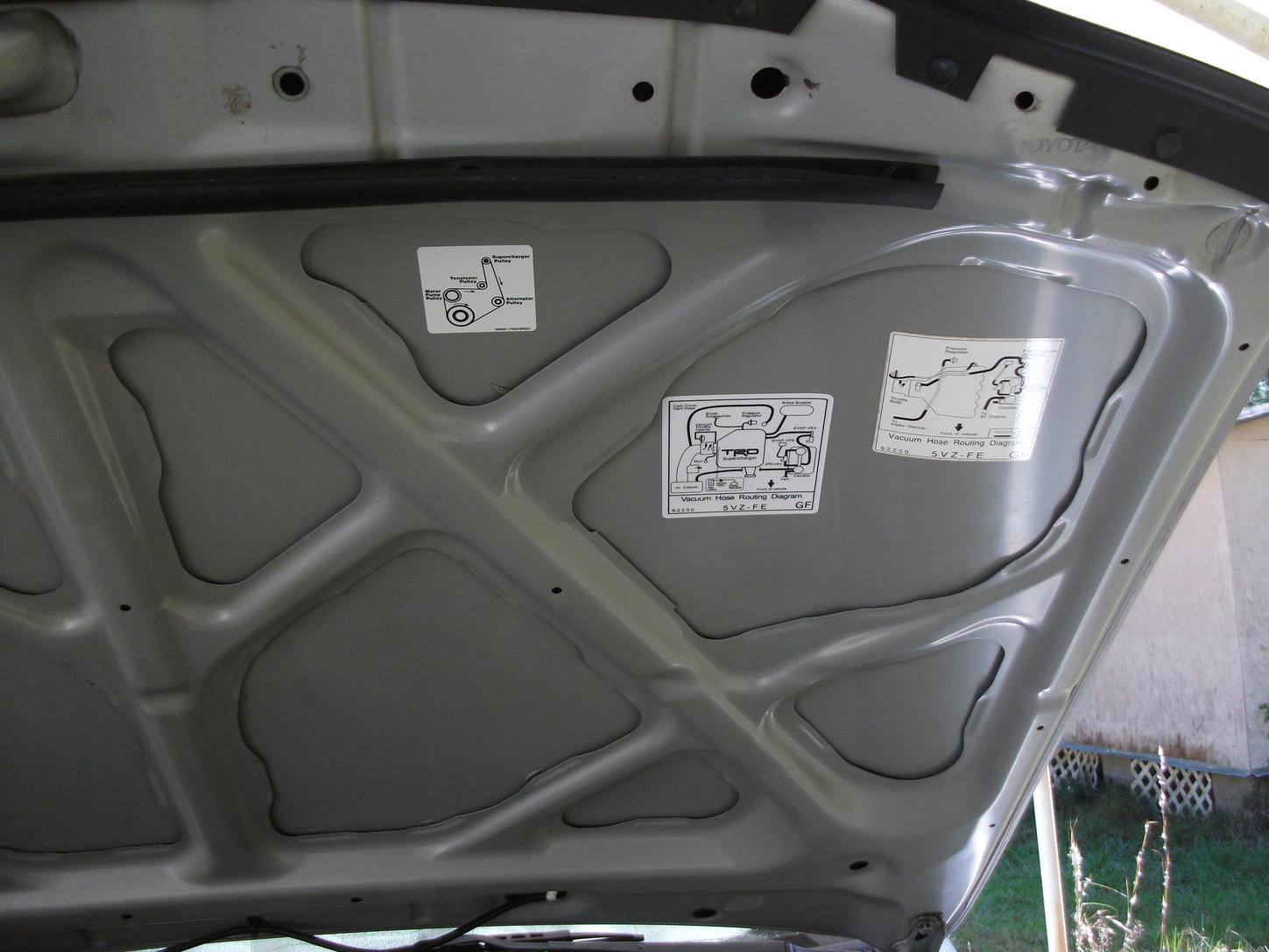

Glad you approve. Posting up a before and after
Now it's time to install the unit!

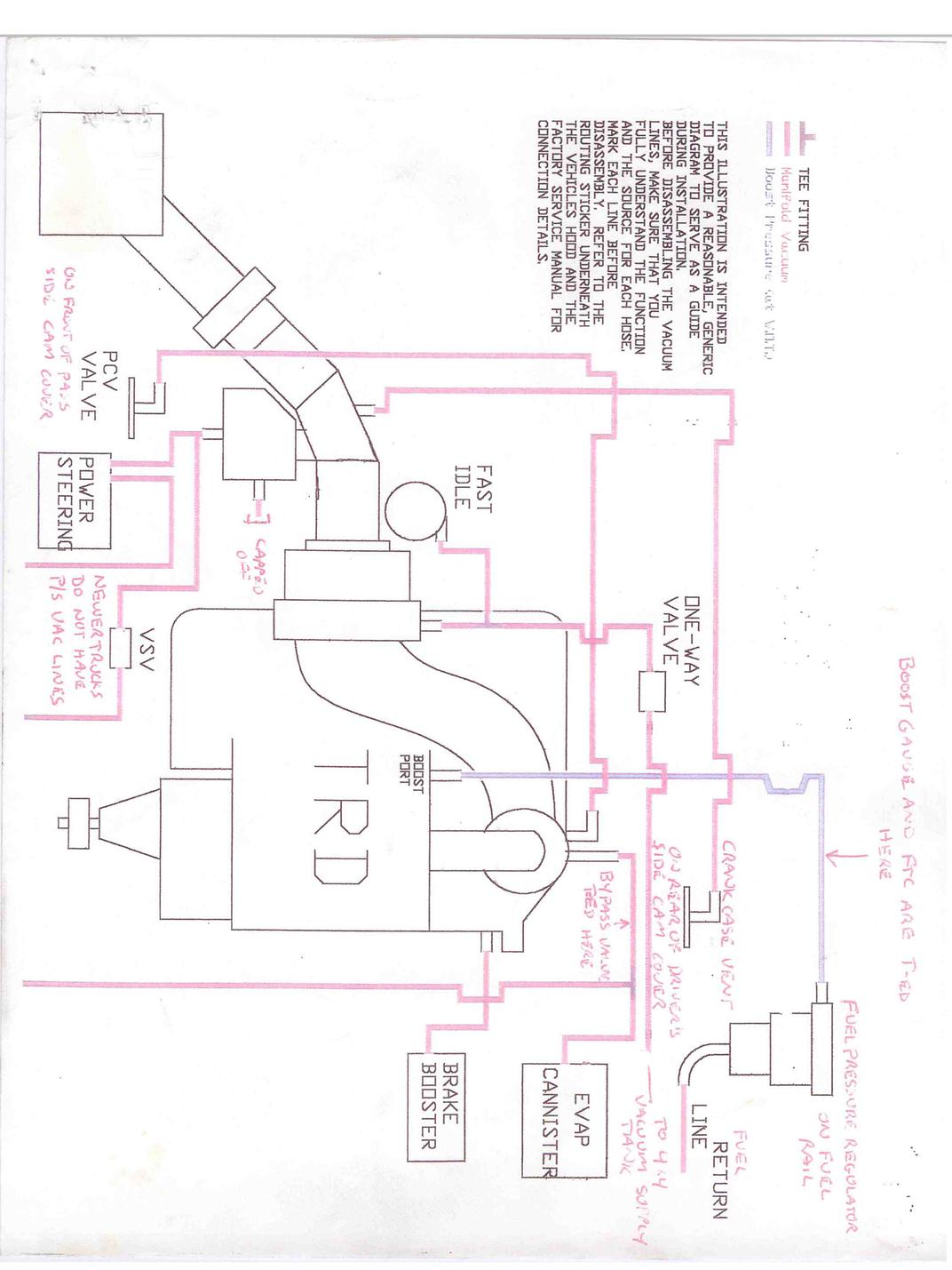

Is there any chance of you making one appropriate for the first gen supercharger?
Can't even find Google images for one, but I know they came with one...

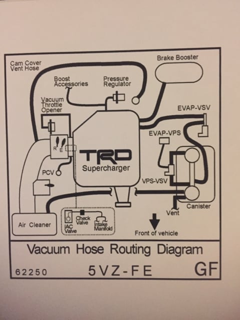

Yeah I'm sure I could but I would need an idea of what it's supposed to look like. Even hand sketching something would work. Is the first Gen SC that much different image-wise?

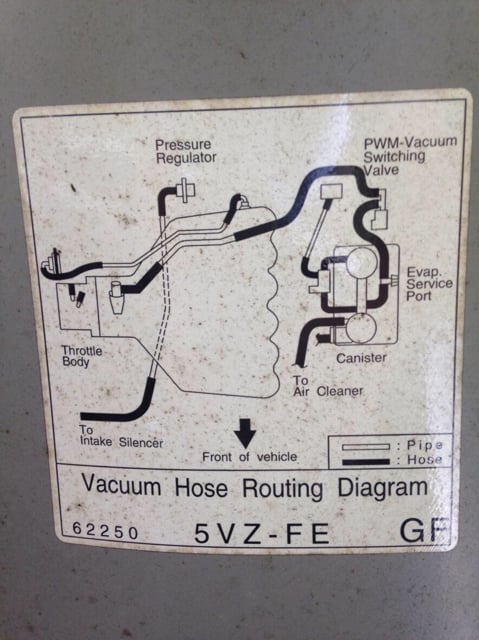

Basically the only diagram I've ever even seen for it was likely not an original trd image, and had even been highly modified from it's own original form with notes and revisions... And even then... Doesn't match the equivalent of what I have... LoL
But here's what I've seen before.
Basically the only Dodd-Frank I've ever even seen for it was likely not an original trd image, and had even been highly modified from it's own original form with notes and revisions... And even then... Doesn't match the equivalent of what I have... LoL
Oh ok I see. The only major differences I can see are where some of the connections are. What I would do is just rearrange some of the connections. And I probably would have to make the sticker a bit bigger to be able to fit the 4wd VSV system in there if you wanted. I'd love to be able to draw out the whole sketch of the detailed supercharger but it takes me a long time. I would just keep the block shape the same as I did in previous posts. If you get serious, pm me a picture of your current underhood decal and I can work something up when I get time.

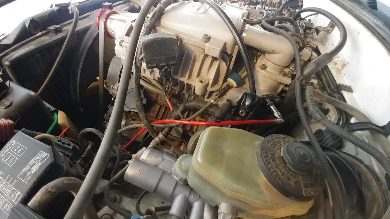

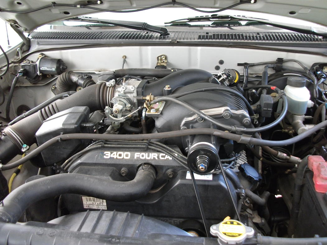

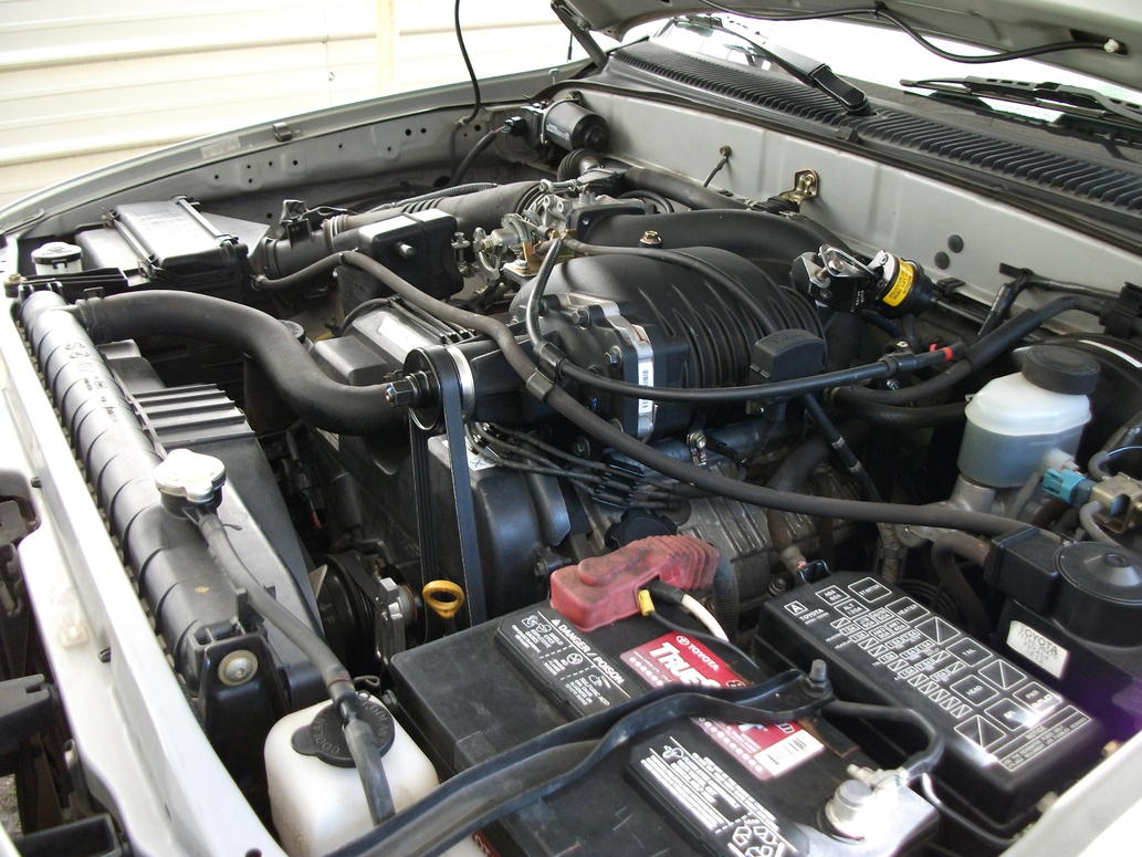

Here are a few pictures of my install.
Thanks Nick! It won't stay that way for long.

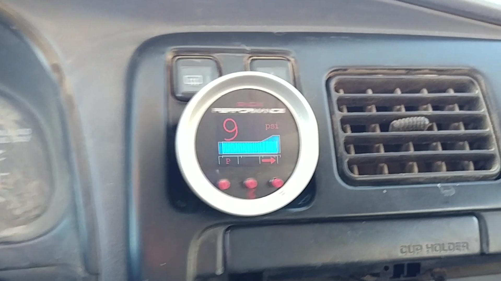

I was pushing 7 psi yesterday morning but only 6.2 in the afternoon. My guess is because it was cool in the morning with dense air and warm in the afternoon.
I would agree with your guess. I think 7 is like absolute maximum on stock pulley. What a difference though
