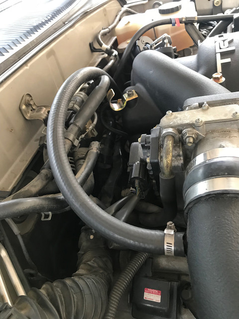

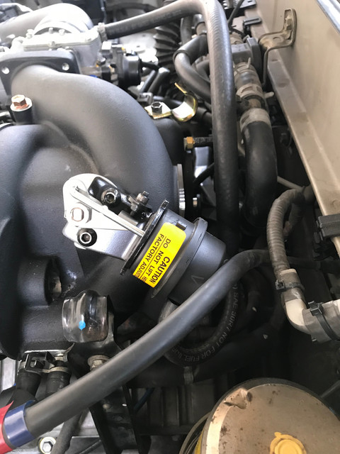

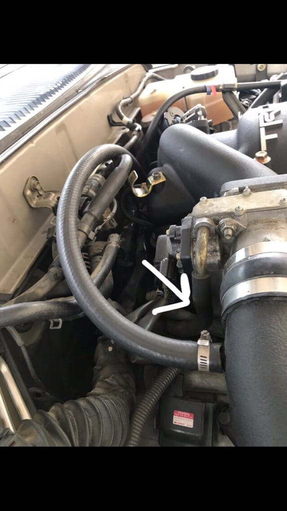

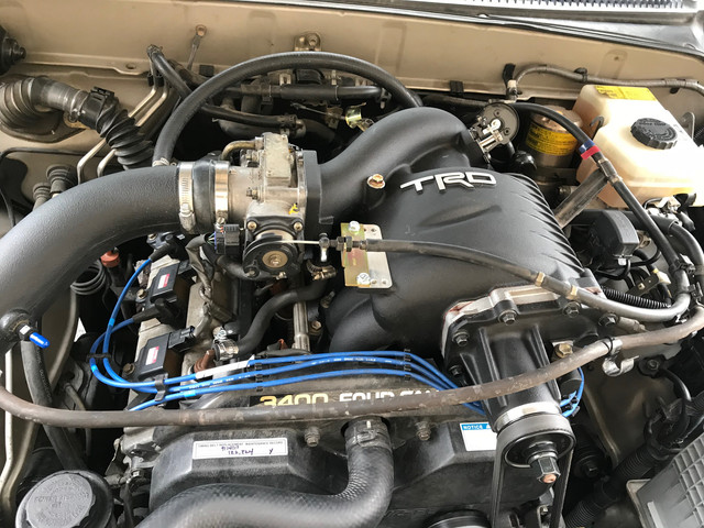

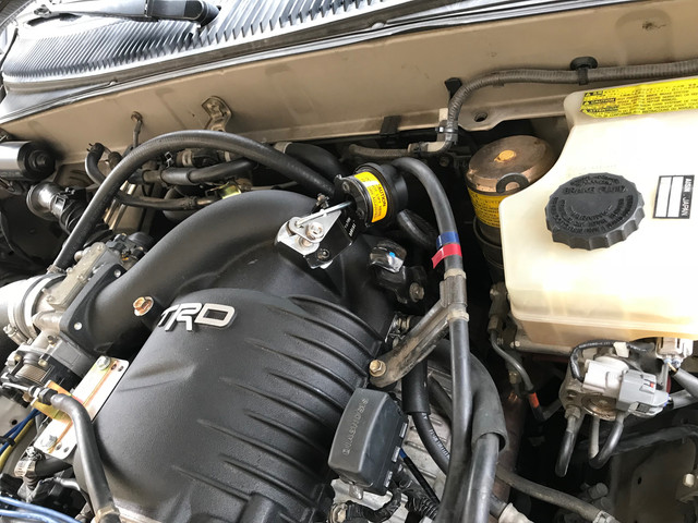

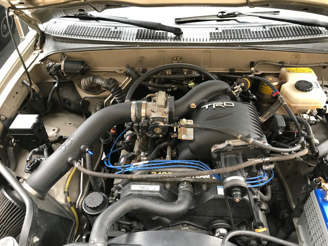

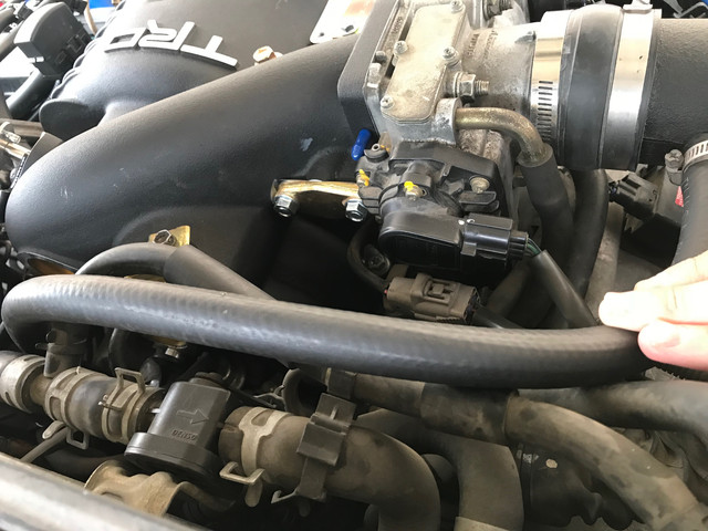

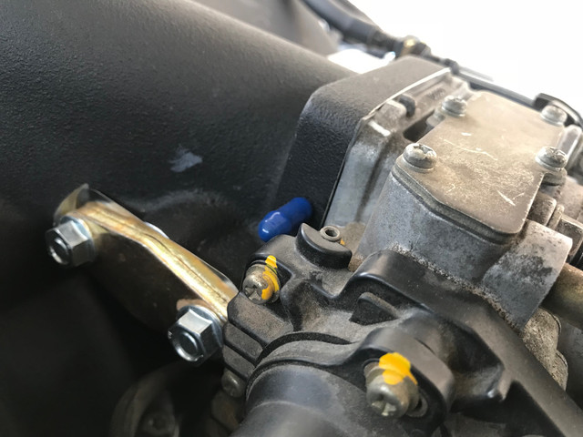

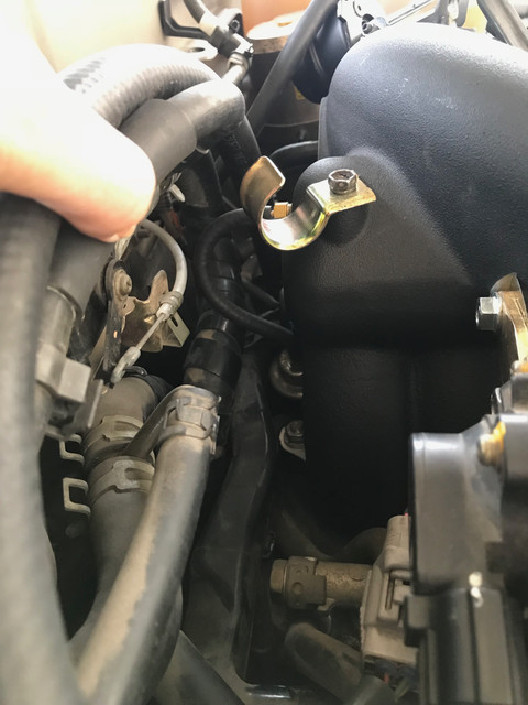

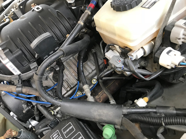

Alright guys, here are some pictures I managed to take before the rain hits. 2001 4runner 4x4 for reference. I did end up ordering the one way check valve. BTW, thanks for the overwhelming response guys. Keep them coming, I just want to drive the damn thing already without any worries.
Fairly certain this hose is the one in need of the check valve.
Someone with the newer style throttle body may be able to confirm
Your problem sounds like it's NOT SC related... Especially because you aren't throwing any codes typical with supercharger issues, and those pictures show proper vacuum hose routing.
