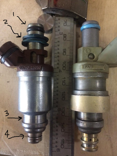

thought i would post up this pic, comparing the stock injector to the non-turbo supra.
you can see the stock one is about 6-8mm longer and the Supra tip requires the supra rubber seal (#4), otherwise the other seals (1,2,3) from the stock injector work.
stock injector is on the right.

I just put these in my engine today. I was running so lean with the headers and intake mods I've done that they were literally drop in & go. ECU has adjusted fuel trims perfectly. On stock injectors my LTFT's were at 19.5%. Now they are at -4.5%! Much, much better.

Great info. Any specific info on what year range/ drivetrain to look for when buying the injectors? I have been debating replacing/ upgrading my injectors at the point I send off my s/c to get it rebuilt at a shop.
