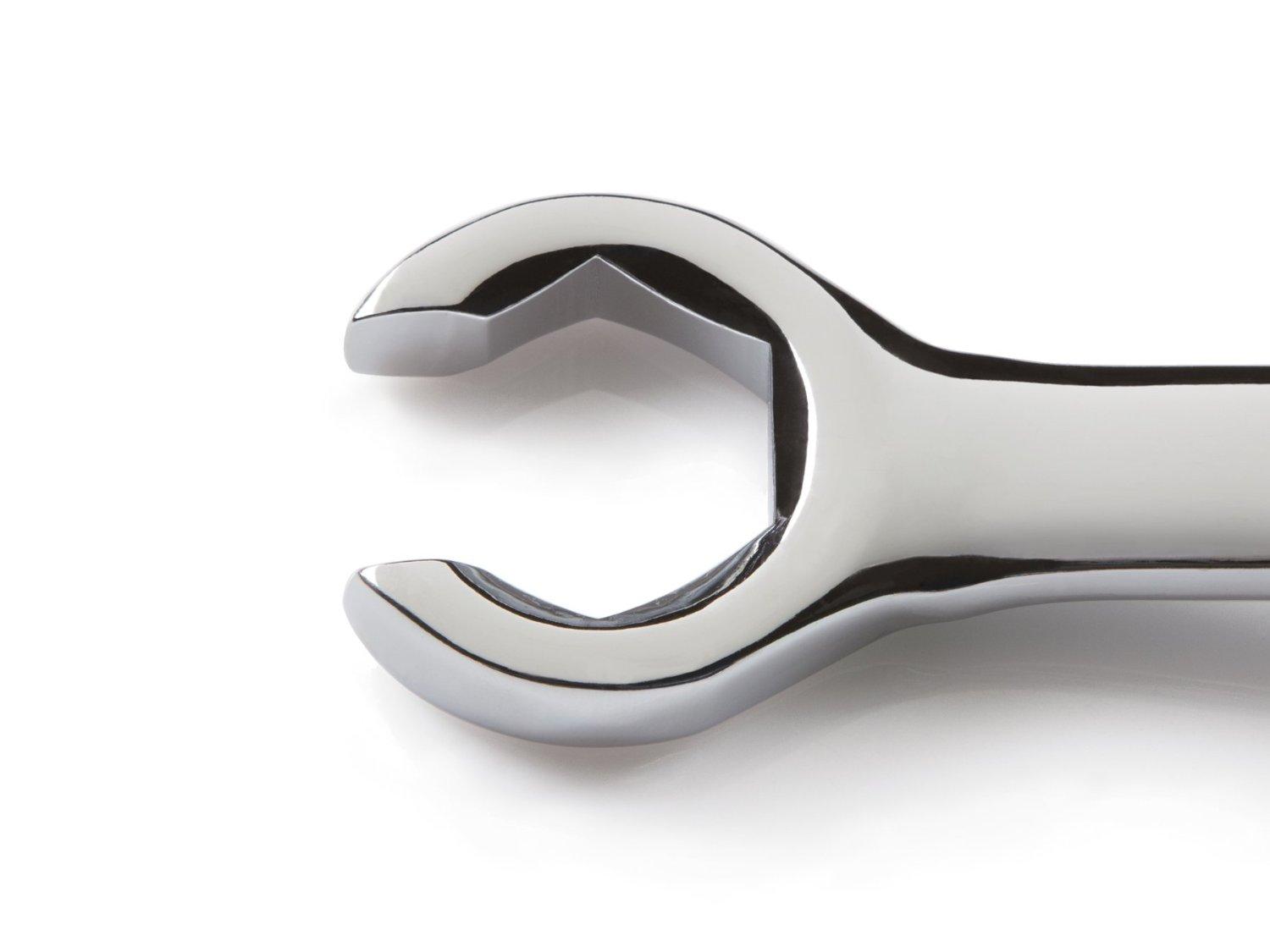

Fuel filter isn't that hard and can be done in an hour or so for the first time, just DON'T USE A NORMAL BOX WRENCH! Use only a brake line or crow's foot wrench or you are almost guarenteed to strip the compression nut.

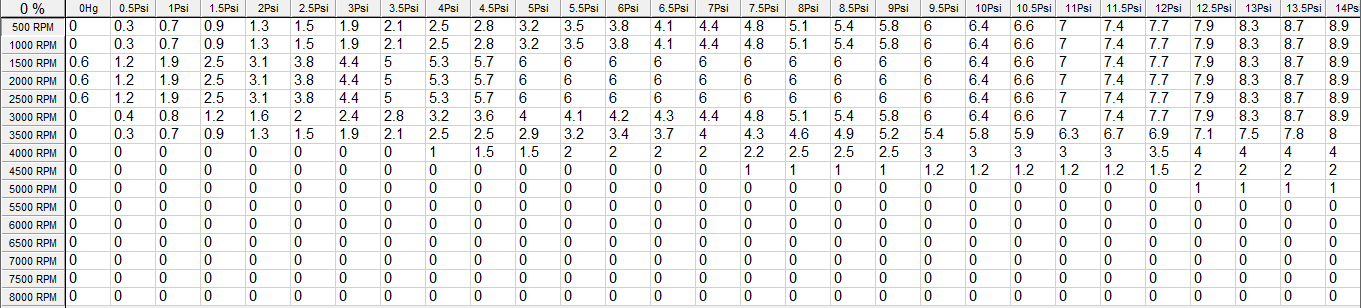

Here's something interesting that might help some people.
At first i had a hell of a time tuning this thing. I just couldn't get the ping out even with aggressive timing maps. That all changed one day when I decided to go WOT to check my AFRs. Somewhere in the high RPM PSI range I lost power. This was with the stock fueling on the 7th but I decided to just leave the high RPMs alone for a while until I could get some data logging equipment.
To my surprise the ping was almost eliminated in HG/LR. So I just drove around like that for a while. Until the other day when I punched it and got above 4k RPM. Now the ping was back. And I was even getting it in vacuum. I reset my ECU by pulling the fuse for an hour and used the same map I was using previously which was a pretty much base map with slightly higher values across the board.
Its better but still pings. I even went WOT as long as I could going up hills but couldn't get it above 4k without going over 90mph. Which I don't like to do because a ticket at those speeds is not good. However there is something to getting the RPMs up and tuning for the low end.
Gadget says because im fueled for lean out now and as a result the timing advances. Which makes sense but im also curious how the values in the timing map affects the low end. This is also stated in the U tune guide
A question i dont think anyone will ever know for sure is If you have too much or too little timing pulled up high how does that affect the way the ECU sets timing for the rest?

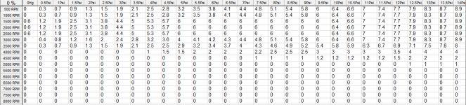

I also emailed SplitSec and asked for some maps because they told me that 5 degrees of timing was what most trucks need. But i was not sure exactly what that meant. I got a map which I was told was an example of that the ping happy trucks sometimes need. However it is preferred not to have to use this much. Its basically the base map with the 2000-3000RPM range modified to try and curb the problem areas. Heres what it looks like.
I do believe I have one of these ping happy trucks. Which is a huge bummer after all this money and a hell of a lot of time went into this. Hopefully I can remedy this. I suppose ill get a camera and take a look at the pistons, but i did get a MotorVac Carbon clean done before installing the S/C. Maybe it didn't do much to remove the carbon on the pistons.
