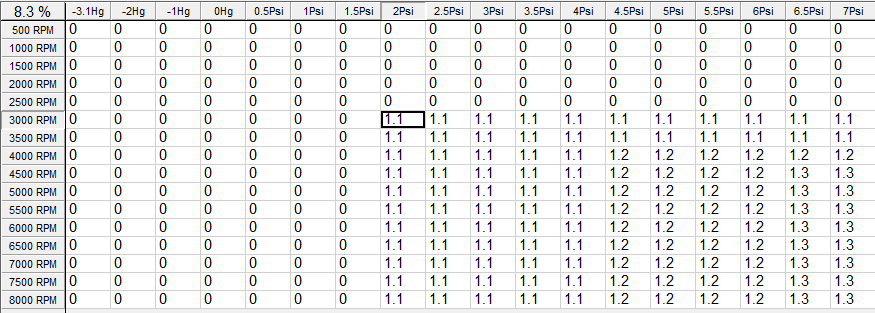

I really appreciate that dude. for as many people running the 7th there isn't enough info out there in my experience. SS really helped when they sent over their maps. They were very helpful in all this.
Just to note that is not the timing in running. Thats just waht SS sent me. Im gonna post my timing map for eveyone to get a good idea of what one can look like.

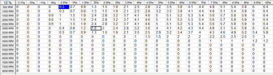

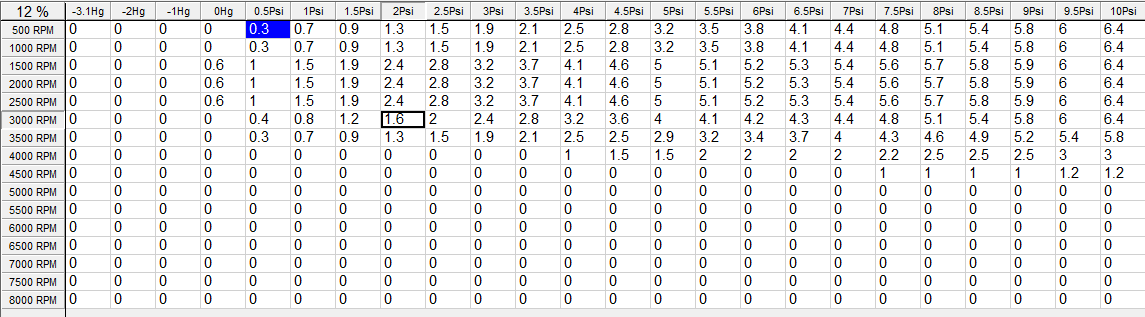

Heres My actual timing and The AFR map i just ran but took the AFRs down to 10. for no apparent reason.BEFORE 4k rpm. Overpressure is set to 1 psi right now

Yeah our timing is very similar. Fuel tho, mine goes down to a lot lower rpm and lower boost I think. My goal was to try and be at 11.5 any time I was boosted (1 psi or greater). So far, it's worked out fine. Probably too rich for some, but it's not a daily driver and I don't race car it unless I'm getting on the highway or pulling a big hill.

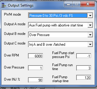

Alright. So I've been reading up on all this. It seems with the 7th injector you cannot tune closed loop. It comes preset to go to around 13.5 when it hits the over pressure value that is placed in the box. It will still tune the fuel out beyond that. So I don't understand how 4Reak Show can tune his AFR to come down so low in closed loop. It doesn't make any sense to me. Theres also a comment on another forum where Gadget cleary states the 7th is not for tuning closed loop.
If you do want to tune close loop you need the AFR controller from URD. This is stated in the UTune guide.
this was evident when I added fuel at a value of 1.2 in all the cells 2psi up to the stock map and down from 2000rpm. My AFR just stayed around 13.5 or so. Its just tuning out the extra fuel to stay at 13.5... or 14.7 the computer sees.
However. If you go into options then hit output on the R4 software you'll see an option for WPM mode. It comes just like the picture I've attached at 3 VDC or volts direct current. 3 volts on a AFR sensor is about 13.5. There is also an option for 2.5 VDC which should take you down to about 12.5 which I would be happier with. But when I selected that option and wrote it nothing changed. It must not be a working option on the AIC.
Speedy mentions this on his website. maybe he can chime in and elaborate a bit on what I just went over. if nothing has changed he cruising around in closed loop boost at 13.5. I just don't know how to add a users tag to let them know they have been summoned. If someone knows how please do. I don't think Gadget still comments but it would be good to get his word on this as well.
Yeah dude so there is tons of confusion on this system. I'll try and explain how I understand it. First of all, there are a few different variations of the 7th injector kit. If your vehicle has basic 02 sensors, then there is a URD kit that taps into cam and crank sensor signals (which allow to adjust timing) and the front 02 sensor signal (which lies to the main ECU to allow for fuel enrichment). If your vehicle has Air Fuel Ratio sensors which is like 99 or 2000 and above then the URD Kit alone will not adjust fuel appropriately. You need a different kit since AFR sensors work on principles of amperage not voltage.
I was told personally by gadget via email that my system (which is the 02 version) CAN and DOES change closed loop enrichment. In the same email he went on to say the "overpressure" setting is to tell the URD Kit when to start tricking the ECU to allow for that.
Here's a hypothetical scenario of my system's operation: it's at 2500 RPMs and I start to punch it so my boost pressure is at 2 psi. My URD Kit is set to 1 psi, so it activates and begins turning on the 7th injector. It simultaneously takes the now overly rich 02 signal voltage and skews it to a more acceptable voltage and sends that acceptable voltage to the main ECU. Meanwhile, it also takes the Cam and Crank sensor signals and delays/modifies accordingly to slow timing down, yet again relays an acceptable value to the main ECU. Result: the main ECU thinks the 02 is running fine, see a perfect Cam/Crank correlation, and doesn't know we just added a massive amount of extra fuel via the 7th, and also tricked the main ECU into sending its spark later (retarded timing) by delaying the cam signal.
That's my understanding. I could be wrong but from a software, mechanical, and electronic stand point that makes the most sense to me and that's how I would build this system.
Again, if you look under your hood at the emissions label it will show you what your vehicle has. It will have a list that says "SFI, EVAP" etc and it will then either have "HO2S (2)" (standard oxygen sensor, and closed loop tuneable) or it will say "AFR" for Air Fuel Ratio sensor which is tuneable with a seperate URD controller.
Hope that helps.
