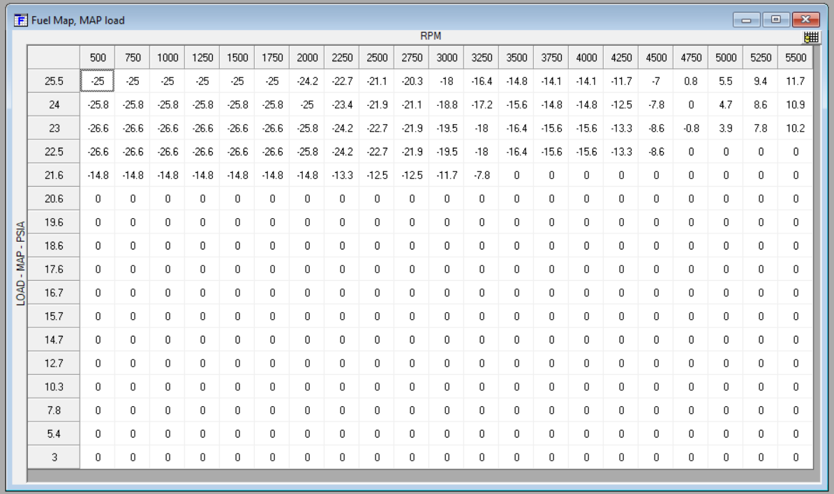

Here's my fuel map so far. I haven't changed anything on the O2 table yet.
Is that in % mode? You have too much fuel under almost all settings. I bet your Long-term fuel trims are in the -10% or -20% range.
If you click on my build thread in my signature, I have notes on how I tuned my 4Runner. I realize I don't have a photo of my fuel trims, I'll add that soon.
First off, your table needs to be re-scaled. The max PSIA you will see with the 2.1" at sea level in 11.5 PSI, so that's 26.2 PSIA. However, in 1st gear the 2.1" makes about 9.5 PSI, in 2nd it makes 10.5 and in 3rd it makes around 11-11.5 PSI so take that into consideration. Second, unless you have a manual, you should never see above 5500 RPM. Manuals should never see above 6500... but you really shouldn't rev it over 6000 ever. Double click on the cell row and columns to change the end, then select all and "Calculate" to smooth it out. Here's my O2 sensor table for reference, note the row and column headers:
This is a great starting point for the O2 sensor. This is in voltage offset mode, so if you use this be sure to set it as such in the Setup screen. The -.479 you see in the corner was just a reference (cannot ever use that cell) since that value is an exact 12.0 AFR on my rig. -0.484 gave me 11.8, which is what URD says is the optimum AFR ratio for these engines at WOT.
The stock ECU will de-tune any fuel you add on the fuel table. It'll be fine for a week or so then you'll notice it going back to 14.7 AFR on everything except closed loop (closed loop kicks in around 75% throttle or 4000 RPMs). I'll post up my fuel table to show you what I mean.
EDIT: Here's my fuel table attached at the bottom. I have methanol injection so I pull full up top until high RPM's. You'll have to do the opposite, but see how I don't touch a single fuel trim until 7ish PSI. The O2 sensor skewing does all that, you can't do both at the same time very well.

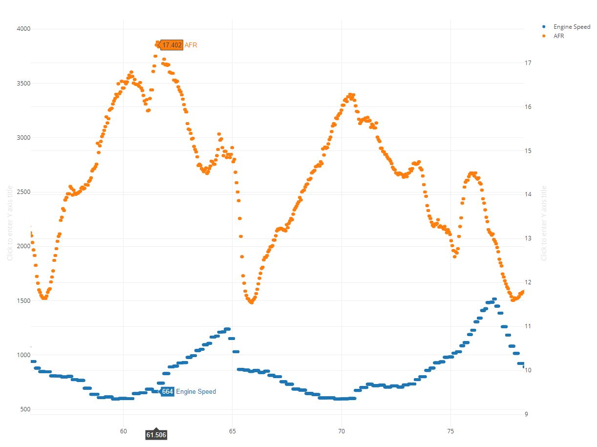

After testing today I'm pretty sure I have the narrowband sensor. I saw it jumping from ~0V to ~0.7V when the AFR was around 14.7. I tried two of the same sensor to make sure and had the same result with both. There are still two things I can't seem to figure out.
1. In setup, I have my low voltage set to 0V and high set to 1.11V. I can't get the AFR below 12.2 even when subtracting the maximum allowable voltage. I'm testing in neutral with the engine at 2k RPM. I made the changes in the cell being used as well as the surrounding cells to avoid any interpolation issues.
2. I still see a spike in AFR upon initial throttle application. The graph below shows what I'm talking about. I start to apply throttle, and before the engine speed increases, the AFR spies. The spike can get up in to the 20s at times. It feels like the engine stutters before taking off and causes the whole vehicle to lurch. I'ts been so bad that I've actually stalled twice trying to make low speed maneuvers in a parking lot.
1. Turn on the "High Level Drive" option in the Setup screen. This will amplify the AFR changes you can get with the voltage offset.
2. Ok, that's not normal. Sounds like you could have a vacuum leak though, allowing unburnt air into the system. Or possibly an exhaust leak upstream of the front O2 sensor (or at the sensor itself). Actually, a vacuum leak could also be messing with your first issue of only a 12.2 AFR.

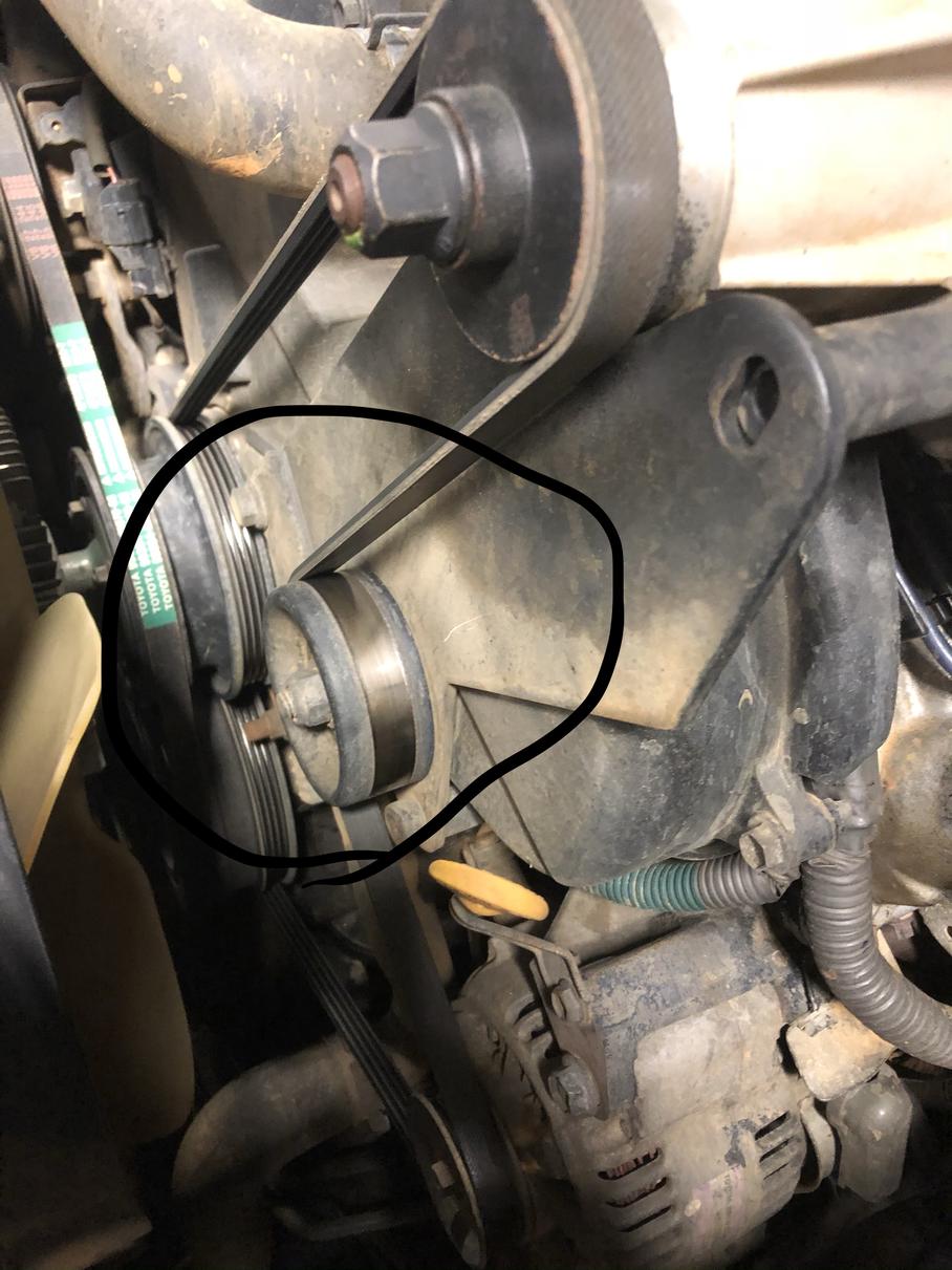

Does anyone have the part number for the idler pulley underneath the supercharger snout pulley? Mines roasted and making a TON of bearing noise.
