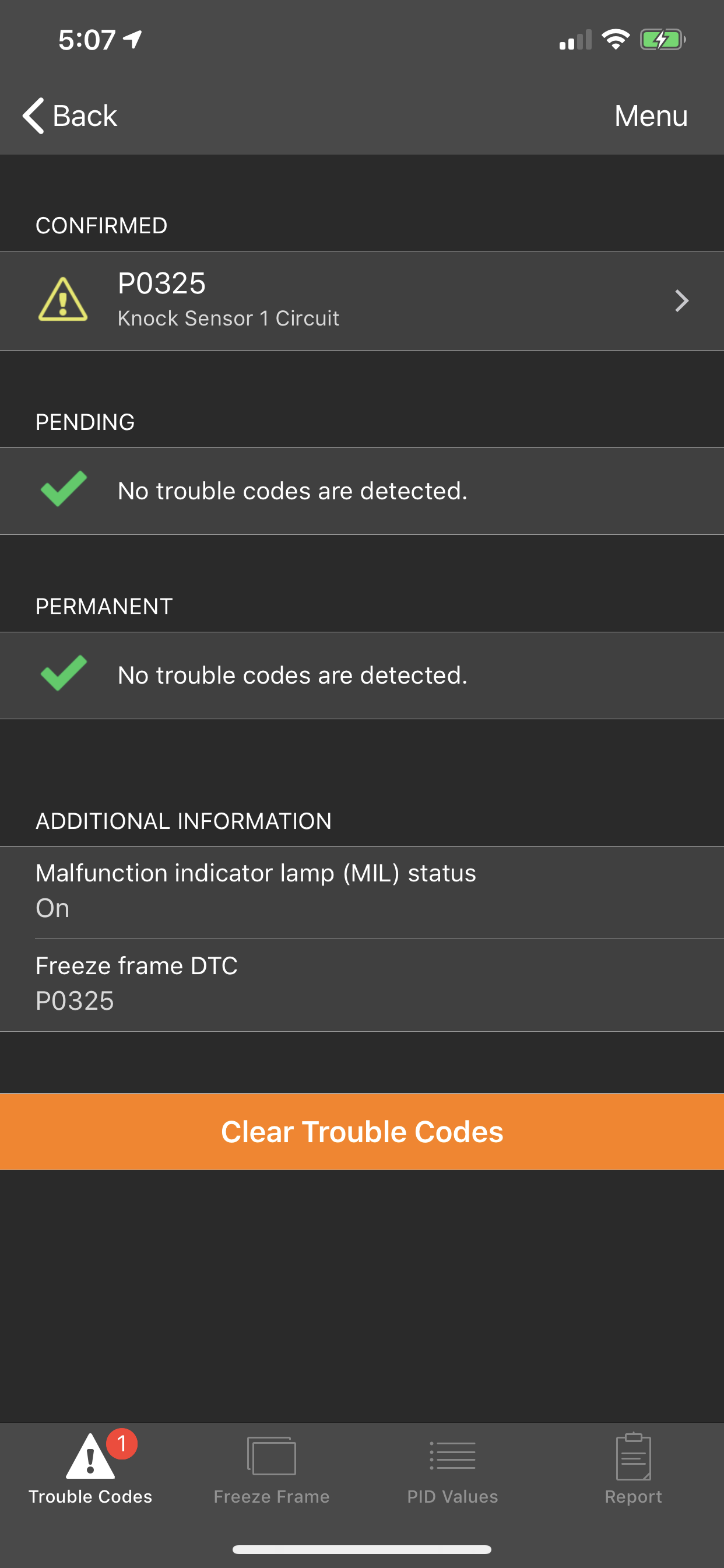

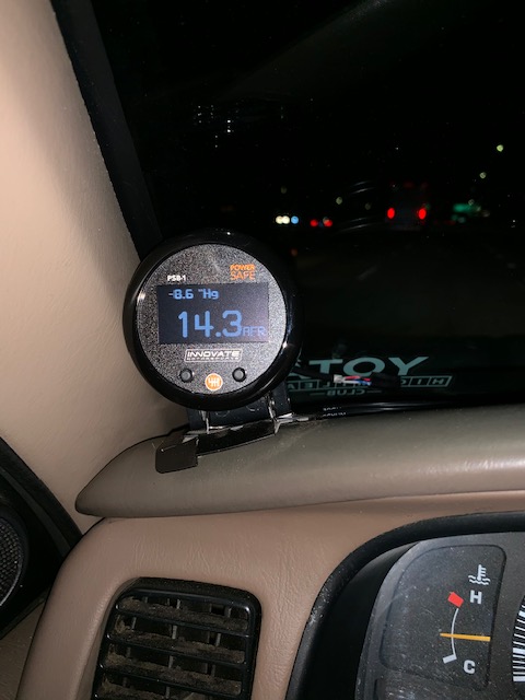

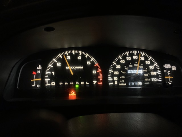

ok SC Gurus,
Just got my runner back from installing the 7th injector kit but its throwing a check engine light for the knock sensor and shes running rough like if its in limp mode. Could that be the culprit from keeping the vehicle from running great? Brought it back to the shop for them to replace both sensors and harness. I'm wondering if there's anything else that's going to keep it from running perfect.
your help is appreciated.

The limping is a telltale sign that it’s indeed a sensor or harness. It’s your cars way of keeping it out of the high rpm range where the knocking is likely to occur.

It seems that as more and more people are installing superchargers on these 4Runners which are getting older by the day, more are encountering knock sensor issues. I think the brittle harness wires are to blame for most of the woes.
Someone correct me if I'm wrong (I have not installed the URD unit) but I do not think it interfaces at all directly with the knock sensors, only the crank and camshaft sensors to pull timing. A knock code should indeed only mean that the knock sensor and/or pigtail needs to be replaced. You mentioned you just got it back, if a shop did it I'd send it back and let them know the CEL light is on.
thats good to know...crossing my fingers thats the culprit so i can be all smiles after this. thanks

yeah just got it back the shop was aware of the code when i first dropped it off but they reset it after they installed the URD kit and it didn't come on when they drove it around for testing which they said was very little cause of the weather lately. Like I mentioned above, I hope that's the culprit so I can be all smiles after this.
I found a couple people having issues with the sensor and SC in the past when i did a quick search but none ever came back if it solved their issue. Ill report back when i get the runner back from them. Thanks again.
My knock sensors went bad shortly after installing my supercharger too. Not sure why this happens. Definitely replace the sensors and harness.
Exact same issue here, had a P0325 code for a while now (S/C and 7th kit). I'm planning on getting a timing belt change soon so plan to change both sensors and harness at the same time.
