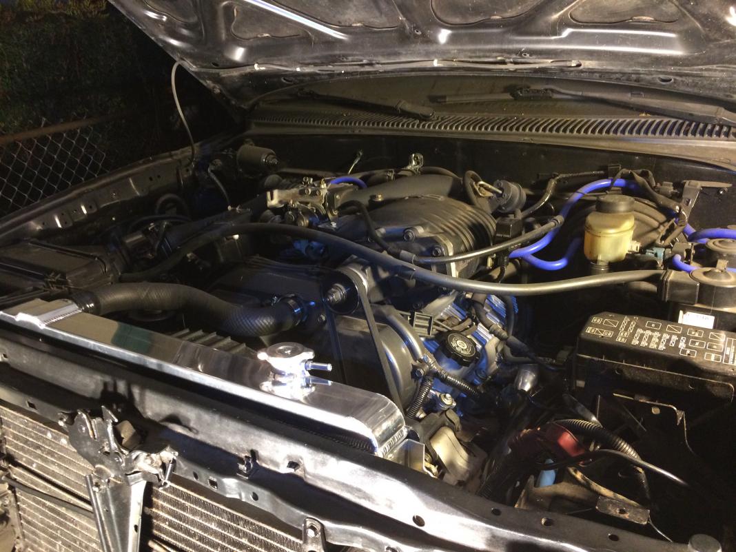

326k miles. Engine runs perfect. Supercharger has been rebuilt once before. I am all stock and run 91 octane only. I replaced the spark plugs and fuel filter at the time of the supercharger install and I have yet to encounter and problems with pinging or anything like that.
<a href="http://s1371.photobucket.com/user/favianfloresfd3s/media/99352C05-E7D6-4A56-8C7F-CF22A0FF02CD_zpsnahnmgv7.jpeg.html" target="_blank"><img src="http://i1371.photobucket.com/albums/ag284/favianfloresfd3s/99352C05-E7D6-4A56-8C7F-CF22A0FF02CD_zpsnahnmgv7.jpeg" border="0" alt=" photo 99352C05-E7D6-4A56-8C7F-CF22A0FF02CD_zpsnahnmgv7.jpeg"></a>
Question! where did you plug the PVC pipe vacuum hose into and what about the open port in rear of the supercharger. I have an 01 with the same SC and trying to get the vacuum hoses correct.
I routed it behind the superchrger and it plugs into a port near the brake master cylinder/ brake module thing. As far as the ports I just used simple vacuum plugs for the ones I did not need. I plan on installing a boost gauge soon and I will use that port. I can try to get some pictures tomorrow when it light out
Boost port should be plugged into the top of the fuel pressure regulator (FPR). It gives you a tad bit more fuel pressure which helps at heavy throttle conditions. When you add a boost gauge just add a t fitting to it but keep it on the FPR.
