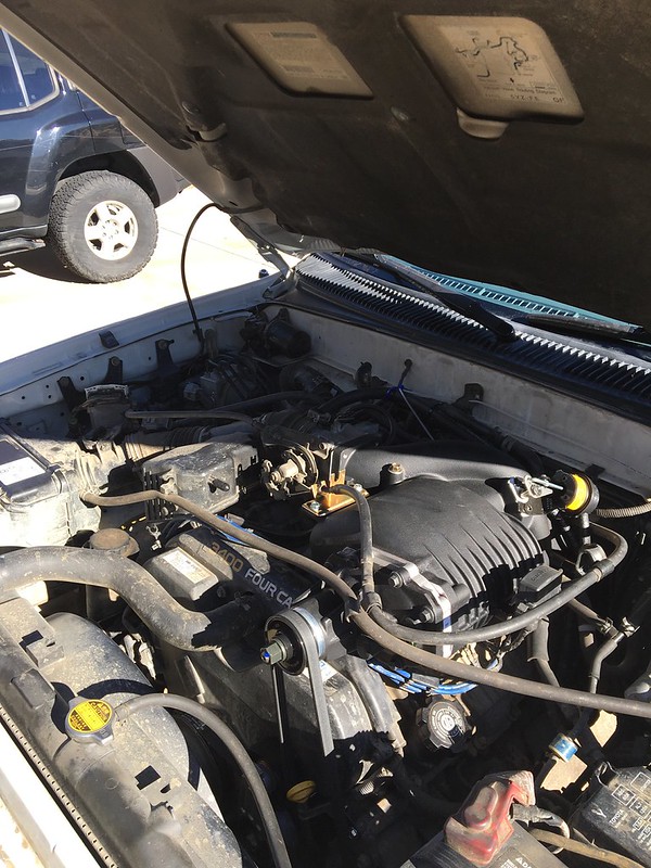

Installed Brand New Magnuson Supercharger @ 126K miles
I just wanted to share some pics and a quick video following the install of my new Magnuson supercharger. Purchased the unit from URD and picked up some Denso IK22 plugs to install with it. Also, cleaned the MAF sensor and reset the ECM to help it relearn the fuel trims with the added boost. The ECM seems to be catching on as the power delivery is getting smoother and smoother. Have not done any supporting fuel mods yet since I live at 5800 ft and I think I should be ok with the stock pulley and 91 octane. Super happy with the new-found power and drive-ability that the supercharger brings.
Excuse the somewhat dirty engine bay:
4Runner Supercharger by https://www.flickr.com/photos/140393666@N08/, on Flickr

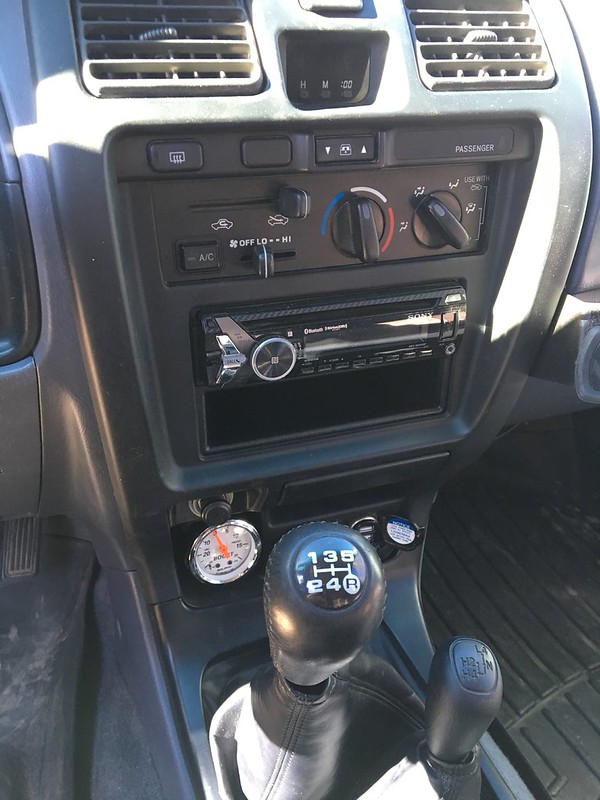

Installed an Autometer vac/boost gauge:

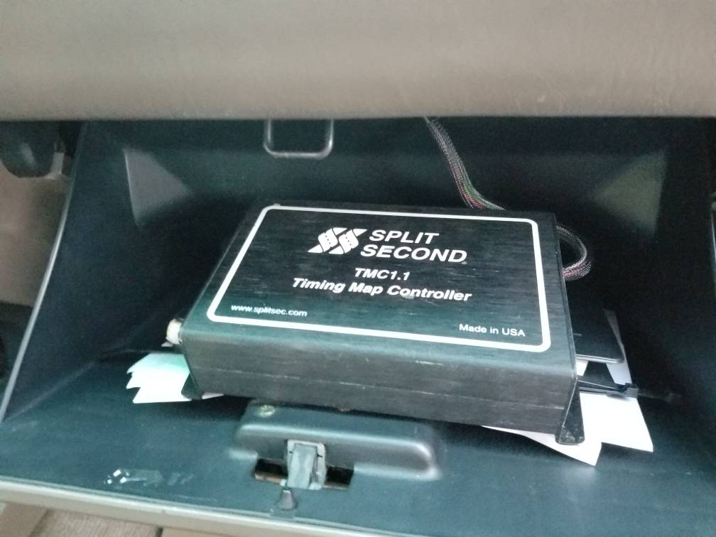

Well I ended up installing an old Split Second TMC1.1 box on my 4runner today. Previous owner had it and just gave it to me.
Called up split second last week... (very helpful, even emailed me the installation instructions for my specific 4runner '98)
Installed it today and no more pinging!!!
Ended with adjustment dial right between 1st and 2nd marks.
It's old school but I didn't have to spend any money on it. LOL
So now I'll save up for the 7th injector kit and not worry about it until then. [emoji16]
