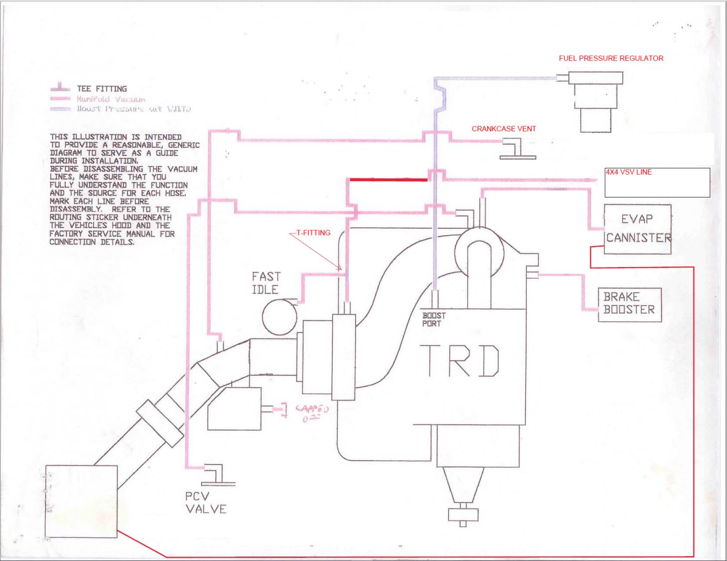

For those interested in vacuum hose routing for the 1st gen Supercharger, I modified the heck out of the one on the net currently. This is simple and hard to mess up.

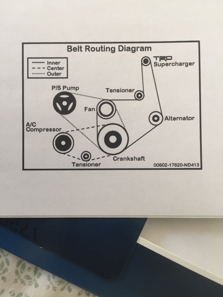

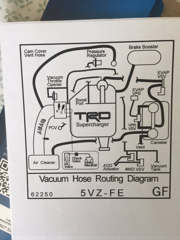

A bit off topic but this is the place for it: thanks to [MENTION=174573]krutoydiesel[/MENTION] for some behind the scenes assistance in the completion of the 1st generation TRD supercharger vacuum label sticker for under the hood.
This version with the AIRAID intake.
[MENTION=73567]alphyn[/MENTION] I'm lookin at you since I know you have a 1st gen SC...
I don't remember if I informed the folks of the updated, significantly more complete and more accurate belt routing diagram label either. It includes all 3 belts instead of just the SC one.
