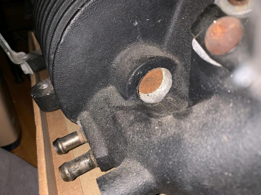

here is a pic of the back of mine.
you can see the back of the bearing. looks like it could be hammered/pressed out.
the other bearing would drop out the back into one of the intakes?
Mine has that same plug on the rear, there is also one over close to the throttle control. Not sure how much easier it will make changing the bearings with those out.

i'm confused about these "plugs" you speak on the backside of the bearing..
isn't that just the back of the bearing you can see?

On my supercharger, you cannot see the back of the bearing completely. Instead there's large brass "plugs" that look almost like something was capped off.

Those plugs are likely core plugs. Similar to "freeze plugs" on an engine. Just smaller. So you would need to have replacements on hand of the right dimension since they will be destroyed to be removed.
