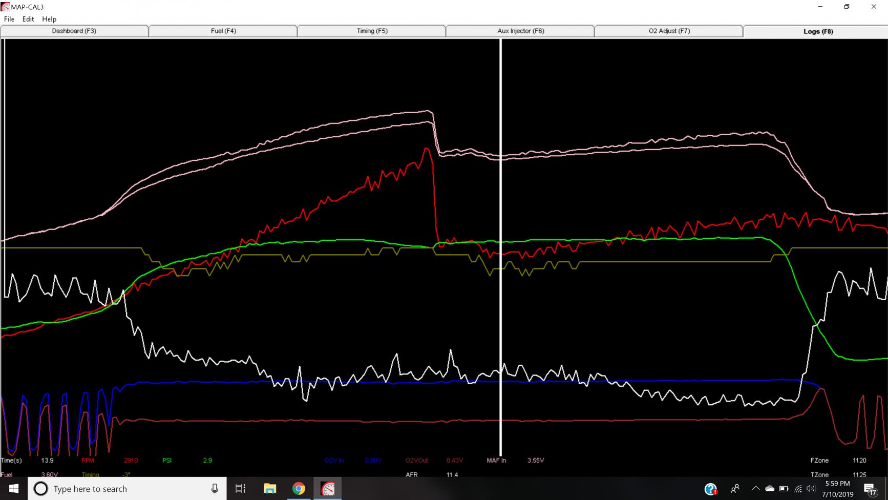

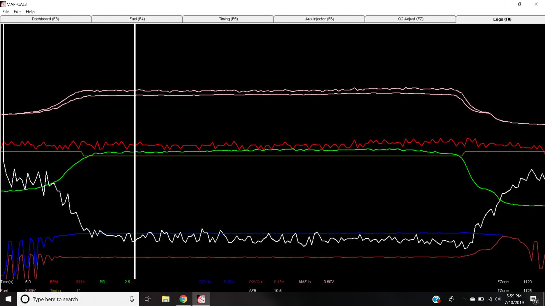

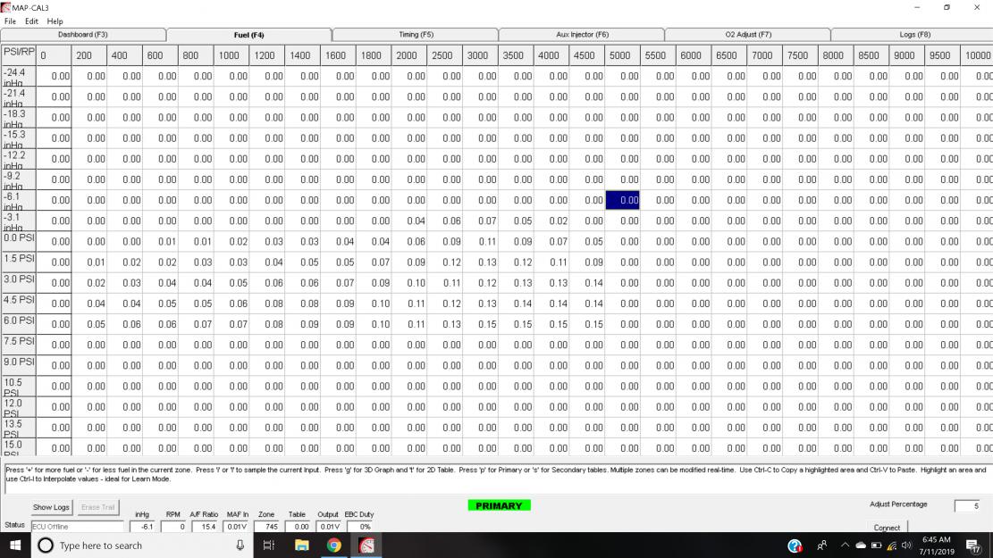

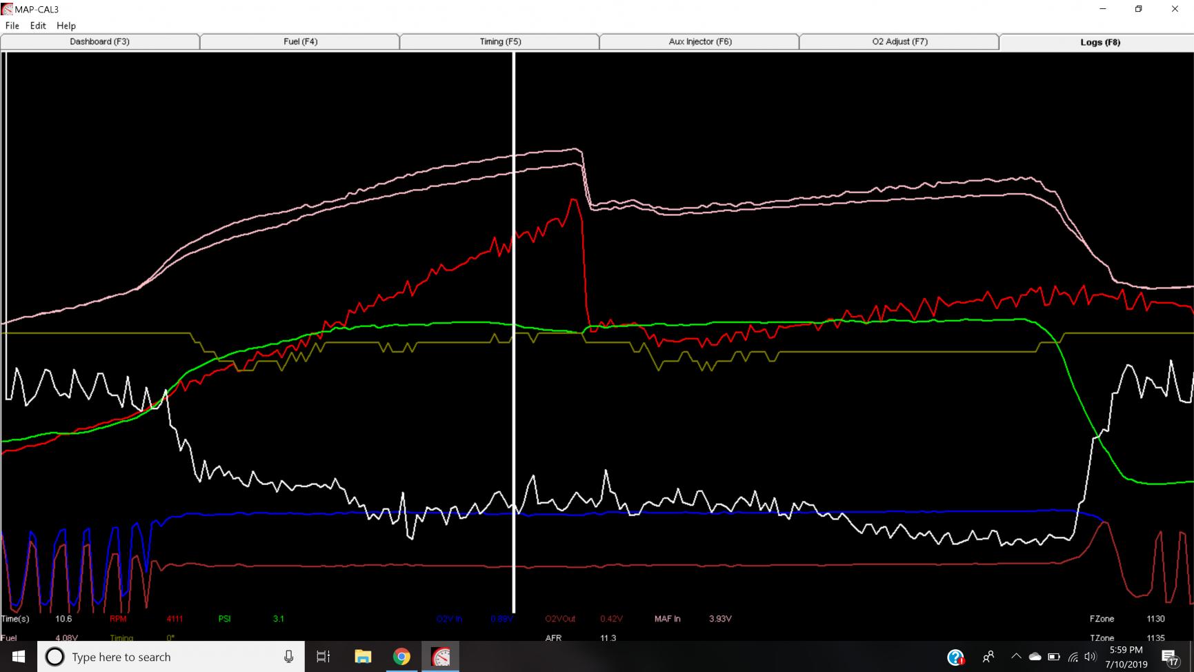

Hoping someone can offer some insight here. Cough [MENTION=115347]gamefreakgc[/MENTION]... Im attempting to nail down my tune for the supercharger right now and am running into some issues. I am using a mapecu3 hooked up in the MAF intercept mode. Issue I am having is for the first few days that I run a tune I can get the truck to run amazing, afrs in the low 12s and high 11s no ping and lots of power and fuel trims at +-5. 3 days down the line though the truck will very quickly go from running like a top to running lean under light boost and pig rich under high load and boost, Im talking like low 10s for the afrs and I can feel it bog hard. the fuel trims also go through the roof. This is all in closed loop too.
I attached a few pics of my logs to give some data points and hopefully to help paint a decent picture of what is going on. The issue I am having is what causes the sudden drift in the tune and the stock computer fighting it so hard. Looking at it when under boost my O2 input to the mapecu is showing around .9 volts (rich for a narrow band) and the output to the stock ecu is .45 volts which I have read is pretty much dead on at stoich, so this is telling me I have the right o2 skewing dialed in. This will net me the AFRs i want which is in the low 12s, but then looking at another pull it will have near identical o2 values and MAF values and yet the afr tanks to the low 10s, so what gives? Ive got the tune pretty dialed I just need to figure out how get the computer to hold it so any input is appreciated. Right now I am resetting the factory ecu again and leaned my tune out a touch and will try again tomorrow

Yeah, it's running rich alright. I have 3 ideas to try:
1. I fought my AFR's for a while because I had half a fuel map and my 98 ECU hated when the piggyback sent a "0" value. For example, I had fuel trims set at a negative number which would transition to a positive value. Any time it hit "0" it went nasty rich and then would flip-flop and pull all fuel and go lean. You might be experiencing the same thing. Can you post a screenshot of your MAF or Fuel map?
2. Pull your EFI fuse and give it a spin. Does all the fuel trims go back to normal and AFR's are good? If so your tune isn't holding.
3. Record your Short-term and Long-Term fuel trims when the tune is good and when it goes bad. What values is it giving you? Will tell you if it's an O2 skew issue or fuel/MAF tune issue.
The O2 sensor on a Toyota is like the One Ring, it rules all other sensors with an iron fist lol.

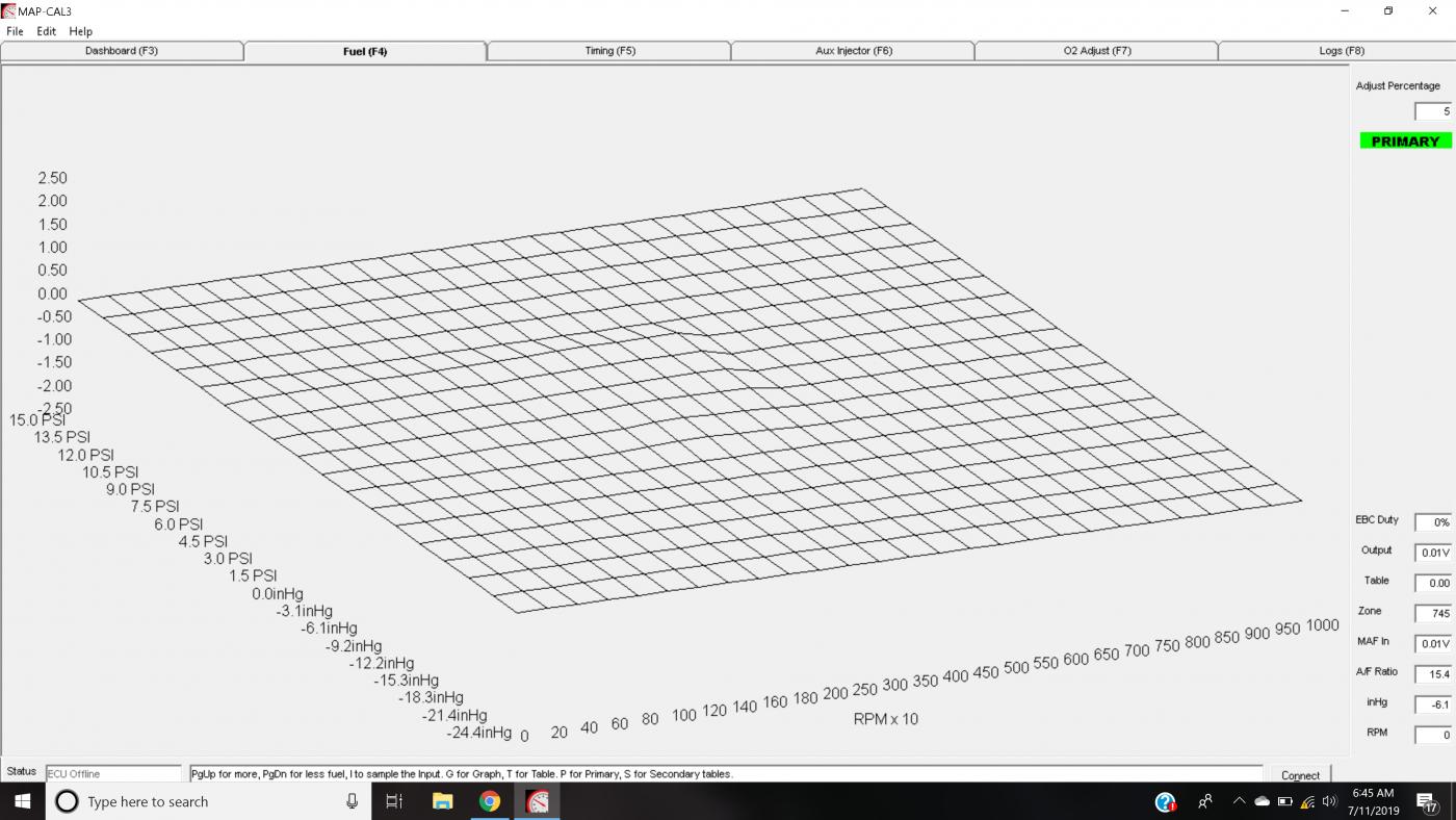

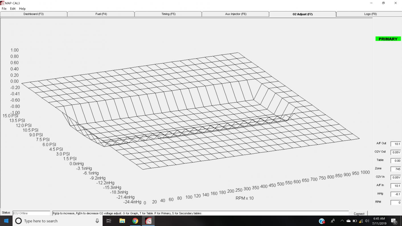

So here are screenshots of the fuel and O2 skewing maps both in graph and table form. The fuel table values are chnging the MAF signal that the stock ecu sees. So a value of .20 would add .20 volts to the incoming maf signal
Pulled the efi fuse last night so well see how it runs this morning and Ill report back.
When the tune was running good the short term and long term fuel trims in boost were near zero except for a few random spots where it would spike to +12 or -15. Once the tune goes bad though even when cruising in vacuum the fuel trims will be all over the damn place. Ive also noticed sometimes at idle for some weird reason the fuel trims will all of a sudden spike to -21 and it will lean way out untill it stalls. Im sure this is related but as you can see my maps dont have any values in the idle range where it would be doing this.
Ill do some pulls this afternoon and get some better data logs about what the O2 voltages are and the fuel trims.

A few things:
1. Fill out your MAF skew one more row and column. Normally a cell will average out the cells surrounding it, so if you hit 6.0 PSI at 4500 RPM, it may not actually send a signal of 0.15, it may be lower. So build our your tunes to 5500 RPM's and 7.5 PSI for a stock pulley.
2. Try running closed loop with only the O2 sensor map. I suggest saving your tune you have now, copy the file and zero out the MAF map 4.5 PSI and below. See if the tune stays longer.
3. Is there a reason that at low PSI, you are adding more fuel at 3000 RPM than at 4500 RPM on the MAF? That might be why it's rich.
4. You may not need enrichment in vacuum. Also up to you if you need it at 0 PSI, since that one does affect your MPG's a bit.
A few things:
So bit of an update, I zeroed out the maf table and redid my o2 map to be more gradual. I reset the ecu and now have about 40 miles on the tune and it appears that its holding. It seems like I need to let the ecu creep up on the afrs I want rather than making it happen right away. If I force it to go there it eventually catches up and goes even richer. The way its tuned currently I hit the mid 13 AFRs by 2-3 psi and by 4 psi I am into the low 12s where it holds steady there up to 5psi which is where Im maxing out. Well see how it holds over the next few days but I have a decent feeling about it this time.

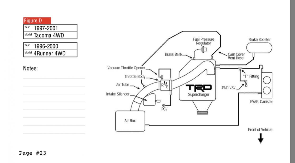

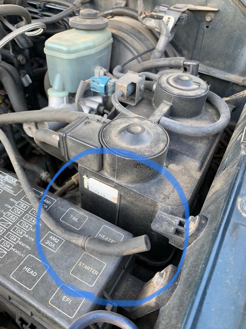

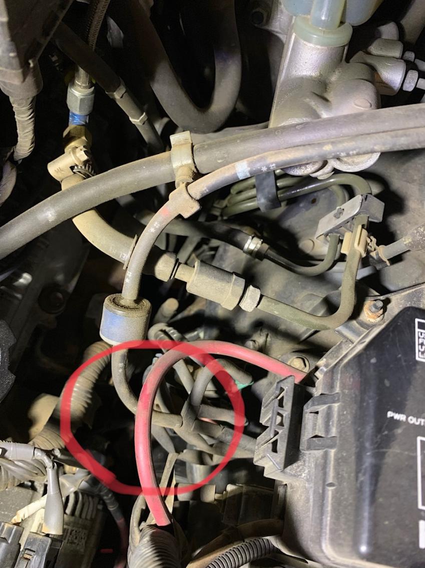

Every since I got my 7th injector kit installed my 4x4 hasnt work. I was thinking maybe the shop disconnected something and didnt reconnect after installation. I bought my SC from a friend but apparently he didnt give me all the parts
I found this little guy which I think is the culprit to my 4x4 not engaging.
I see it connected here but not on the other end.

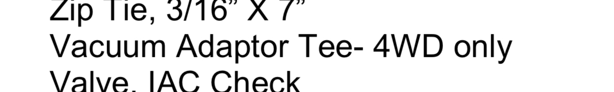

So i checked out the install instruction on the SC group on FB and noticed that I need this Tee for it
Does anyone know of an alternative way to connect this or the diameter Tee I need that I can find at Home Depot or something?
Mine is connected to the same vacuum port that the vacuum throttle opener is connected to. Works like a charm and no need to find a off sized t fitting since the vacuum opener and the 4x4 vsv use the same diameter pipe
