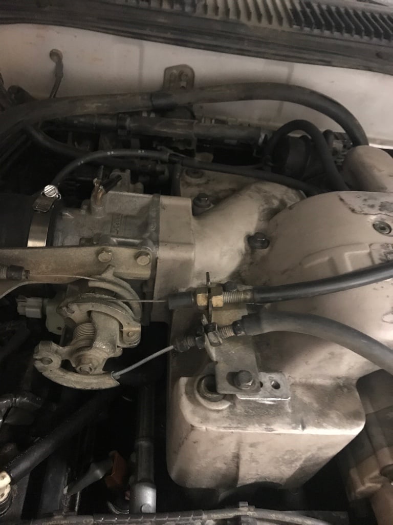

Alright so someone else has had to had this issue
Tranny cable is too short.
Is there a part number for a longer one?
Not really any possibilities for rerouting it.
Re-route it. There's only one length. It won't fit completely in the bracket like it used to before the supercharger, un-clip it, bolt it in and then clip as much as you can back in.

I undid the bracket near the tranny and kinda wiggled it on the side of the engine to make it work.
I did this
One 10mm bolt and un clipped the top clip pulled upward and got even a lot more slack than I needed.
I had to max out the adjustment, I guess I could pull it back down but I left it and was even able to put the bolt back through the bracket as if nothing had ever been touched.

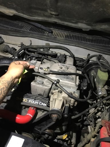

So my PO171 check engine light issue has been resolved. There is a nipple on the back on the supercharger, right near the throttle body that I simply couldn't see once it was installed that I didn't cap off. For the 99 there is no vacuum line that should run to it and I just couldn't see it. So a quick capping and we're good.

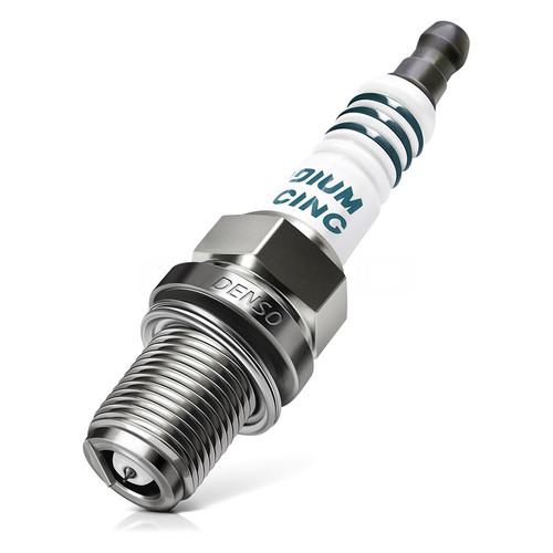

Also, has anyone tried using DENSO Iridium racing plugs? They have a super low profile and don't block the spark like the IK2X's. Their little dyno graph shows a 1.3% increase in power but that's on a 2-cycle engine so not sure. But they sure do look different:
