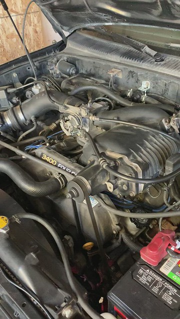

I'm reading the tuning guide and am super confused.
Question.. any good links out there aside from the U tune guide?
so far just concentrating on wrapping my head around the fuel part of tuning in closed loop. basically I'm trying to get my fuel trims as close to 0 as possible?
also when I read the U tune guide it says a value under 10 is leaning out the fuel mixture, but the base tuning map that was given has lower numbers in the spot I would need more fuel. IE in boost at 2500 rpm. the number is 8.9 which is lower than when it is in Vacuum at the same RPM 9.4
Should I remove my ECU fuse and reset the fuel trims. the FTC came with a pre loaded fuel map and i'm not sure if I should give the ECU a clean slate or leave it.
<a data-flickr-embed="true" href="https://www.flickr.com/photos/69731669@N03/51632305274/in/dateposted-public/" title="IMG_1924"><img src="https://live.staticflickr.com/65535/51632305274_7c314aa479_z.jpg" width="480" height="640" alt="IMG_1924"></a><script async src="//embedr.flickr.com/assets/client-code.js" charset="utf-8"></script>
