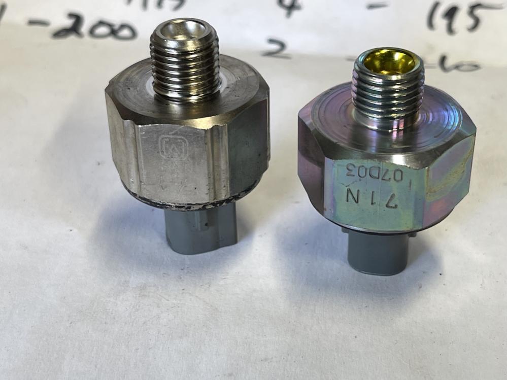

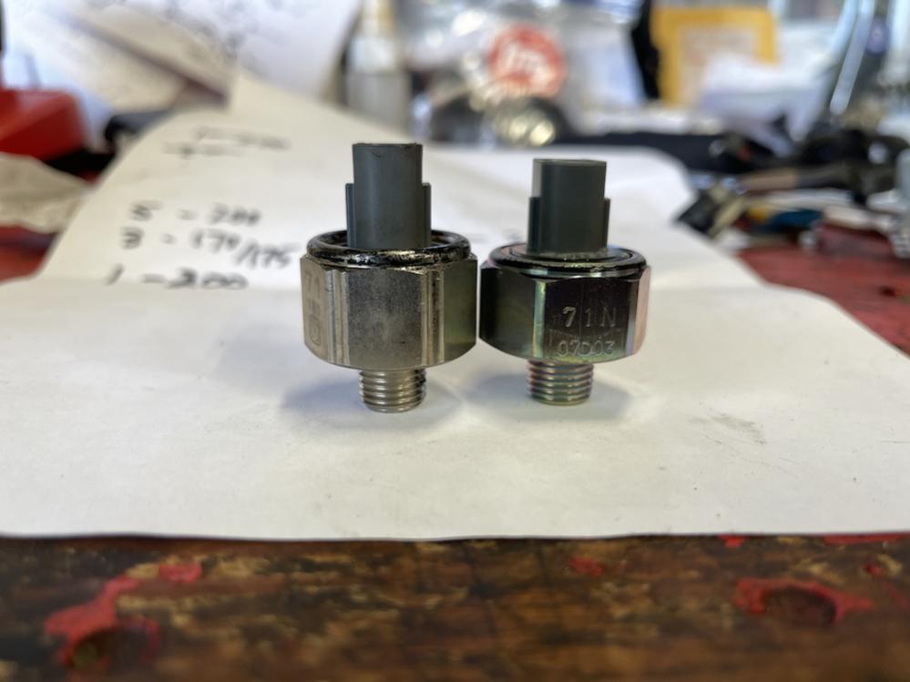

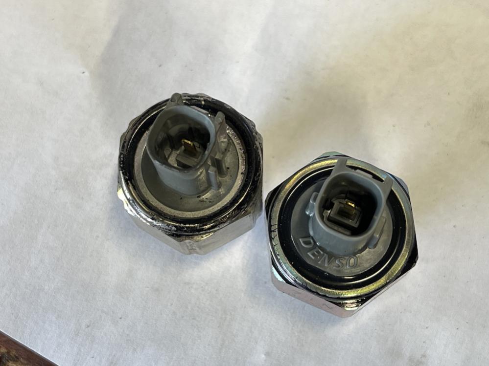

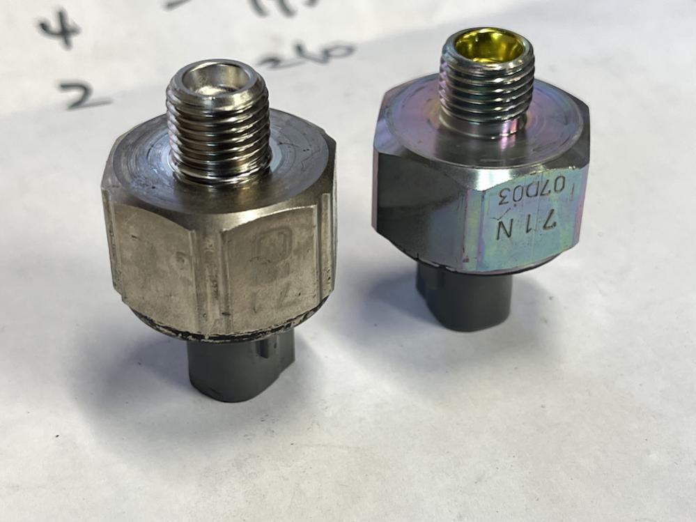

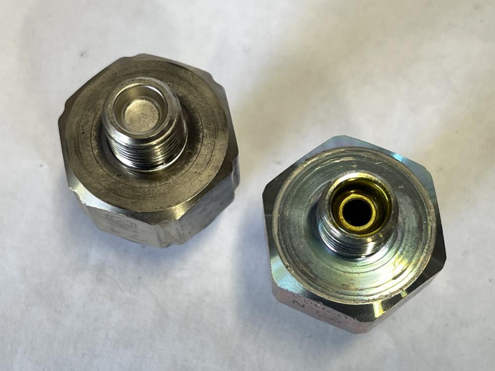

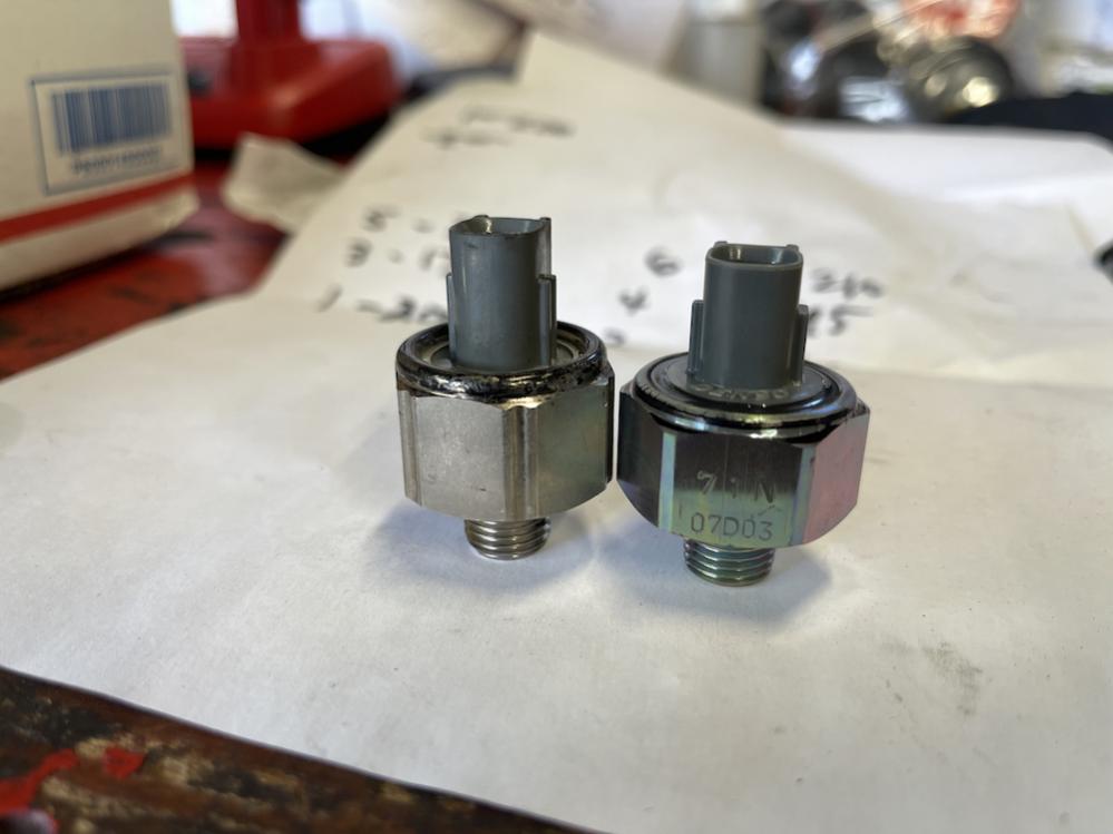

I recently replaced my knock sensors with some Denso OEM ones, but upon comparing them to the ones that came out of my truck, we noticed some obvious differences.
let me know what you guys think was going on here?...
the one on the right (the knock sensor with the hole in it) is the NEW Denso sensor.

Toyota originally used Matsushiita then switched to Denso, as the matsu sensors weren't nearly as reliable and didn't put out as clean as a waveform. Absolutely use Denso - i went through sets of both when chasing my gremlin and comparing the two through an oscilloscope showed night and day differences. When hooked up the Matsu sensors produce roughly the right shape and kHz but was very messy - still, one would very easily look at it and go "close enough, right?" - but in comparison the Denso sensors produced one nearly identical to what's shown in the FSM and was MUCH more stable. If the waveform is pretty much anything less than perfect the ECU will see it the same as the sensor failing to function and will throw a CEL.
