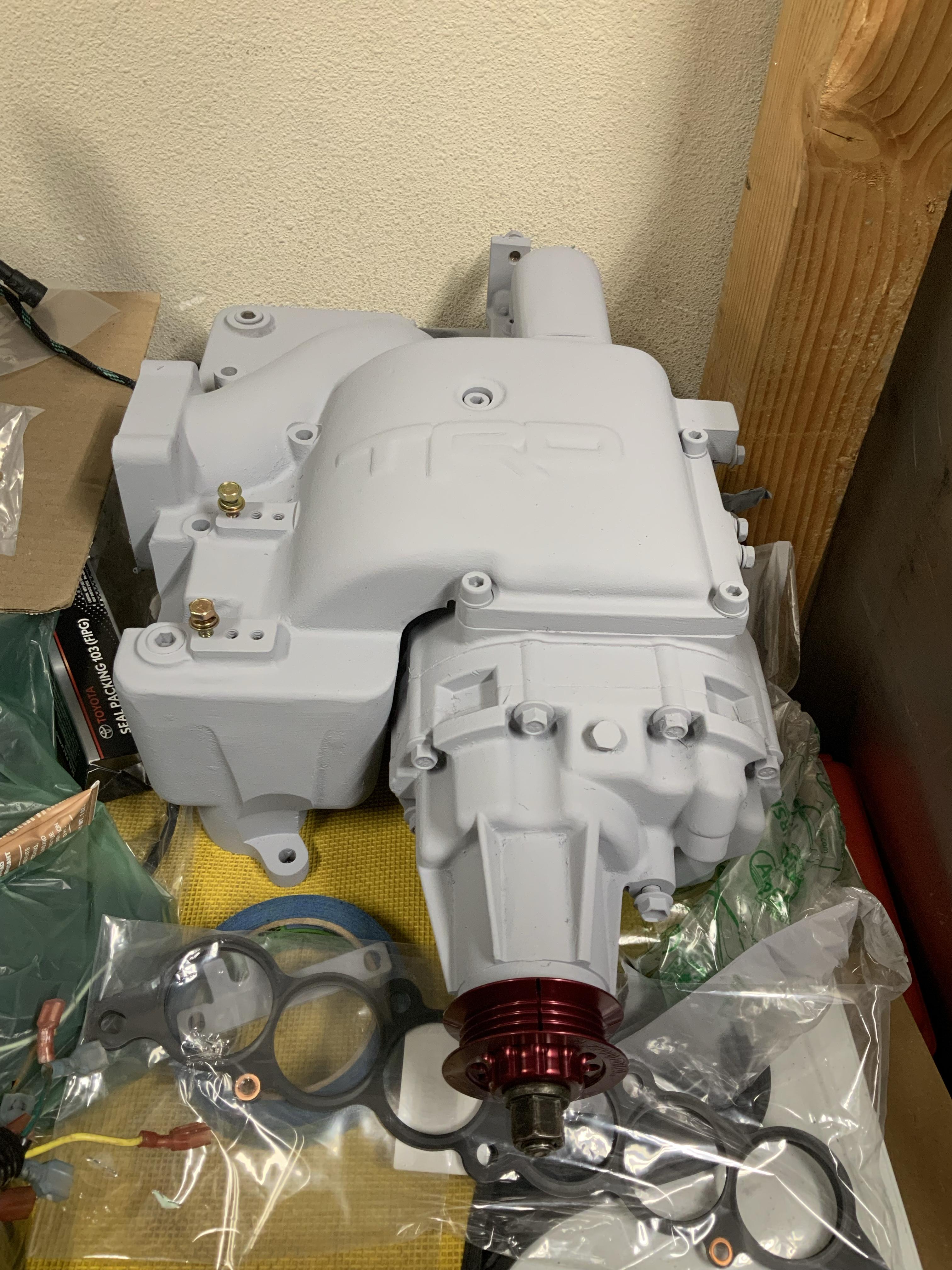

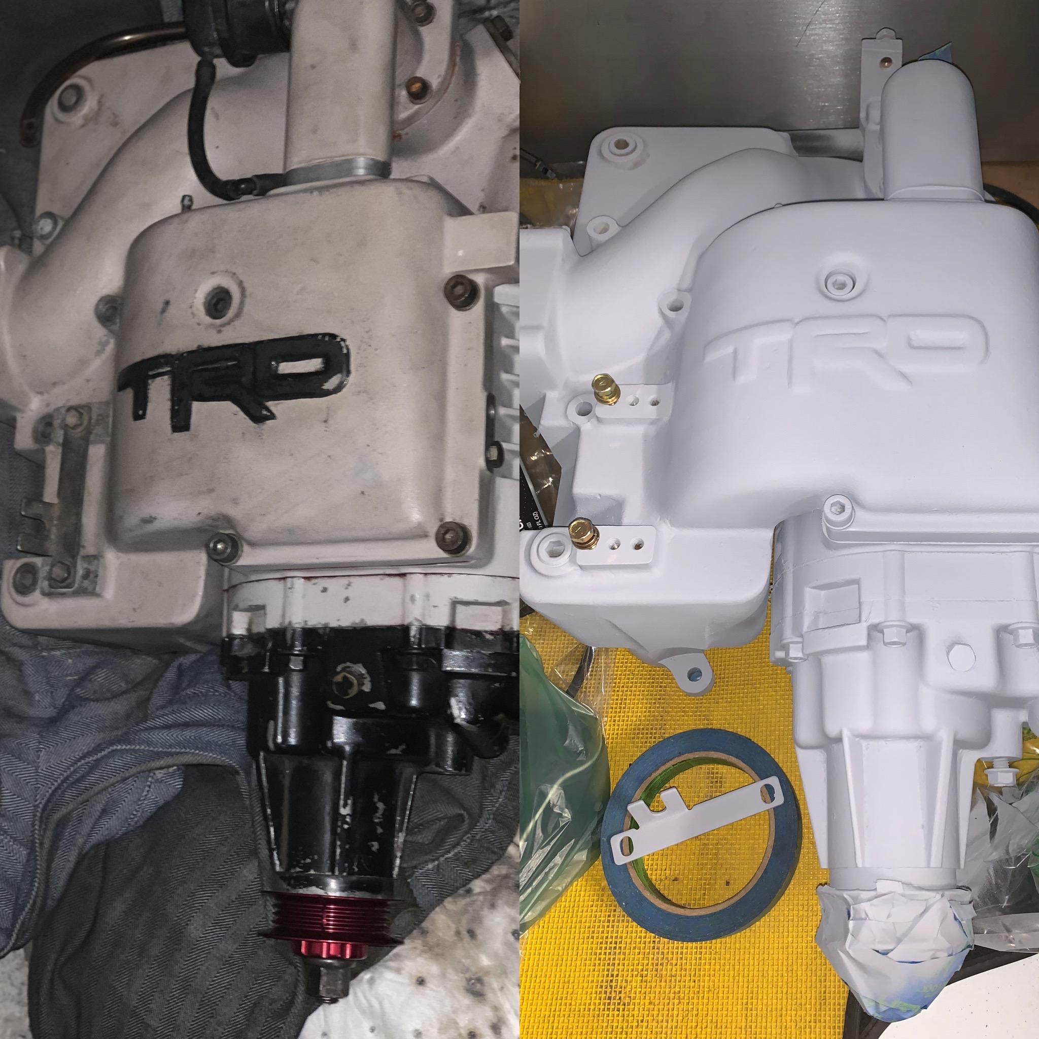

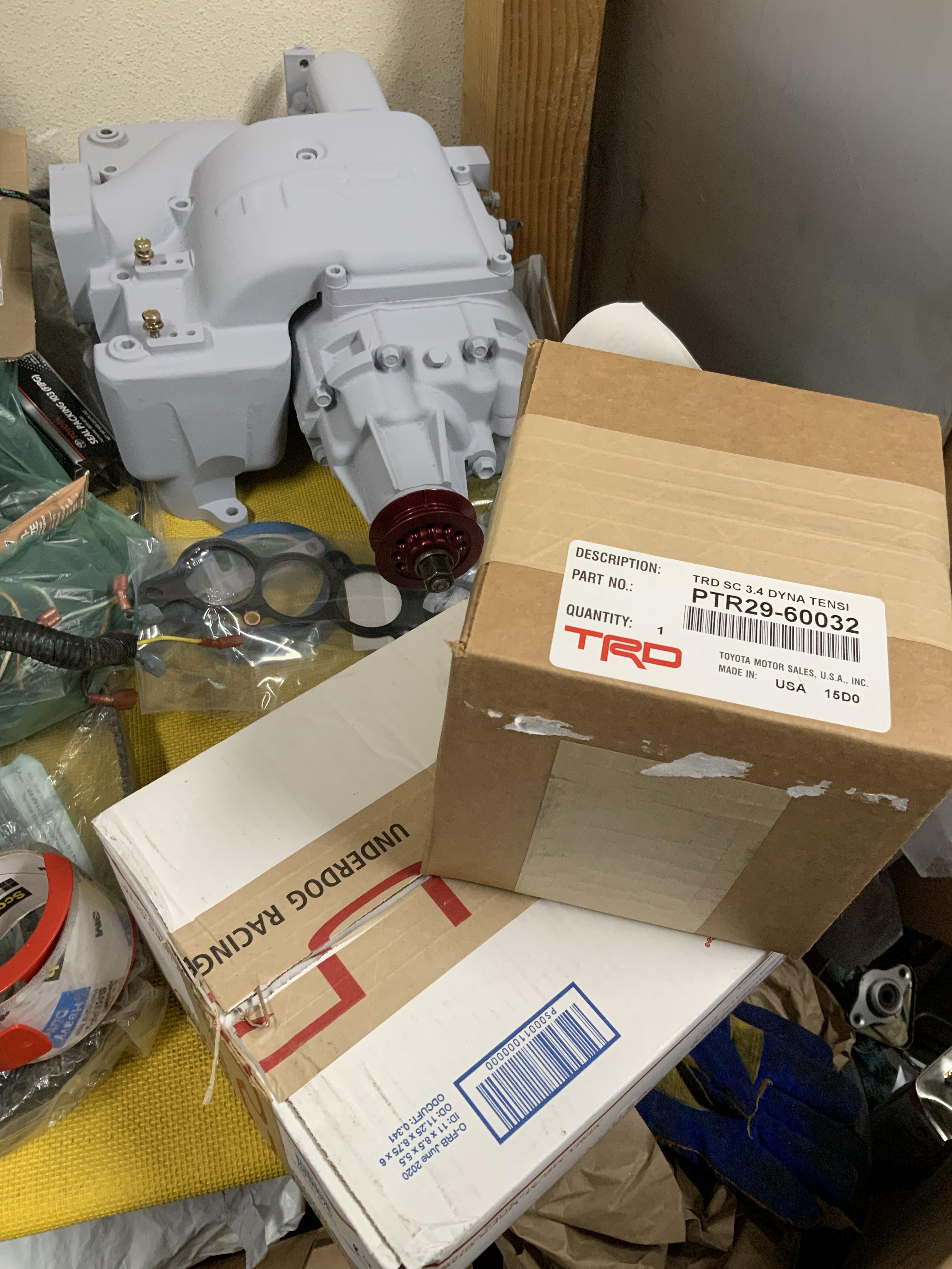

Cleaned up the charger and getting ready to install it when I get my truck back from the shop. Also gathering all my parts for the SC from TOYOTA & URD
Before and after
After
Jealous you get one TRD SC...I'm holding out for one myself.
Got it a while ago. Been waiting for my truck to come home and get on in. I wasn’t looking for it and my friend who is working on my truck ask me if I wanted it. I told him no at 1st, but when I went to the shop and he told me how much he wanted for it I bought it.
