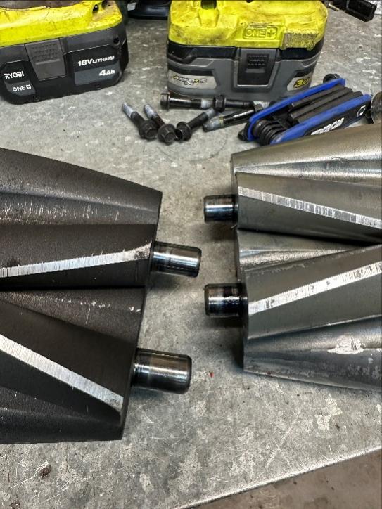

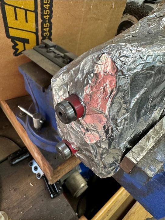

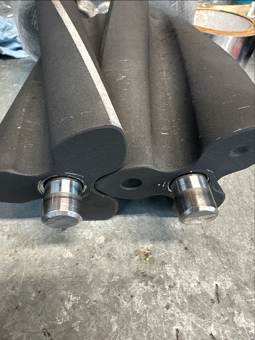

I thought I would post this here in case it could help someone. I bought a 2nd Gen TRD supercharger for my 98 that turned out to have a bad rotor pack. Something metal had traveled through the rotor pack and messed up the timing and damaged the blades (It made LOTS of noise at idle). A replacement rotor pack from several of the rebuilders was quoted from $900-$2000 so I wanted to look for something cheaper.
I purchased a 04-07 Cobalt SS supercharger for $100 locally on Facebook marketplace as it looked to be the same m62 pack. It is ALMOST the same. The rear shafts from the rotors turned out to be about 1/4 longer than the TRD rotor packs. Using a caliper to measure everything, this is the only difference I could find. I used an angle die grinder to cut off the 1/4 inch and chamfer the ends and gave it a try. Seems to work perfectly. I went from 4.5 psi of boost to a little over 6 and have no noise. I have driven it a bit now with no issues and wanted to post about it.
I have attached some pictures, one showing the difference in the length of the shaft, one while I am cutting (I took turns cutting slowly to keep the heat down), and one completed. You can see in the pictures I taped everything REALLY well to keep out any metal shavings. I hope this helps someone, the Cobalt superchargers can be bought in my area for $200. Also the coating on the blades is different, it does not flake off like on my TRD rotor. Every Cobalt supercharger I looked at was in great shape.

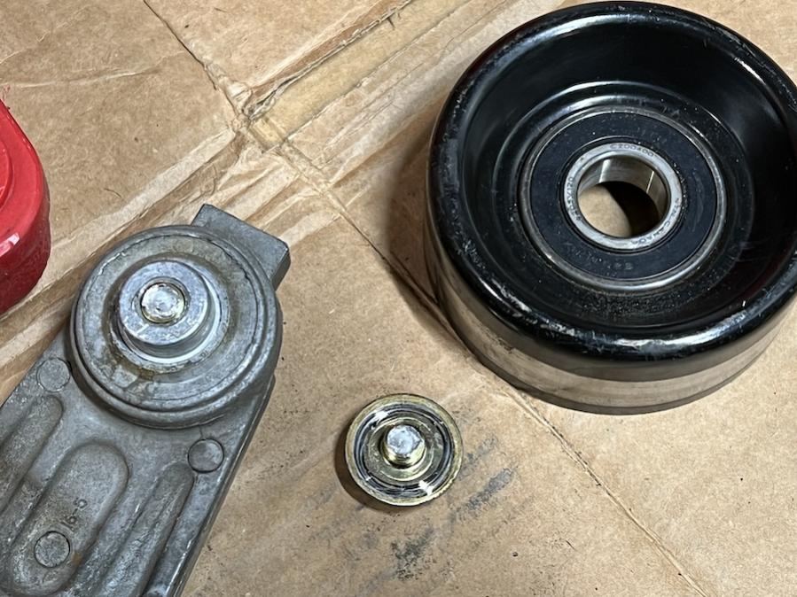

Does anyone know how I can source this dynamic tensioner pulley bolt? mine sheared!

Thanks for posting this here. I've saved this for reference for when my rotor also eventually wear out as I think mine have 150K-200K miles.

Oh, it's the short bolt for the pulley. That's a toughie. Try backing the thread out and take the pieces to ACE hardware. Will be either an M8 or M10 but the size I don't know as I never took one off. Could also cut a longer bolt to size.
McMaster-Carr is a great source for odd fasteners too... I bet that bolt has a Toyota PN though - if you want to stay OEM(-ish) there.
