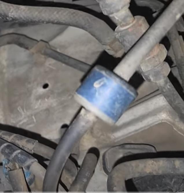

not sure which valve that is but the only check valve on a vacuum line i could find is on a line that goes from either side of the throttle body (IAC i guess?) to some solenoid lookin thing near the back of the battery.
Here's a short clip showing the vacuum line and the valve.
I believe the one you have in the video is the check valve for the 4WD VSC if it's the same routing as mine. The one I am mentioning would be coming off the bottom of the throttle body. There's 3 hoses total, 2 of them are coolant lines with clamps and the other one is the hose in question. It then tucks itself very neatly underneath the supercharger going from left to right.
If I did it right, I attached a page from the TRD installation manual. It's the paragraph and image at the top of the page.
