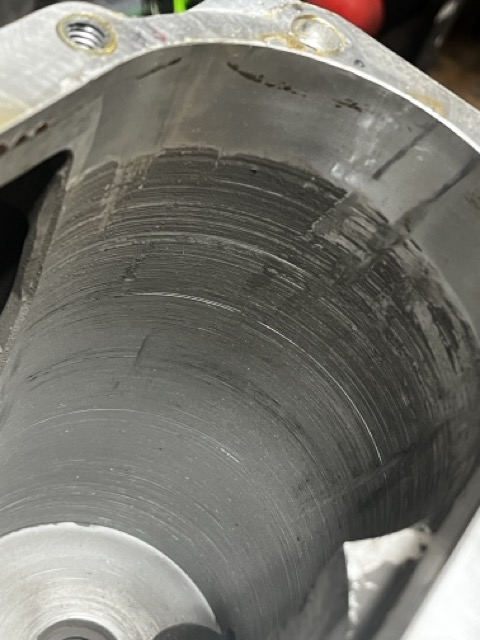

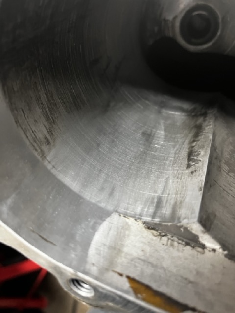

I’m having the same issue. I put my supercharger on(it was used) and it sounded like a diesel truck at idle to 1000rpm then sounded normal at higher rpms. Then I replaced the rear bearings and the coupler when I saw the rear of the rotors were worn. It still makes noise but it sounds more like a helicopter flying now. I have a feeling the rotor bearings are bad. Does anyone know if I can salvage this thing based on my videos and pics? I’m worried the case is too scratched but idk. The first picture I cleaned the carbon off at the bottom since it makes the scratches look deeper than they are. Thanks for everybody that helps
Supercharged 5vz fe normal? - YouTube - idling before I replaced rear bearings.
Supercharged 5vz fe normal? - YouTube - idling after bearings replaced
Bad rotor pack bearings? - YouTube - too much rotor play?

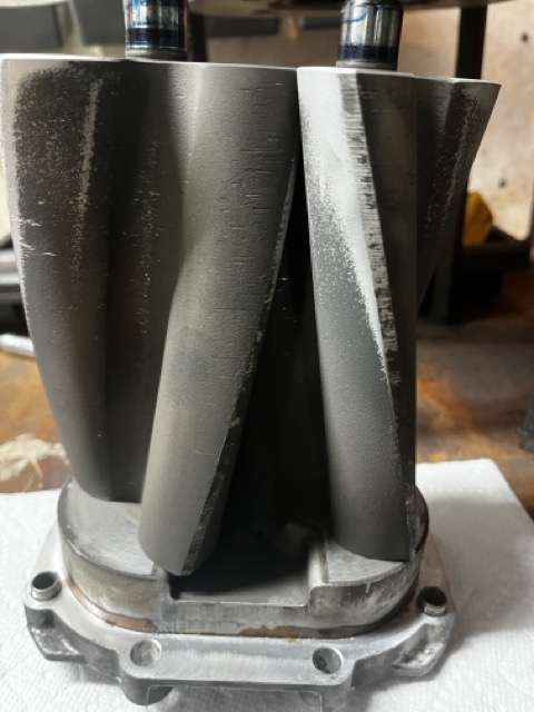

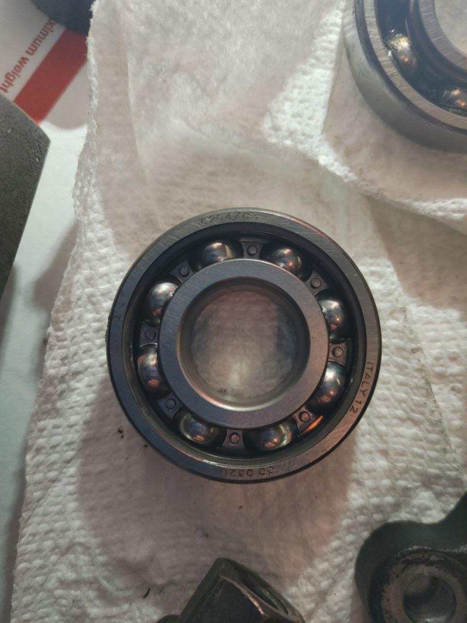

Hey Guys....
I started to do a supercharger rebuilt (gen 2) and the nose cone bearings i got have quite a bit of play in them. The seller (ebay guy) says the slop is normal and once the supercharger oil gets in them, they'll tighten up.
Is this normal? Should i go ahead and install them?

Hey Guys....
Sadly enough, I have never checked the play on new bearings. I know that these rotors are supposed to have play but no clue on the nose cone. I guess the question really is, how much do you trust the seller?
