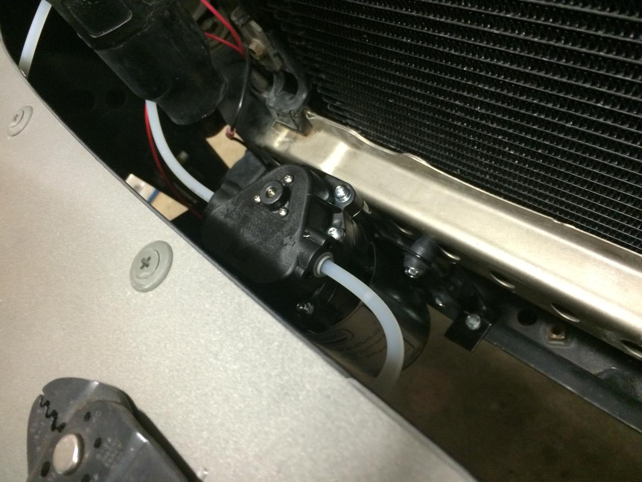

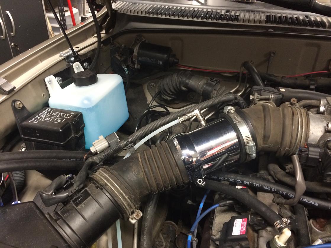

My AFR before the meth was 14.5 to 14.7
This show it is working...just not enough. I think this shows real promise...be excited to see what the 5 gpm does for you.
Did you just order a 5 gpm nossel?? Or did you order several like an 7 and an 10 also? At least, I'm assuming they make bigger than 5gmp?? That way if the 5's not big enough you can just change and keep going without having to stop, order and wait again?
Either way...good luck Sir!! I'm pulling for you...:popcorn:
-Russel
-Russel
Thanks Russel,
For now I ordered a 5gph nozzle. We will see what that does. I believe anything larger than 5 is too big. But I think others have run a 7gph nozzle.

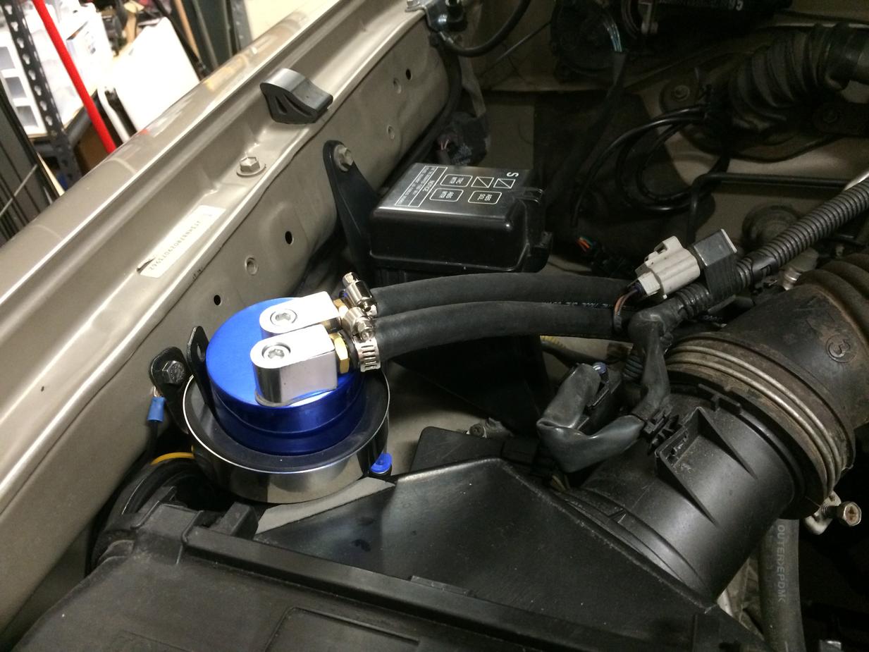

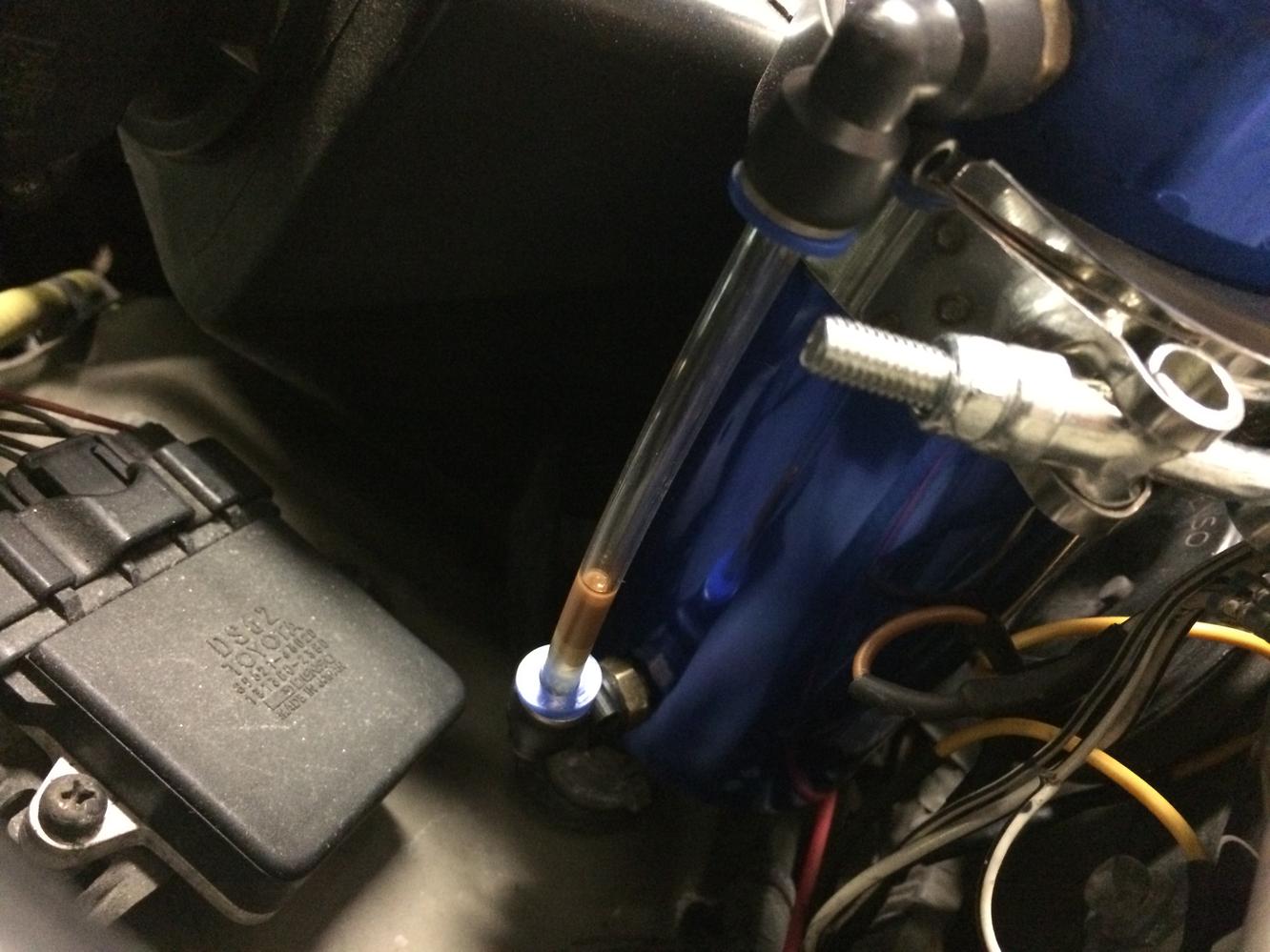

By the way, have any of you installed an oil catch can since installing your SC?
I did, and wow, I can't believe the crap it's catching. It looks like light brown crappy oil. I decided to install a very "cheap" one from EBAY just to see what comes out of it and I am totally impressed. I have had it on for about two weeks and its about 1/4 full.
Any thoughts on catch cans to go along with your SC?
I run one on all of my vehicles. Like you said...who wants that brown nasty looking oil crud going through your intake system, valves, and contacting your injectors?? Not me!!
-Russel

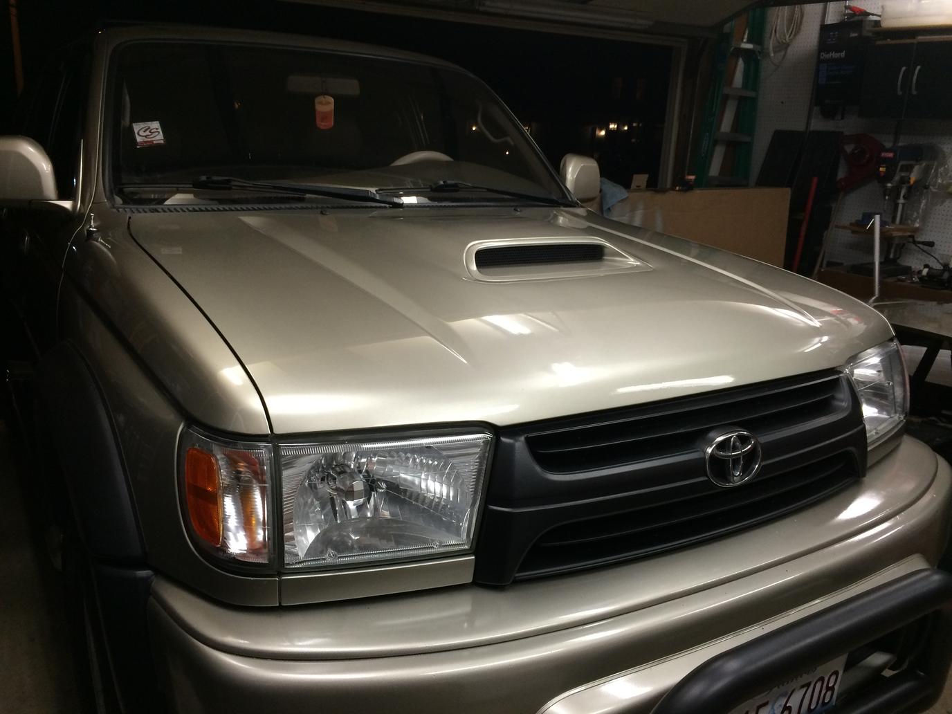

Here are some pics of my set up.
Disregard that first photo...That scoop is NOT mounted on my truck.
Here is the new hood I painted & installed.

Two questions for Russell:
So does the catch can plumbing just run from the crank case vent to the catch can, then air intake tube?
Also, is you meth kit the only thing you are using to "tune" your truck? Thanks
Catch can: Yes Sir, that is correct. Most catch cans have two connections..an inlet and an outlet. All you're doing is mounting the can in-line somewhere in it's PVC hose...which runs from the crank case vent (normally on the valve cover) to somewhere in the intake system. Thus, instead of allowing the oil in the vapors to enter your engine...you're now allowing the oil to collect in the catch-can, and sending the rest of the vapors on to the engine without harm.
Meth kit: No sir, it's not. On my truck, I don't use water/meth to "tune" my truck at all. I do use it to help cool my intake charge and cool my EGT's. I use a programmer called EFILive to tune the truck. We could only wish and hope for something like EFILive for our 4Runners!!
Hope his helps...
-Russel
Catch cans are great, I've got one too.
gamefreakgc-albums-mods++upgrades-picture30592-catch-can-redirects-oil-residue-into-can-where-settles-out-intake.jpg
Since replaced the cheapo hosing though, it collapsed under heat. After opening up my intake and seeing everything coated in oil, my mind was set. $30 and a bit of thinking on where to put it and I was done.
I run a Moroso Catch can - it's of a higher quality as it includes a 'steel wool' filter for the oil to coalesce on to. I pulled out some water and then a bunch of sludgy mess. Very happy with the results and I hope that it helps keep the intake clean - I'll be seafoaming it on my next oil change.

It looks like a good set up. What brand catch can is yours? Mine is simply a cheap $13 one from ebay. I want to see how it holds up, then get a better one.
