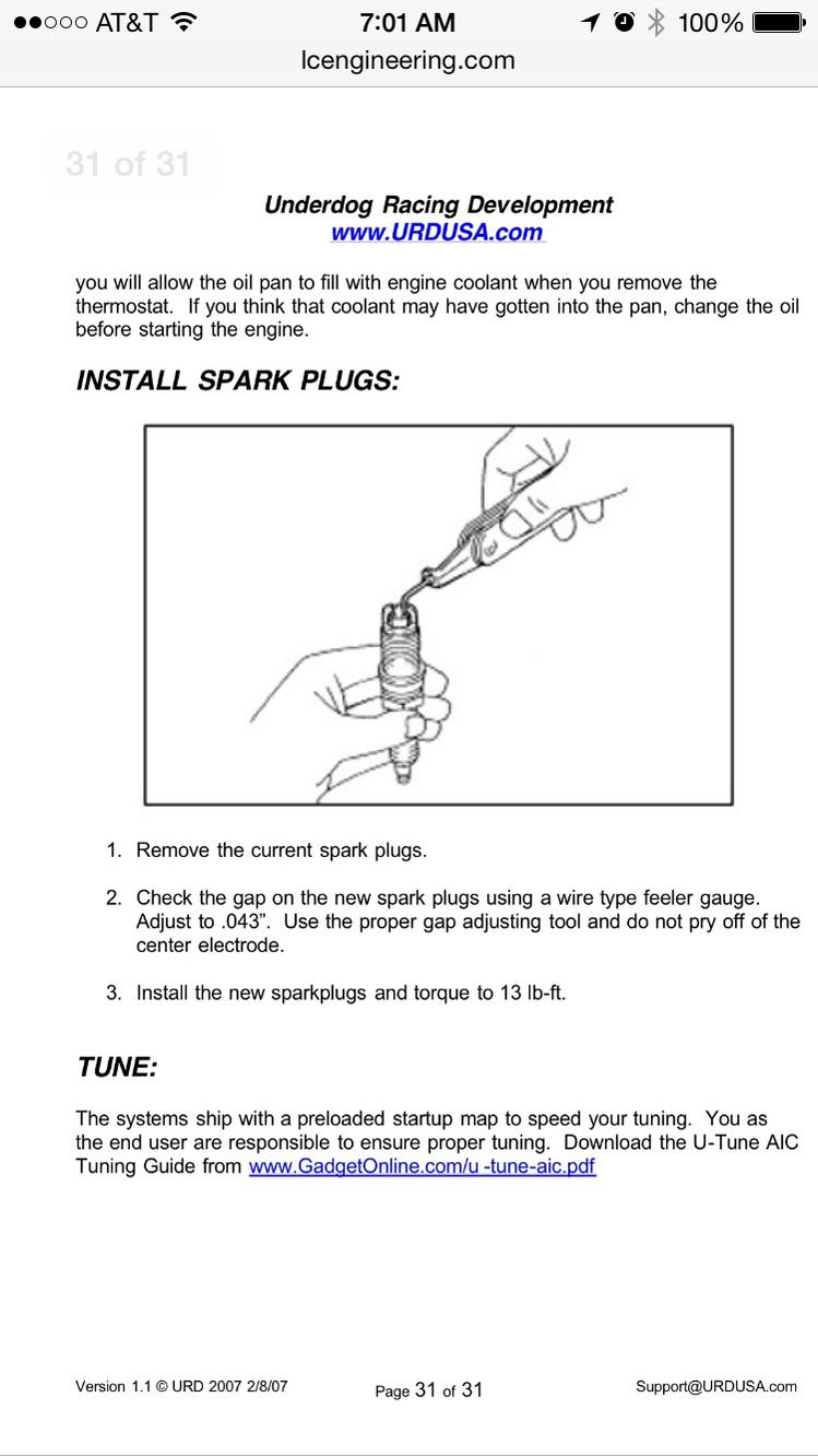

IIRC it's 4.3. Don't hold me to that, I don't have the instructions in front of me. That's also with installing the URD kit if that makes a difference. Maybe someone else can confirm -
I think you mean .043 but yes.
Ya that's what gadget says and those are the exact plugs I got in my kit. My truck runs fine with those. Also ran fine with Denso twin electrode ones too. I don't even think if the actual vehicle manual tells you to gap the twin ones. I know Toyota calls for 2 electrode ones right on a sticker on the engine, and I always thought they came pre gapped when they had 2.
But it'll be fine man. Some guys run .035" without qualms. I wouldn't lose any sleep over it, it's not a dragster.
