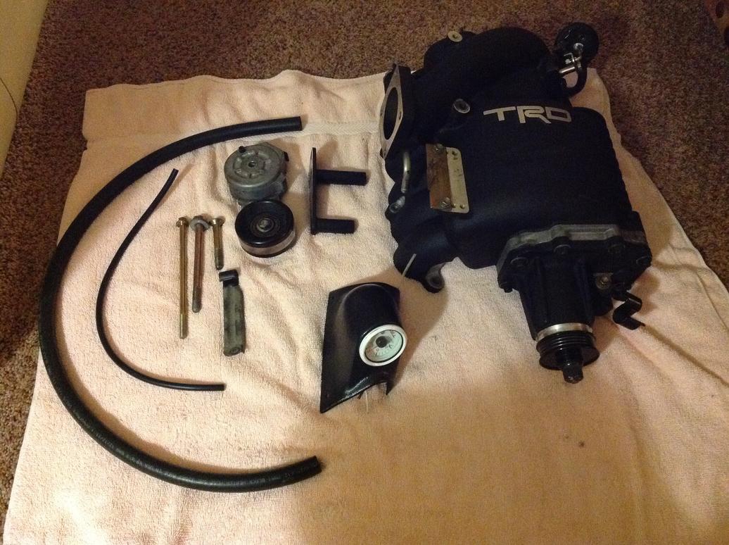

Do I have everything?
I think I have everything to put this on, but I wasn't sure if I need the IAC check valve or not. Do the '01's use it? image.jpg
