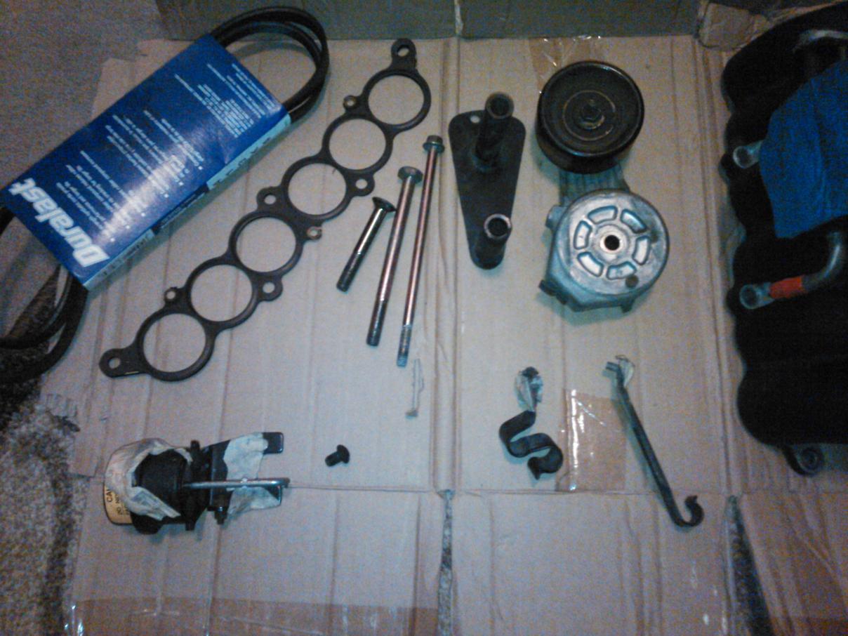

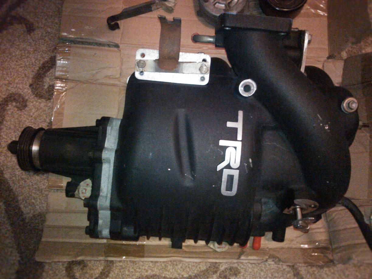

heres what I got. the small bolts are taped to the dipstick relocation bracket and throttle cable bracket. I will be buying the install kit from trddallas but I know theres some things I need that are not in that kit.
Looks to be just about complete. The only items I don't see are the hoses, bolts to attach the throttle body and throttle body gasket.
These are the bolts needed and a link to buy them.
4 Socket Head Cap Screws, 8 x 1.25 x 65mm Attaches Throttle Body to TRD S/C Manifold
4 Washer, 8mm Flat 1 per Socket Head Cap Screw Used to attach Throttle Body to TRD S/C Manifold
WP121972 12.9 Alloy Steel Standard Metric Socket Head Cap Screw - Grainger Industrial Supply
That should be everything and I wouldn't get the install kit. You have everything needed, but the hoses. I just used some regular tubing from any auto parts store for the lines needed and picked up the correct size T's needed as well. Probably $10 in tubing/T's. I think you need 1/2" or 3/8" and 5/16" maybe. I brought my SC and tested them before purchasing.

[MENTION=53337]SCRunner12[/MENTION], great thread. Thought I'd throw out a heads up to you. You don't need to have any extra bolts to attach the throttle body, you just reuse the 2 existing studs on the old manifold and the 2 two bolts from the existing manifold. Remove both and switch over to the new supercharger assembly and you're golden.
