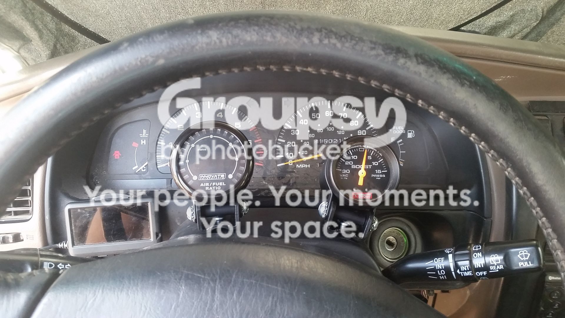

Good Football day everyone. So I mounted afr gauge but unsure how I should route the wire to the sensor. Anyone have any recommendations for the best route? Also, not to electical savvy. I know I need to connect the white to the headlight wire, red to a power source (white one is best to use?) and the black to a ground (is it best to go right to the battery?).
Here is how it and the boost gauge are mounted..
You need a pillar gauge it looks like lol. I have one I designed and can print if you are interested.
