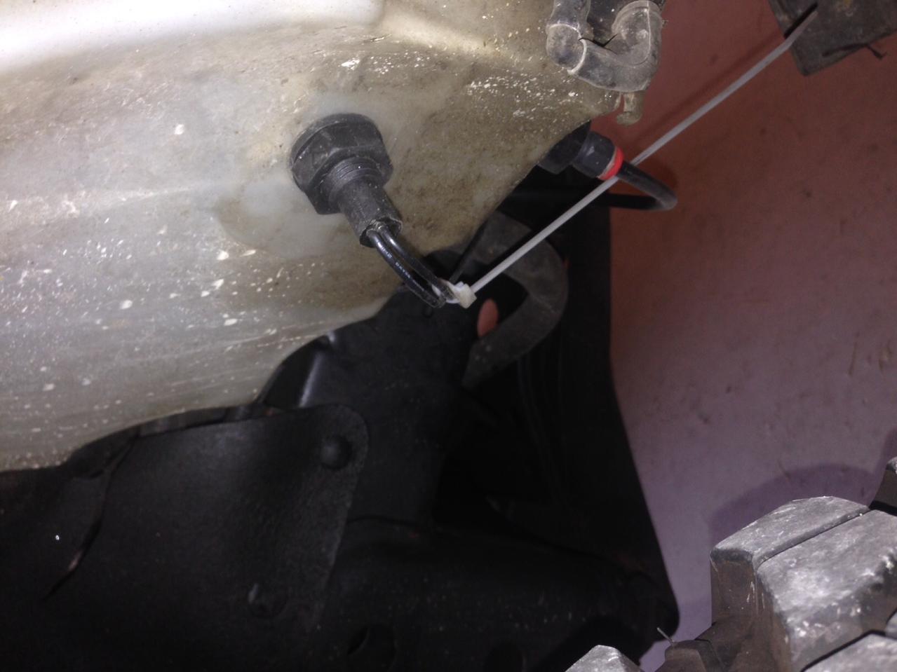

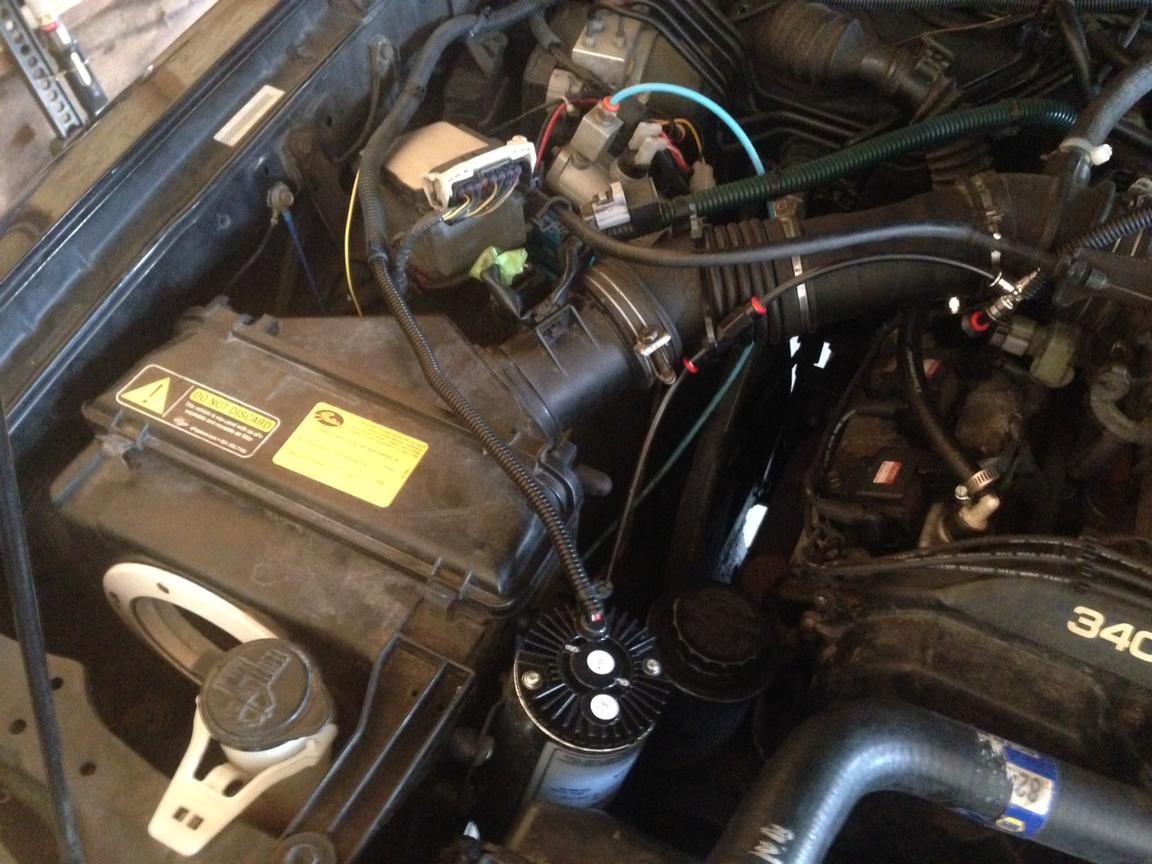

I used the factory washer fluid bottle as you can use the water meth as washer fluid... less work, and save space in the engine bay. The supplied self sealing tank tap and low level float switch work really well, and are so easy to install. The only gaff I had on the whole install is that the float switch is too long for the location I installed it, so its not functioning. Wiring for the switch is easy... one to ground, one to the controller. Next I installed the pump on the air filter box. It doesn't inhibit removal or airflow, and was the logical place for me.

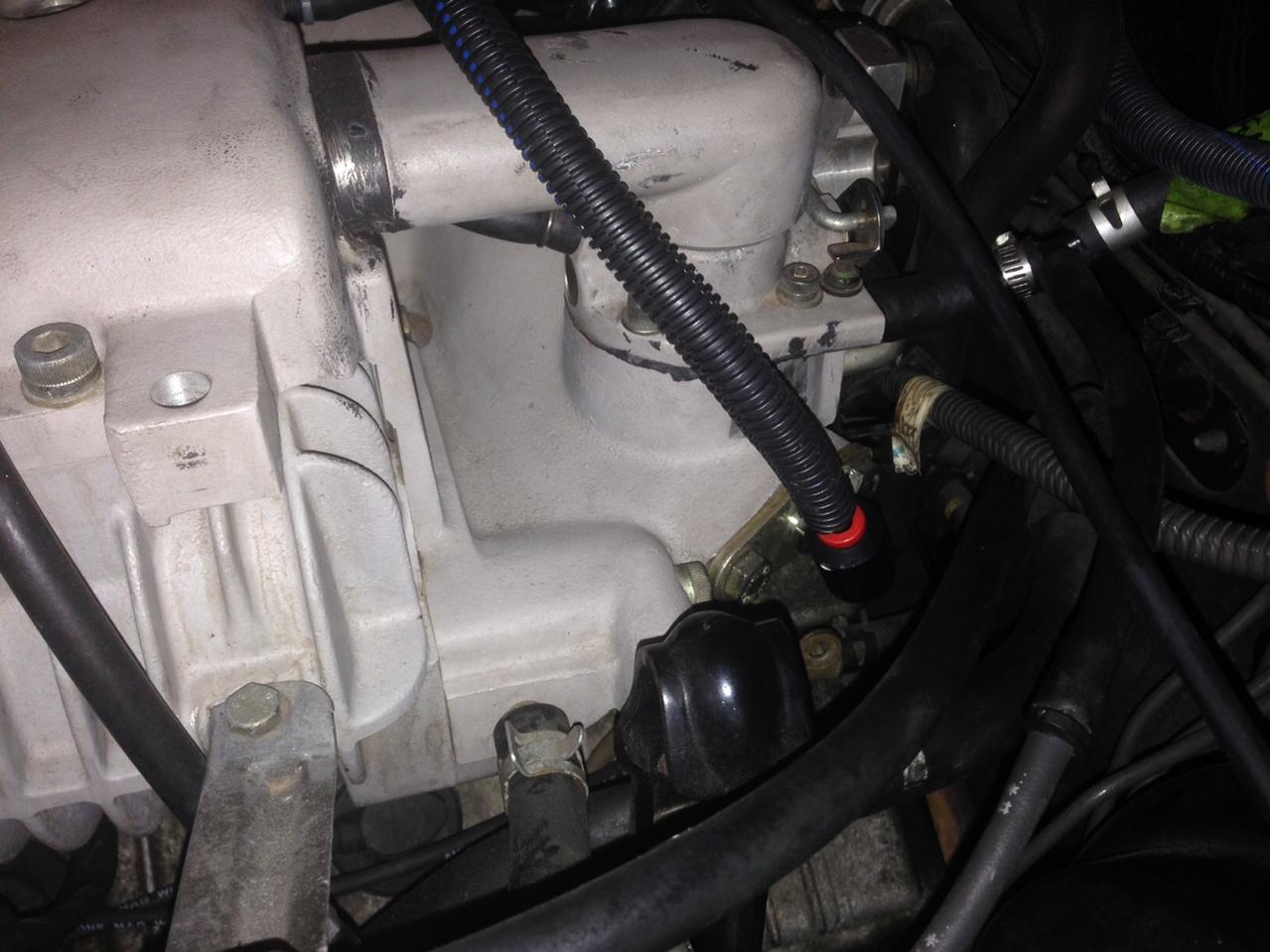

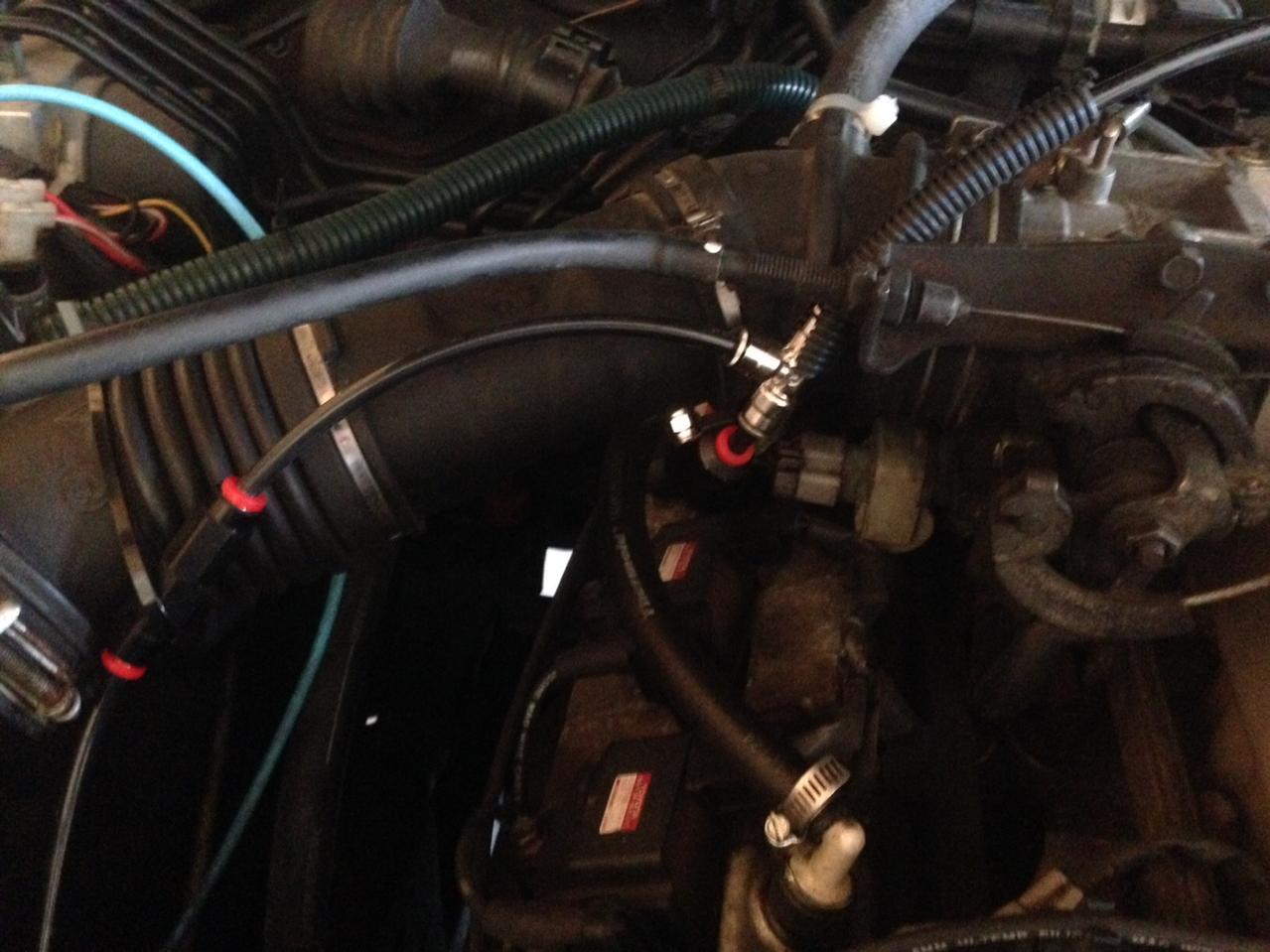

Next, as you can see above, I ran the tubing from the pump to the oneway check valve. Then from the check valve I tee'd off and ran tubing to the first injector just before the TB, then to the EGR port on the SC. Basically I Couldn't tell which point would be most beneficial, so I installed at both locations. To install you drill and tap the location, then just screw in the NPT style injector. All of the hardware is very well designed, easy to use, and quality material.

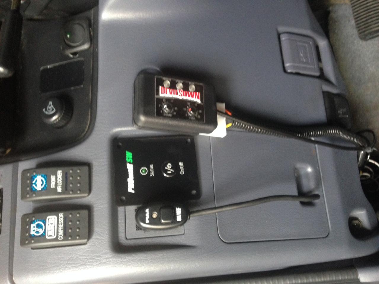

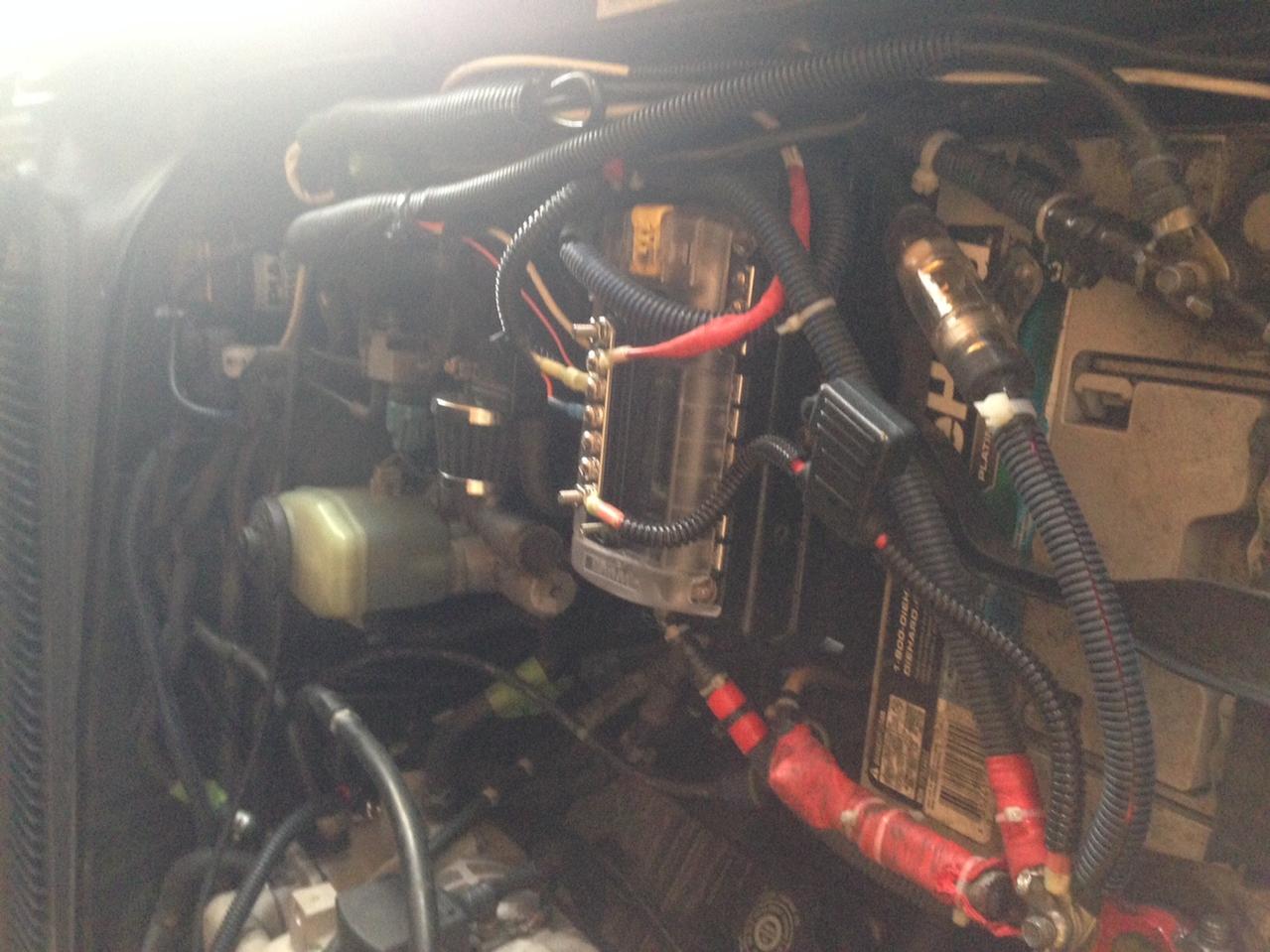

Wiring the kit was straight forward, and the instructions do a fine job of explaining everything adequately. Basically, the pump's power connects to the battery (I added a hot battery bus/ constant power). The negative is connected to the controller. The controller itself has a constant power supply, ignition source, ground, signal (float switch), pump ground control, and boost line. I drilled an extra hole and grommet through the fire wall for the additional wiring. I tee'd the boost line off of the boost gauge supply line, so I wouldn't have to run a boost line through the fire wall again.
