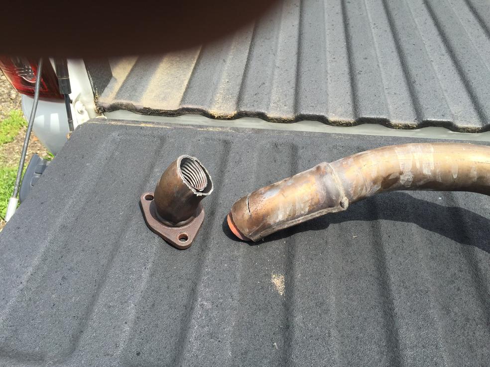

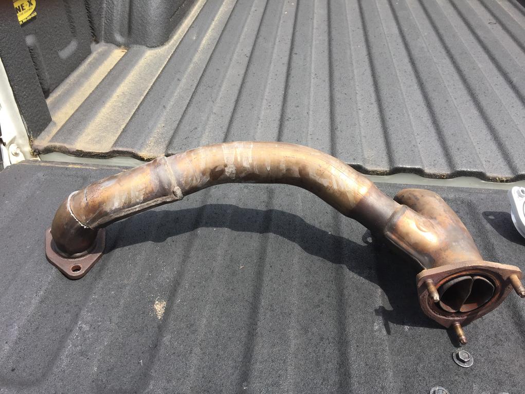

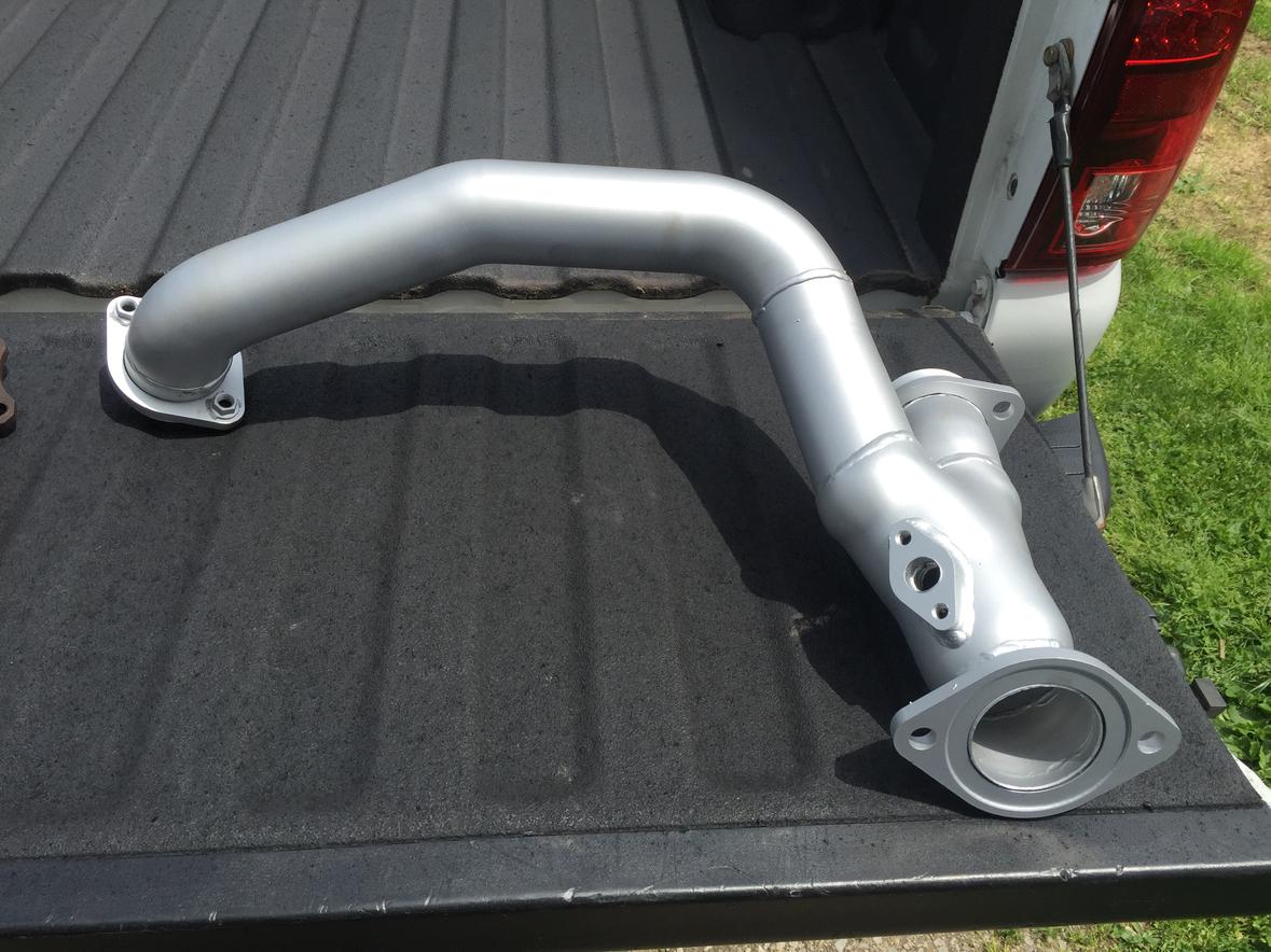

I wish I would have done a Dyno run before and after installing my headers. To see what the actual power differances is! I'm a true believer in headers...some aren't. I personally didn't think it was that difficult installing the headers. The hardest part was removing the crossover pipe. If you have a lift kit...it makes it that much easier. I myself, just cut the crossover pipe in half on the driver's side...and it came right out after that.
I had people telling me I had to pull the engine or drop the trans, or stand on my head while closing my right eye!! I don't know...to me, it wasn't that hard...and nothing like what people made it out to be.

I had my headers in the garage for almost a year cause I didn't want to mess with them. It took a buddy and me about 1/2 day to get them installed. I'd put it at a 7 out of 10 on the scale of easy to hardest. I personally thought the worst part was fabing the old exhaust to the new header down pipe. The smart thing would have been to drive it up to a muffler shop cause they have all the cool tools. We're a little hard headed sometimes...so we did it ourselves?? Not sure if it's going to say or be replaced...lol!!

Anything big than an 1" BL...you might not even have to cut?? That's just a guess, but that's what it was look'in like.

Did you notice in power increase? Would you do it again? How much did you pay for yours? What brand are they? Can I have them? Who's going to be the next James Bond? Do you have a dog? Why do they look sand blasted? Did you have any exhaust leaks? Any problems with exhaust studs or nuts being rusty? What's your ssn? Do you have another car? Why did you call yourself russtoy? How's the headers holding up?
Did you notice in power increaseUnsure...I haven't been out on the road yet. Would you do it again? Yes! How much did you pay for yours? I got an awesome deal on them through a store that doesn't normally deal with Toyotas...they're more of a Jeep shop. IIRC I paid around $550 after my military discount and free shipping. What brand are they? They're Doug Thorley. Can I have them? No Sir. Who's going to be the next James Bond? You! Do you have a dog? That's a silly question...yes, I have 2 Pugs! Why do they look sand blasted? They came ceramic coated, which made them look like they're chrome. Not a big fan of chrome. I tested the thickness and didn't like what I found; therefore, I prep them and shot them with Jet Hot ceramic coating...now I don't have to worry about them anymore...at least for another 10years. Did you have any exhaust leaks? No Sir. Any problems with exhaust studs or nuts being rusty? No, but I still replaced all the hardware with new...lock-tite them all down. What's your ssn? Sorry...I will have to refer you to my accountant Do you have another car? Yes, sir...5 in all. Why did you call yourself russtoy? That's my name and this is one of my toys I play with. How's the headers holding up? Awesome...I have almost 15-20 minutes run time on them and they still look brand new!!
