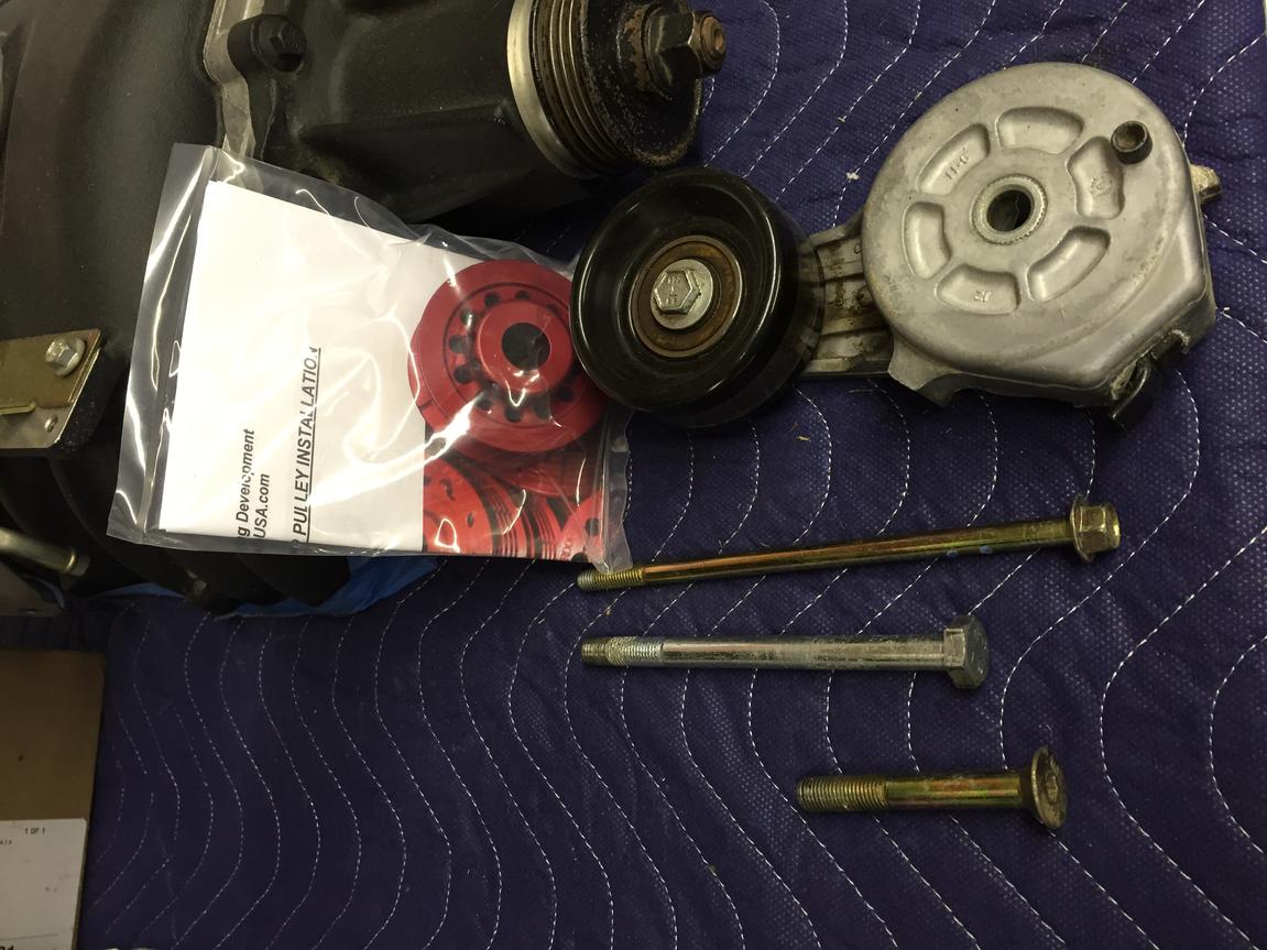

I was referring to the manifold support bracket. Thanks for the reassurance on the 98 ECU. Thats just what I needed to hear.

I'm with @MTD...you have it already off the vehicle and torn apart, go ahead and replace the rear bearing. If you ask me...that's just cheap insurance.
I'm Unsure what parts you are missing? I was missing the dip-stick relocation piece, which I just fabricated one. Below is what I had with my S/C...and it was everything I needed except the above mentioned dip-stick piece.
Also...if you go the route with the 7th injector...you don't have to solder all billion or so wires coming out of the ECU...URD has a wiring adapter you can buy, which turns that part into plug-n-play. Saves a ton of time and you can remove it...and it would look factory...as if you never did anything. I'm unsure if that would work with AEM setup?? That would be sweet if it did!
Edit: my second picture didn't load...it's the next post...which is on the next page. Thanks
