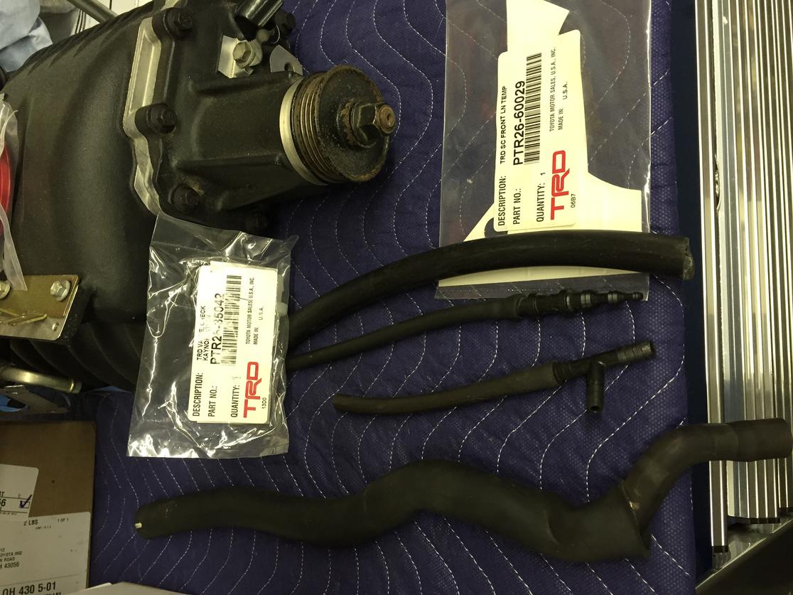

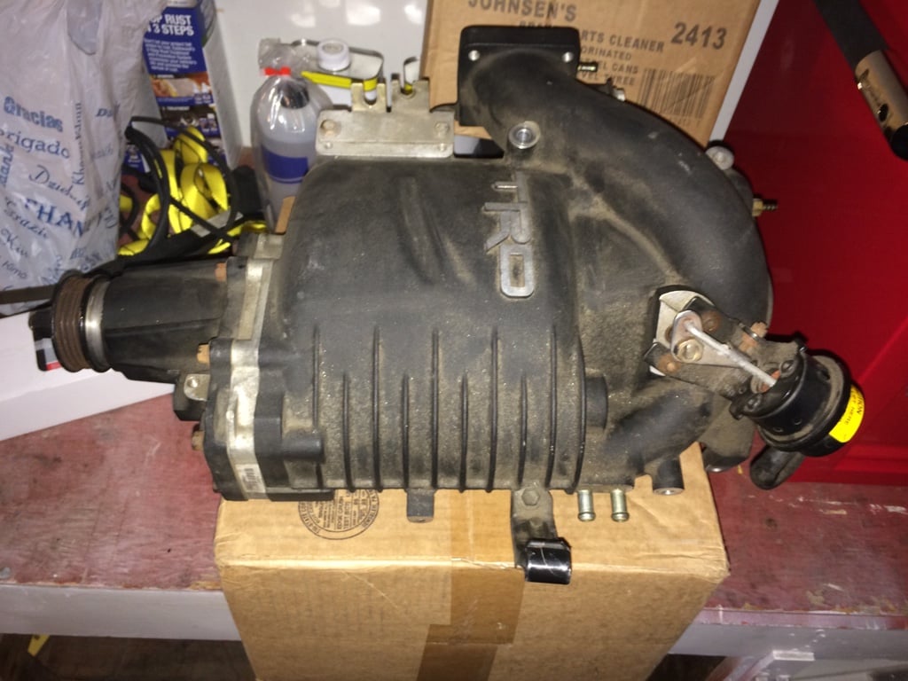

I purchased a used 2nd gen supercharger with some bearing noise, but It did come with everything needed to install (other than the throttle bracket, dipstick relocation bracket, and the other wireloom bracket).
Any update on where I could get these brackets? Or is the full kit with all of those other unneeded items still my best bet aside from attempting to make my own?
As for the bearing noise, I plan on just purchasing an entirely new nose cone kit from toyota. I am, however, a little confused about the rear bearings on the 2nd gen. Is there a way to tell if these are bad while I still have the supercharger on the workbench? What is the way that most of you go about replacing/maintaining these?

Oops...my second picture didn't load!

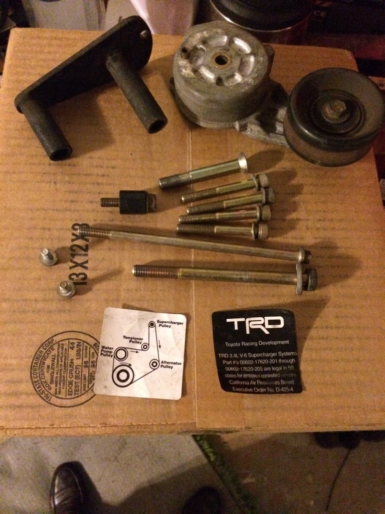

I'm Unsure what parts you are missing? I was missing the dip-stick relocation piece, which I just fabricated one. Below is what I had with my S/C...and it was everything I needed except the above mentioned dip-stick piece.

Looks like there is a bracket already installed on the sc. Any way to tell which one it is/ which one I'll need for the 96? Sorry for the noobish questions just want to get my ducks in a row for install day/week
Pretty positive that they were the same for all years, I think it's the throttle cable bracket that was different.
This is everything that was included with my sc. Do you think I will need to buy any other parts other than:
Check valve ptr26-35042
Supercharger belt
Replacement throttle body gasket
Nose cone kit
Rear bearings
Catch can
17176-62040 air surge tank gasket
Wideband
Vacuum hoses
Cold plugs
Oil change kit

Some guys...me included, choose to run colder thermostates. I personally I'm running a 170*
Other than that...it appears you have all you will need. That said...there is one other item you could upgrade to. Your tentioner pulley...they are prone to throwing/slipping belts...because there it nothing holding the belt onto the pulley. URD (of course) makes a replacement pulley that has sides on it...thus, making it so the belt can't side/jump off. Not a necessity, but for $99...its nice insurance and looks really cool too...hahaha!! :roll: Here's a link to it...
