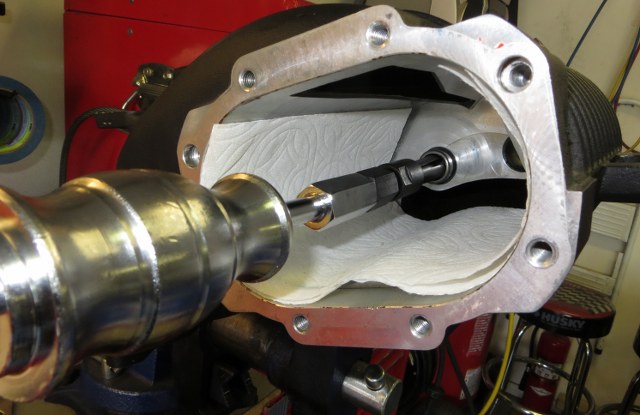

I attempted to rebuild my SC this past weekend. The nut was easy to get off with an impact. While I had the snout off I just wrapped a rag around the pulley and hit the nut with the impact and it came right off. The snout bearings were fairly easy, however the rotor bearings in the back of the case were not. In fact they are still there, or what is left of them, anyway. The one on the right does not push through, so I am going to have to go to a machine shop and see if they can work some magic to get it out. Tried with a 20 ton press and a BFH and nothing, other than pieces of needle bearing everywhere. The one on the left, closest to the TB, the back broke out of it. I am going to let the professionals handle that part. I think the one on the left would push through but the right hole must not go through.
I just went through this in January. Machine shop is a good call. Took it to an import tuner shop and they pressed in my new bearings perfectly,added oil, and fipg. Handed off my sc to me with fresh rotor bearings installed for less than $50.
Which generation SC? On the 2nd/4th gen (black), they need to be pulled out from the front.
I used a screwdriver to remove the needle bearings and cages, and then used a blind hole puller to yank the rest of the bearing. Tapped the new bearings in with the large end of a 1/2" drive extension. Here's a pic of the puller in action:
