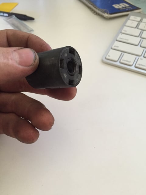

Ack! Help!
So after having cleaned my SC last week and changing the oil, my 4runner wont run. its super chuggy at idle and dies after revving once or twice on its own and doesn't smooth out until over 1500 rpm. Ive checked my vacuum connections and they seem good. All the electrical I can see is plugged in. No check engine light BTW.
Any thought on where to start trouble shooting?

This is probably far fetched, but...
While doing my UCAs yesterday, this fell out of nowhere somewhere on the drivers side of the engine bay.
Don't know if it could possibly have anything to do with it
That piece looks like the large washer that goes between the supercharger and the tall bracket on the driver's side cylinder head to me. Very easy to lose, I also dropped mine in the engine and it eventually fell out.
