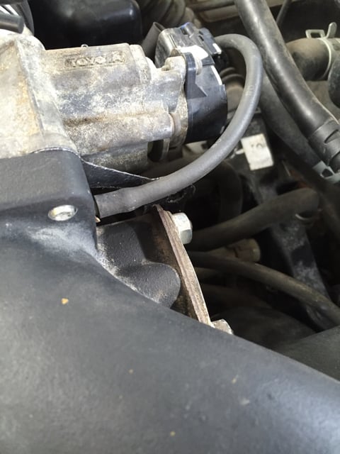

Yeah gotta check the basic obviously. The video sounds like it's boosting (?) so perhaps the vacuum bypass valve is stuck to "on" (?). See if the lever moves and move the other way maybe.
Also, I had a main SC-to-intake bolt loose by a couple turns on accident when I did mine a long time ago. (Not the same symptoms but easily overlooked in the chaos). So go thru the intake bolts again and make sure it's all snug. Vacuum leak there would throw a wrench it in for sure.
Next guess would be a dirty IAC by how it sounds. Couple screws and you can rotate the guts with throttle body attached and feel for a sticky part. If it sticks, soak brake/throttle body cleaner in its ports and exercise the guts to clean it.
It's a Toyota so it's gotta be something simple. And if it ran fine BEFORE, then it's gotta be something you did.
Good luck.
That piece looks like the large washer that goes between the supercharger and the tall bracket on the driver's side cylinder head to me. Very easy to lose, I also dropped mine in the engine and it eventually fell out.
My money's on the vacuum hose routing is wrong. Double check all hoses to make sure they are connected and routed correctly, also make sure the MAF is plugged in correctly and the intake tube is on snug.
I don't think the piece is a washer, the hole doesn't go all the way through.
Unfortunately, the previous owner cobbled together some really shoddy vacuum line splices and created many possible places for leaks... Ugh.
I'll do all of the above mentioned procedures and get back to you.

I've checked and rechecked my vacuum lines. Still nothing. I'm to the point now that I'm thinking about pulling the SC again and reconnecting everything very deliberately.

Found it!
To my embarrassment, when I put the throttle body on last week, the gasket slipped out and only got bolted on one corner. It pivoted off the lower rear bolt and swung nearly out of sight, leaving massive gaps on the back and bottom of the TB. I feel pretty sheepish.
I took the time to remove the throttle body and clean it well along with the IAC. Since the gasket got marred by being squished funny, I used just a smidgen of gasket maker to seal it up. Runs great now.
Unfortunately, the SC still rattles pretty bad at 6-800 RPMS. I've gotta get the bearings done, oil change and cleaning was insufficient.
Just relieved that it's running well.
Thanks for all you help guys.
