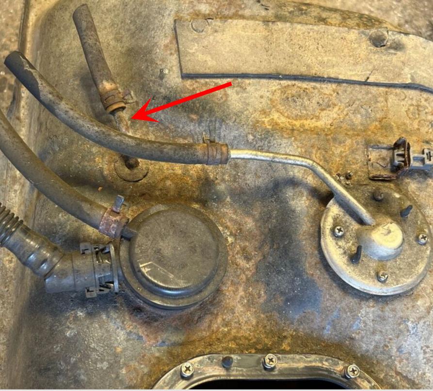

2001 4runner fuel tank
A port on my fuel tank is broken off flush with the tank. Does anyone know what this port is used for and if I can just plug it and reinstall the tank. See photo with arrow showing the port that is broken off on my tank. Note: The photo is not mine but shows the port I'm concerned with.

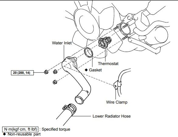

Water outlet nut Torque spec (5VZ-FE)
Hi guys,
I need to know a torque spec if anyone can help out. As I was going to put the intake manifold back onto my engine I decided to get a new gasket for the water outlet pipe since the old one looked rough from the outside. So I got a new one and put it on and started tightening it down to the spec and.... all the sudden my tightening became frightening... the nut on the stud I was tightening on sheared in half. Not sure if it was mechanical error on my part but I saw somewhere on a forum that the torque for those three nuts was 14 ft lb, in hindsight I think that is far too much torque for a 10 mm nut on a 6mm stud, and that torque spec is incorrect. It is the 5vz-fe water outlet pipe the one your upper water hose connects from the intake manifold to the radiator. It has three studs and you use three flanged nuts to tighten down the outlet piece to the manifold. I ordered three new studs and I am going to put them in but I'd like to know what the spec is so I don't blow another stud lol when I am tightening it down again. I've tried to search around for it but haven't had any luck. Thanks.
Here's a link to the pictures:
Album — Postimages
- GH
According to the FSM I have, 14 Ft/Lbs is the correct torque on the thermostat cover's bolts.

I'm not finding a torque spec for those in the service manual. I'd just tighten them until comfortable.

Go by feel. I sheared off the stud on one of those going for 14ft-lbs. It is clearly too much. For the record, I have gone almost 100k just leaving it as is. No leaks, and the stud and nut are in the parts drawer waiting for the next time I go in there, which will be soon, as it is time for timing belt #3. Thanks for confirming my belief that spec is wrong.
If you look at the standard torque for BOLTS, the highest grade M6 is only 9 ft-lbs. I doubt these are the highest grade, and nuts have less thread engagement so the torque is probably even less. I bet the right number is between 5 and 7, but it's just a guess.
https://www.teamtoyota4x4.org/archivio/1996%20to%202002%20Toyota%204Runner%20Repair%20and%20Wiring%20Manuals/techinfo.toyota.com/ileaf/02toyrm/02toypdf/02rmsour/2002/024runne/ss/stabol/stfsb.pdf
