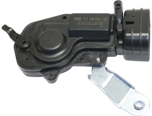

I was performing the door actuator motor swap and found this part in the bottom of the door. It's approximately 1.25 inches long and made of pliable rubber. Anyone know what it is or what it's for? Is it even part of the vehicle!?
Thanks!
Vent/drain for the lock actuator.
Thank you! I found a picture that shows the piece installed. Is it critical? I'll have to pull stuff back out to reinstall it.[/url]
Ha, it depends on how ocd you are. Toyota put that there for a reason.
I would put it back in when I got a stress free afternoon to tinker.

Fair point! I'm pretty OCD or as I prefer it, CDO (alphabetized). I can't actually figure what this thing does. In Tim the Toolman's video you never even see the part and I used it as my guide. Door Lock Actuator Repair (3rd Gen 4runner) - YouTube
Thanks for the positive ID and I'll figure a way to reattach it. Do you happen to know one of the actuating rods goes through it?
I believe its the rod that goes to the lock tab/knob. That the one you manually pull up to unlock, and press down to lock.
You can see it also in Tim's vid at the 22:22 mark.

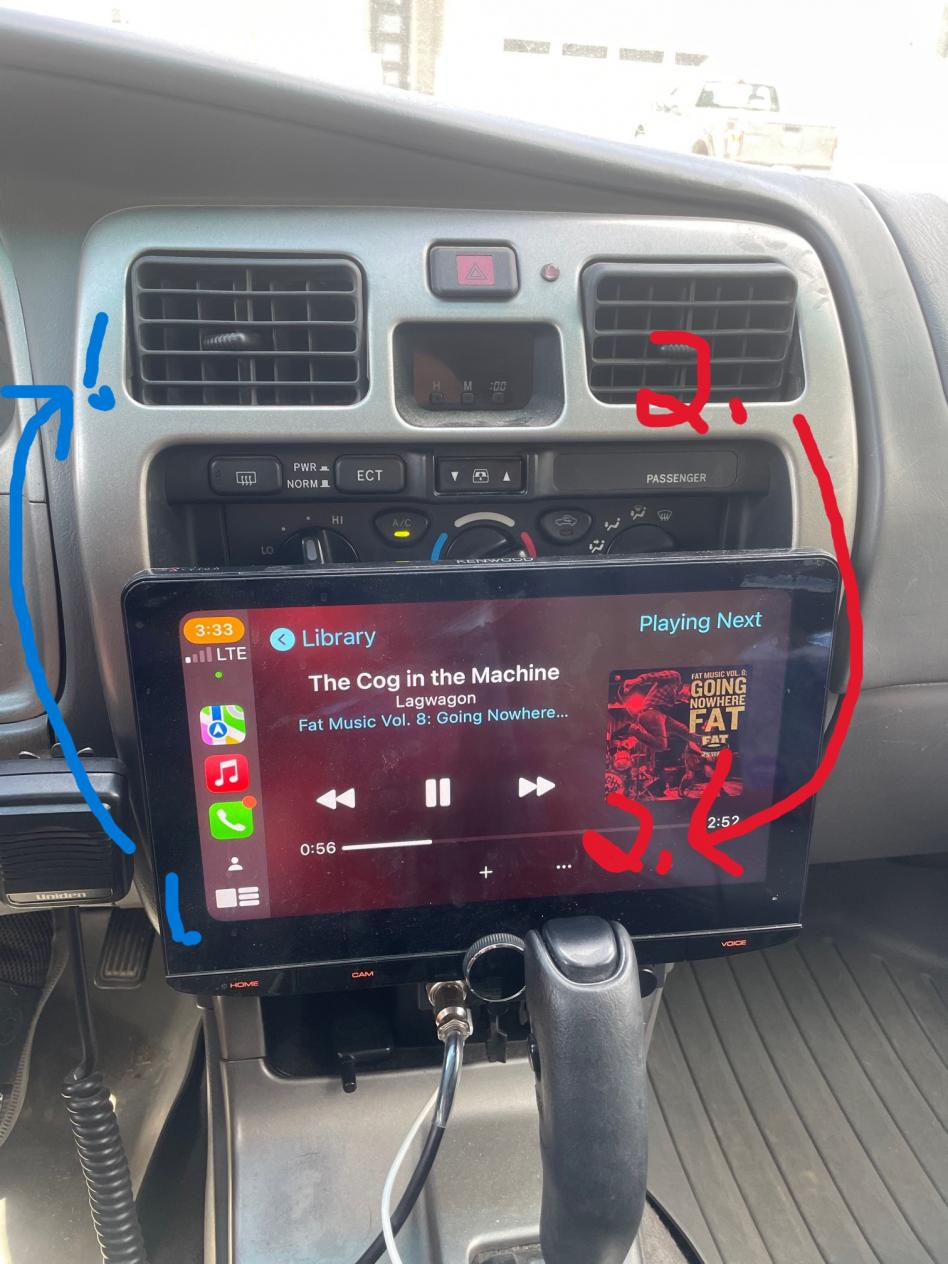

Question about dashboard modification
Hi everyone,
I have a question about modifying my car’s dashboard. I want to swap the positions of my Kenwood entertainment display and the air vents, so that the display is at the top and the vents are at the bottom. You can see what I mean in this picture:
R6E8Uoz
How feasible is this project? What kind of tools and skills would I need? What are some potential challenges or risks that I should be aware of?
I appreciate any advice or suggestions. Thank you!
